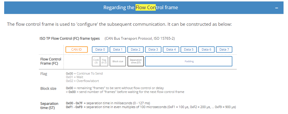

Now, I went to do an update on a VE Series1 SSV radio today, which did an update on the graphics section (Large and slow). The GT failed a few times surprisingly.
So... I had a look at what was going on.. and I kept receicing this flow control message:
644 30 00 00 1E
What makes this unique is that the flow control bytes do actually have meaning as seen by the breakdown below: Looking at the breakdown, 1E actually means wait 30ms between frames sent (Thats a BIG gap!).
Now, the default the GT is setup for is 1.5ms (1500micros) which has been fine for everything that I have dealt with so far. But clearly thats 20times faster then what it wants.
This resulted in the radio missing messages because its too slow. Its a very simple fix, but I have not personally come across this before even when using remote programmers that I use regularly, although the GT is significantly faster then anything else I have used so its able to shoot off messages alot faster then other tools I have dealt with.
