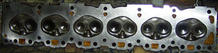

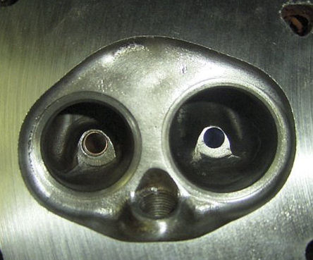

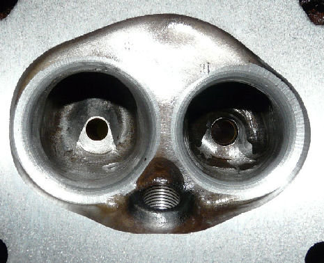

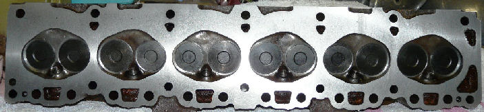

very productive day yesterday, got all the head mods done, only issue now is that with my new cam i need different springs so got to order all that stuff before i can put the head together.
But for now i dug up some old pics of the head and got some comparison photos of how it is now.
so this is how the head was before any changes
and this is how it is now
so inlet valve sizes have gone from 1.6" up to 1.75" and exhaust from 1.4" to 1.55"
you can also seen in this pic below the valve stem areas have a bit of meat left around them
and in this one alot of that has been removed to hopefully make for a smoother area for the air/fuel to flow past
So you can also see in the last picture that the area bewteen the valve and edge of the chamber has been machined, we have taken it out to the edge of the gasket to de-shroud the valve as much as possible, there was probably 2mm on some and a bit less on others, shows up that the casting isn't all even but its pretty damn close really.

Re: My Delcoed Rides
Just a novices observation, are the bigger valves going to suffer from to much shrouding and effectively negating there size increase?.
It is hard to see in the images if there is sufficient space around the edge of the valve to allow flow as soon as it moves of the seat.
i don't think so, what we did to de-shroud them seemed to be about the same distance between the side of the chamber and the valve when compared to a stock port before de-shrouding it so im fairly confident it wont be a bad thing .... add to that the camshaft i'm putting in it is going to have alot more duration and lift so it will make up for it if there is an issue
im going from a .050 duration of 218 degrees to in238/ex248 degrees and lift of .487 to in.517/ex.533 .... and add to all that im going from a hydraulic cam to a solid cam so it should be a reasonable upgrade ... also the head is pretty much on par with a yella terra now, and if anything i reckon more ported than a YT head is from the box!
