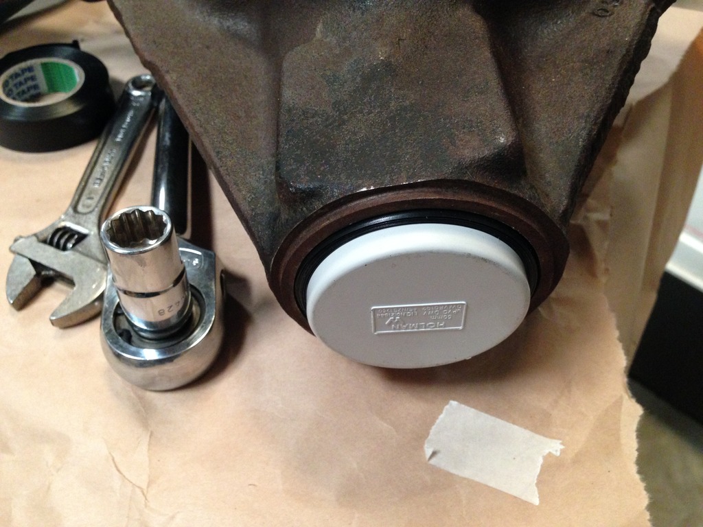

Housing and heap of other bits gone to the blaster. Plugged everything up nice and tight!

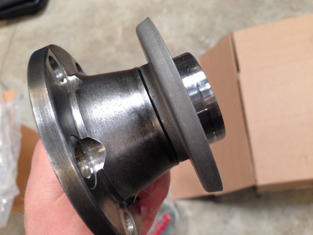

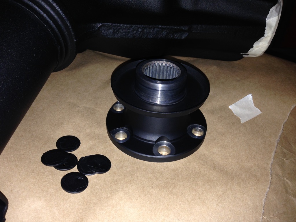

Picked up my diff flange.
only 20 bucks to have that done. :thumbup:

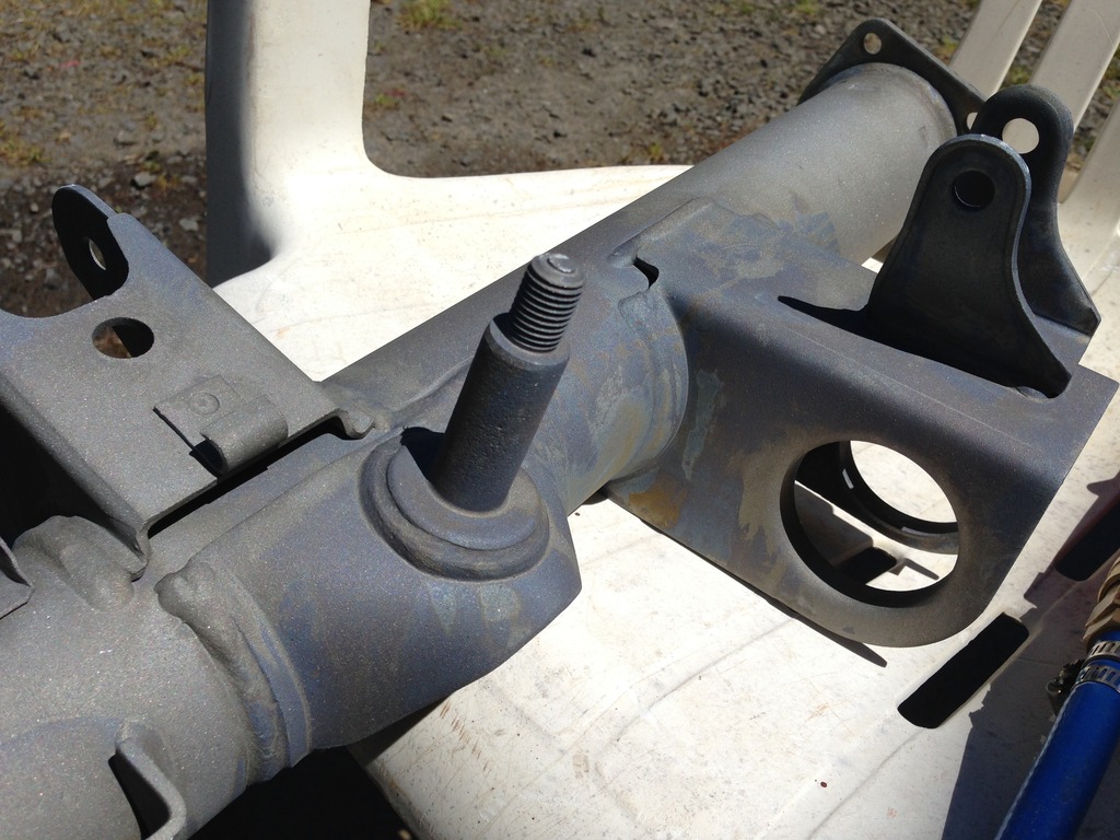

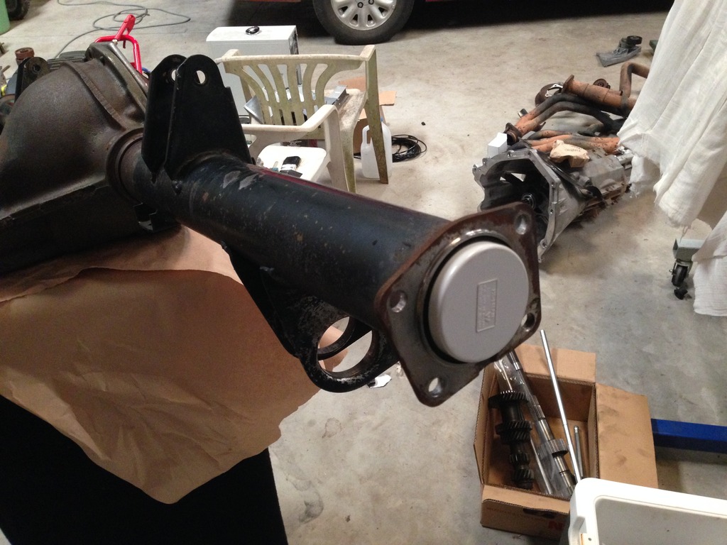

Picked up the stuff from the blaster.
Washed down the housing with the water based degreaser to remove the media and oil/grease contaminants.
Because the degreaser is very alkaline you can see it inhibits flash rust.

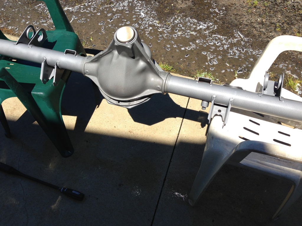

After that was done, I treated it with POR15 metal ready to etch and leave a zinc phosphate coating. Then pressure cleaned it off and neutralized with the degreaser and pressure cleaned again, then finally blow dried.
This is what the ready to prime surface looks like after all treatment processes are done.
Also had some of my Nephews stuff going at the same time. My old pacemakers from the vacationer will see life in the 3rd car.

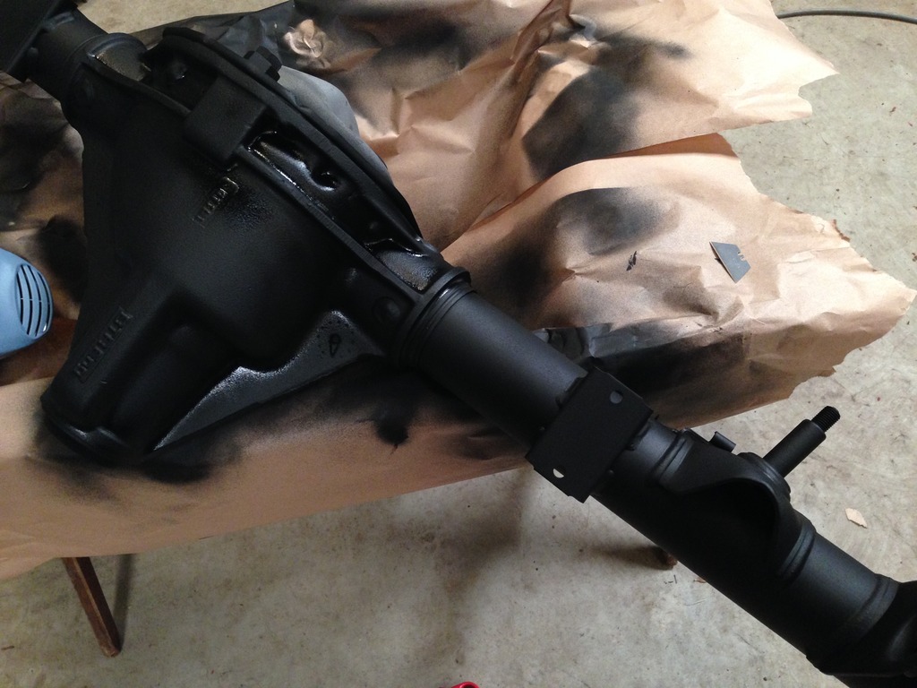

Housing in primer. Later pulled all the plugs out and the cover and was pleasantly surprised to find no abrasive or water :thumbup:

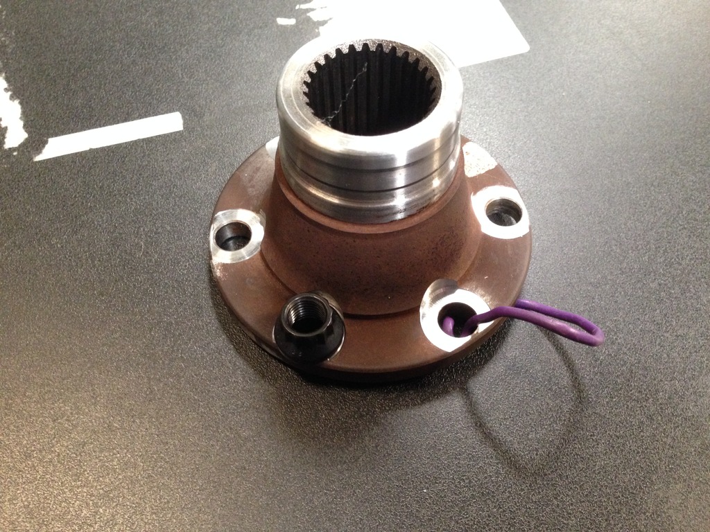

These are prone to not sitting tight on the flange so I peened the lip over slightly and epoxied the bastard on lol
Good o'l JB weld!
Done! And everything is ready for the center and gears to be installed. Dropping it off next Friday and when I get it back the rest is in my hands.
Once completed minus axles it will get a final rub down, re-prime and coat of epoxy gloss black. The very old same I have been using for years with great results.

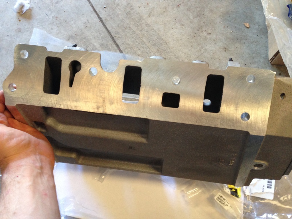

On a different subject I got this a couple of weeks ago from GM.
L32 lower intake. I didn't realize how much better the ports were on these over our ecotec LIM, and plenty of meat for porting to boot unlike the ecotec LIMs.
The ports are rectangular unlike our weird ones that narrow down at the bottom. Overall they are a bit bigger.
Inlet side is a LOT bigger than ecotec. I mean like 2x + the port area at the head. Has a nice radius too.
better ports + PSI = win :)
Damn straight!

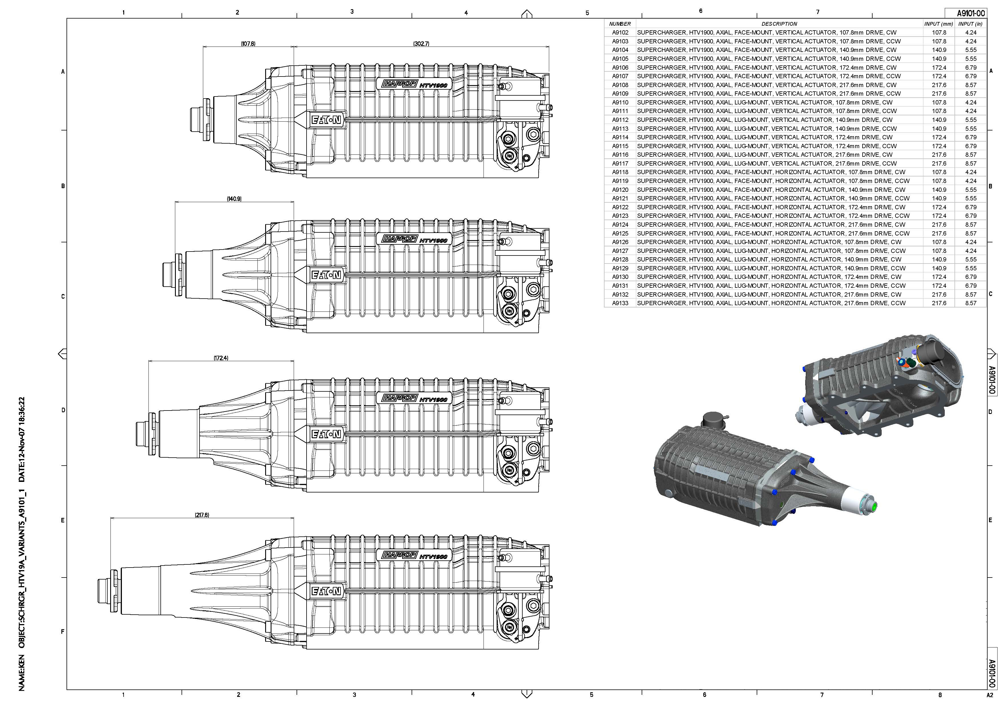

Eaton/Harrop HTV1900 anyone?
