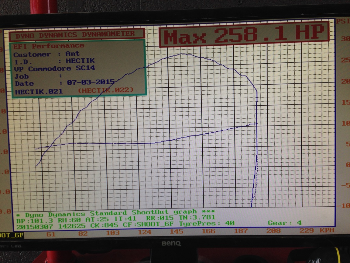

Got it running nice and smooth on the dyno on Saturday with the help of a very knowledgeable friend (not sure he wants to be named), although, the day didn't go without problems. A shout out to Dyno Hire Services. They provided the dyno at a very reasonable price and were very accommodating and helpful.
We didn't make much more power but lowdown torque is up and the car is a pleasure to drive with power on tap.
Graph-
You can see the boost creeping up in the top end, I think this is down to the engine not being able to breath it at those revs. I think some head work and a cam should help with this, but at current power levels the SC14 seems to be able to keep up with demand.

Re: Sc14 to buick and e85
its interesting that its making so little boost down low then increases in the top end, I certainly would have expected to see more down low with the smaller pulley you have!
either way a good result!
I can certainly relate to the countless dollars on the dyno with often not much result, but you get to nut out all the issues so that's a clear bonus!
just out of interest I assume you are tuning it on E85 but using petrol AFR ratios ? .... that's all I can make out from the log ?
looks like 46 degrees inlet temps is all happy :)

Holden202T wrote:its interesting that its making so little boost down low then increases in the top end, I certainly would have expected to see more down low with the smaller pulley you have!
Talking to the L67 gurus, with a PD blower, boost is a measure of restriction, ie. the more boost, the more restriction. I guess looking at that graph, and the fact that it's on a stock cam and heads, it would make sense that it breathes better down low in the rev range. A more suitable cam and some head work, in that case should help. That's providing there's not some other problem that I don't know about yet. Theoretically, you shouldn't run out of boost at higher rpm's with a PD blower, more of problem would be the parasitic drag, especially with the SC14 as the lobes on the rotor are straight. Coming from turbo cars, there has been a lot I have had to relearn.

yeah im certainly no expert with blowers, but have done boost turbo stuff, so it is certainly different, mines more like takes time to build boost, then flat lines full boost till redline .....
I guess im more surprised the SC14 doesn't make more down lower then peak and then drop off as rpm rises ... would be very interested to see the torque curve, that's the big thing!

Yeah, I didn't get a printout of the torque curve. But it is much the same as the boost only opposite. :LOL It Starts higher goes flat for a long way then drops off in much the same manner as the boost curve builds. lend more to the the theory that the boost is only showing you how much restriction there is. remember a PD blower's air output is linear, one rev produces x air and the engine consumes y air per rev. A turbos boost is controlled by the waste gate/boost control circuit so, once spinning fast enough will feed as much air as is required to maintain the boost set by your boost control circuit. Anyway that's how I understand it.
