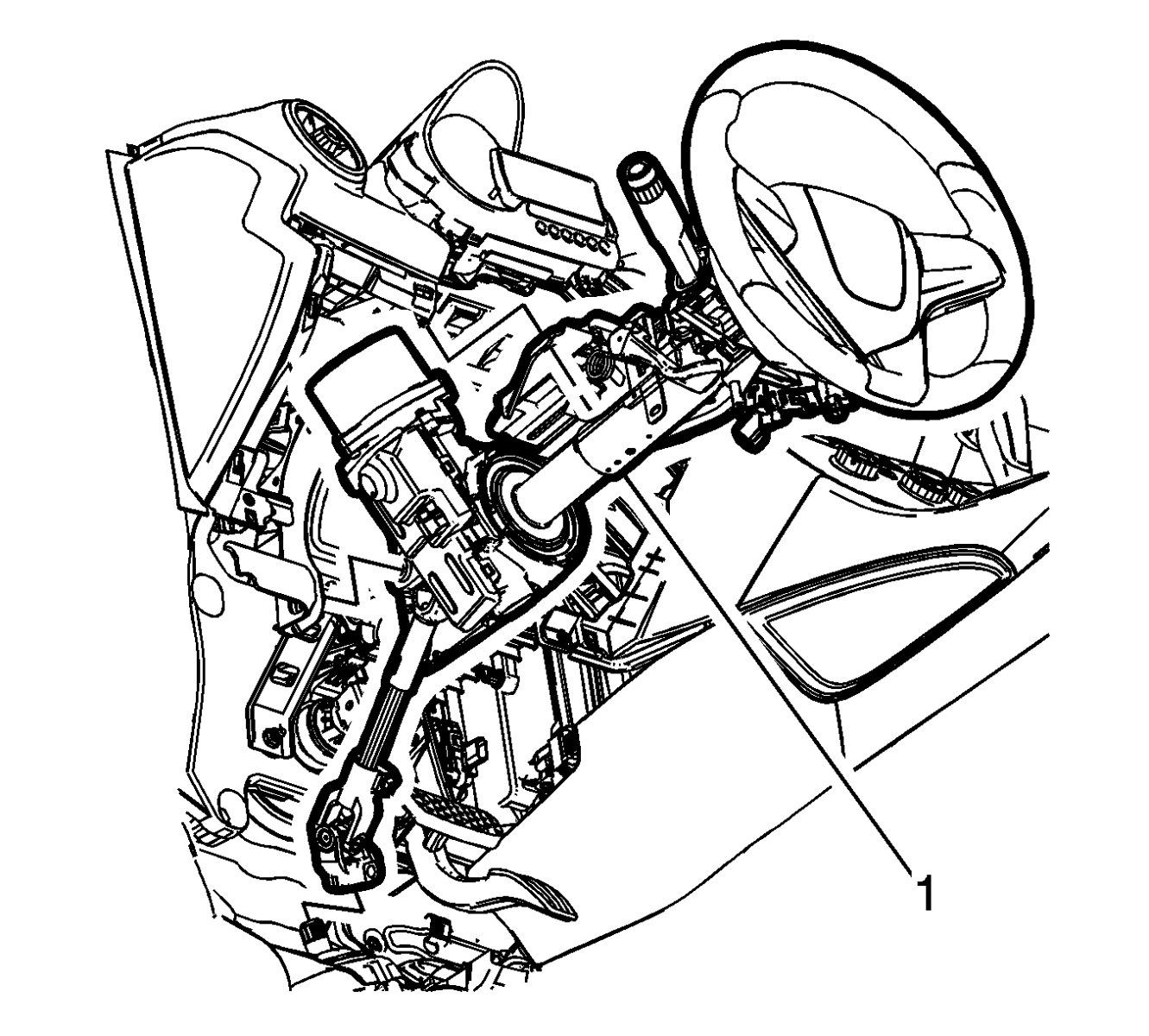

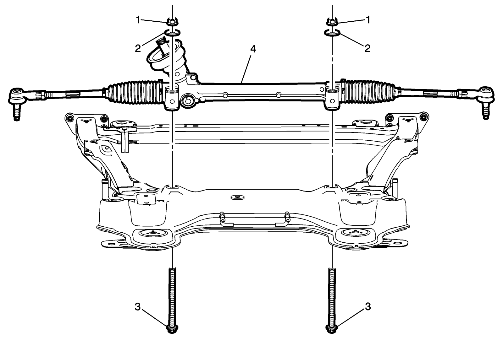

Re: How to loose 200kgs?....
Thanks for that monaro, but that is exactly what I have in the photos at the top of the previous page :thumbup: and what will be fitted to the car
Posts: 3364
cars: VR Commodore V8
Post by Dylan »
That rack even looks like an old commodore one. I wonder what the mounting centres are?

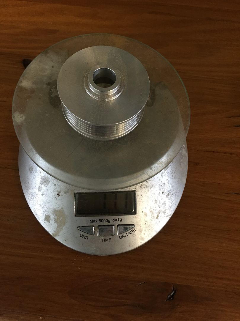

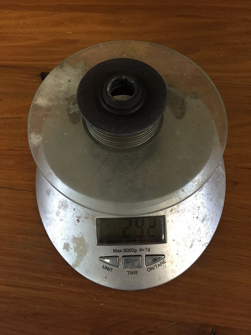

Got rid of a little more parasitic loss :D

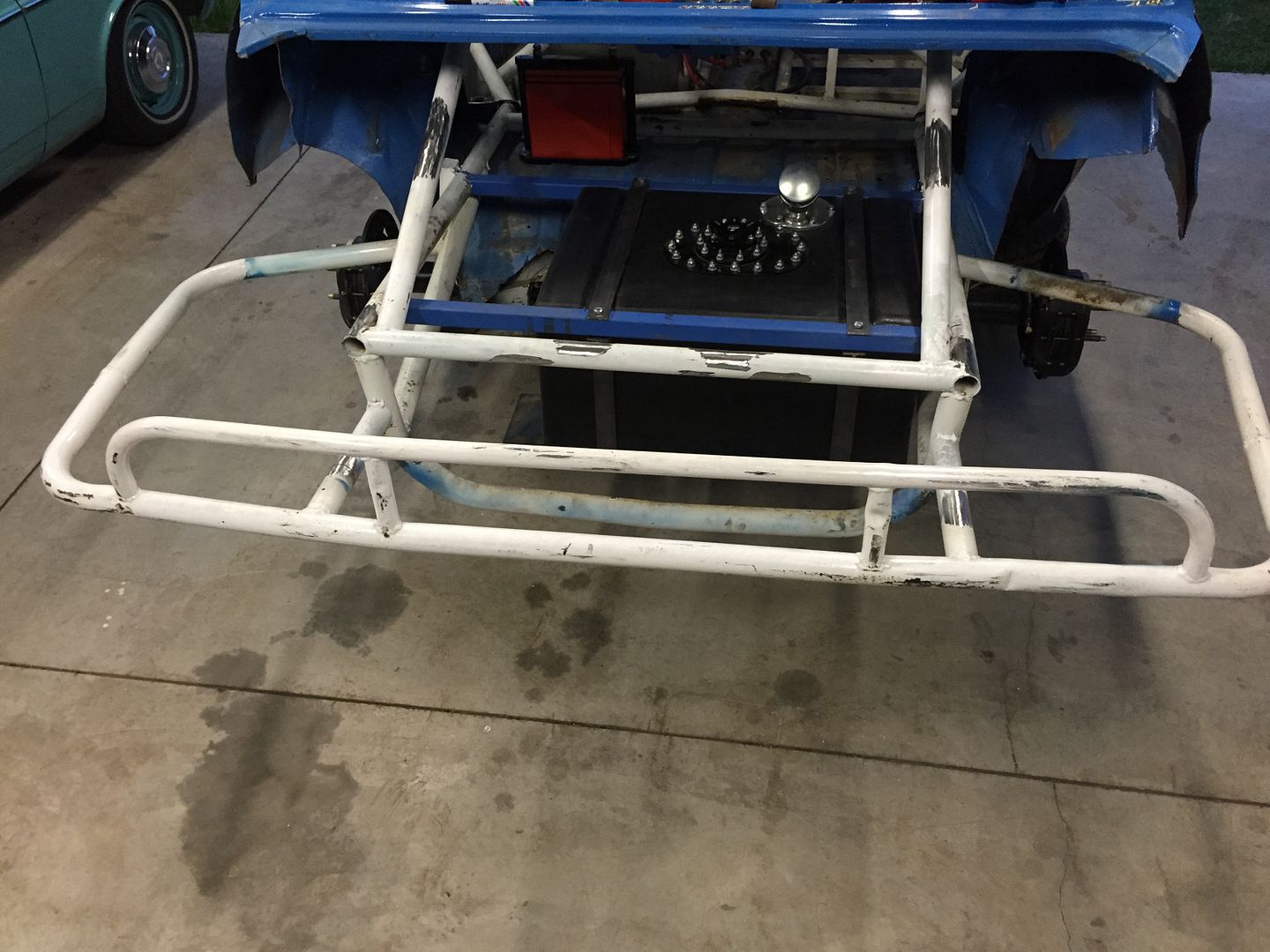

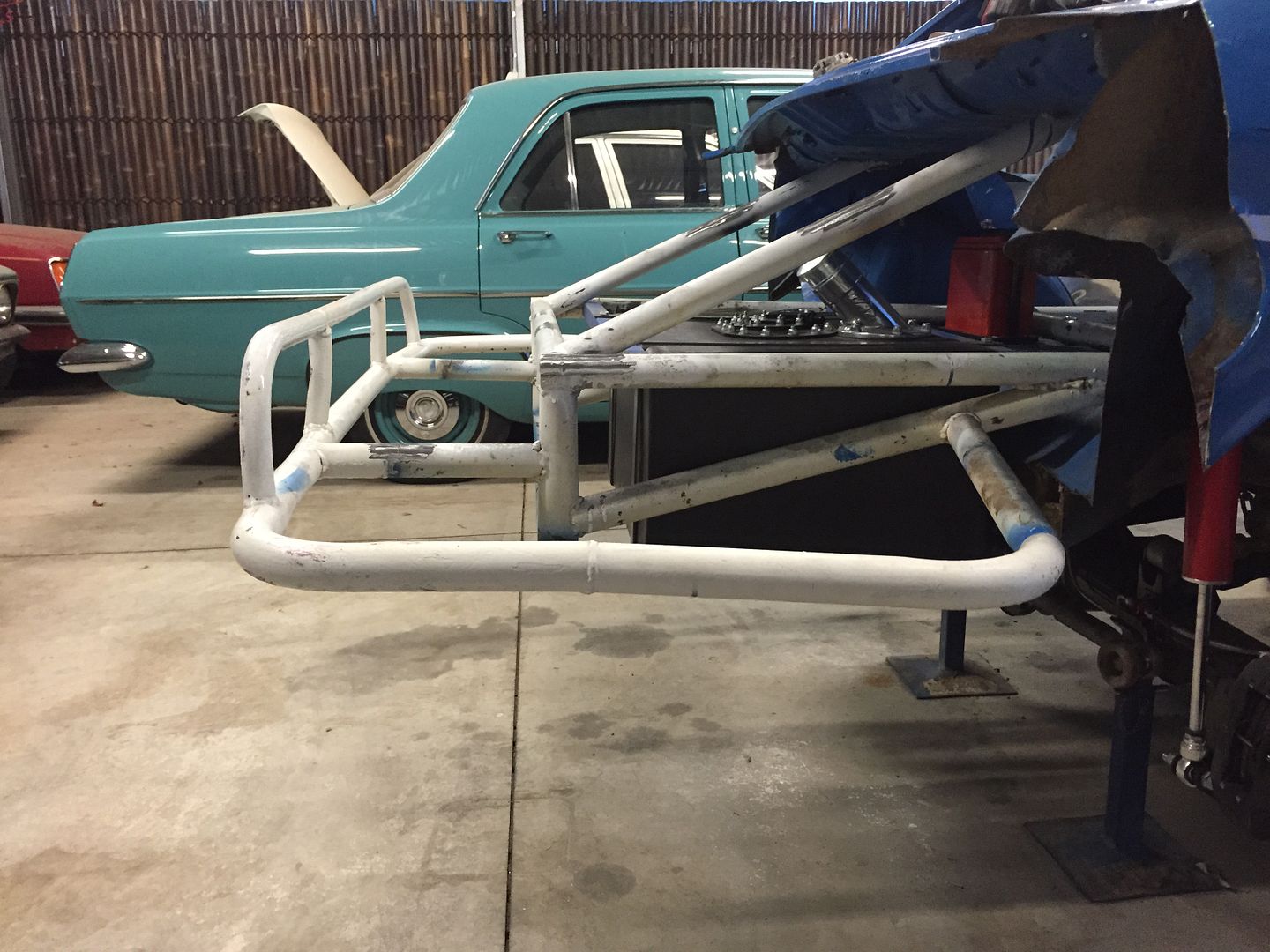

And got the fuel tank mounted, I'm very happy with how that turned out, it will have multiple mounting holes so as it can be moved side to side to aid in chassis set up

I hope you got the 20% over driven one.

Yeah it sure is the bigger pulley, from clarko's performance :thumbup:
