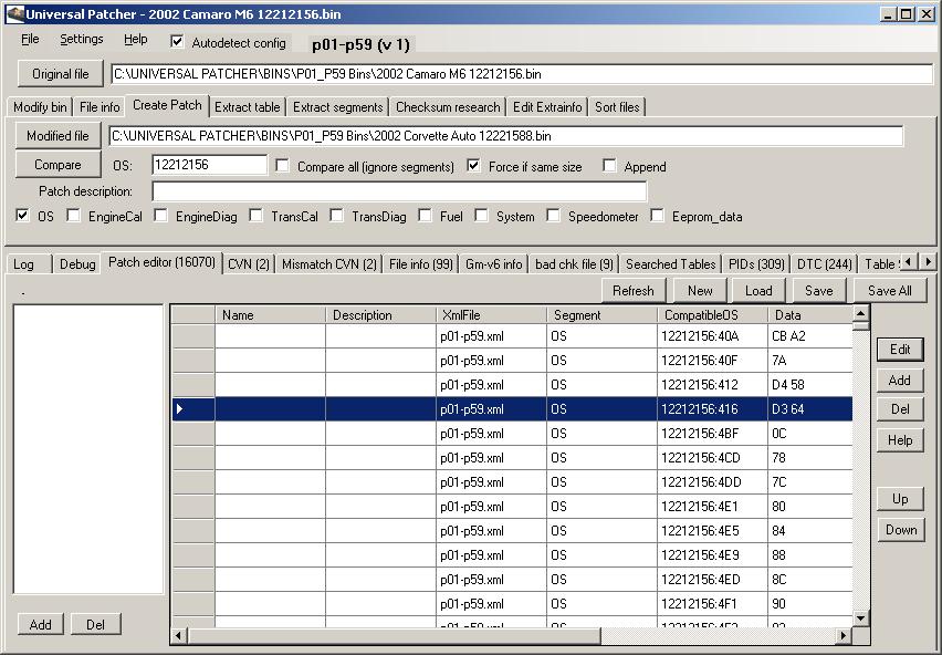

There was an issue with current config and checksum dll, using hardcoded end of OS. Now the dll is configured to read the end address from bin file. And there is updated xml checksum config for Universal Patcher[attached]. It needs to go to xml folder overwriting older version.
Creating patch is just as easy as comparing 2 files. Open original file[base] and modified file[patched]
->check force if same size if OS numbers differ, and mark only OS.
->click compare
->go to patch editor tab and click save
If saved in patch folder the patch will get loaded and be ready to apply when a bin matching the OS is loaded.
You can also create manually patch, add rules, searchable rules and so on.
When we have a good definition done for the boost OS[an xdf with boost tables only will be enough], a table patch can be made with preconfigured tables data.

Re: LS1 Boost OS - Development
Ok, I'll have to update my file. Thanks!kur4o wrote:There was an issue with current config and checksum dll, using hardcoded end of OS. Now the dll is configured to read the end address from bin file. And there is updated xml checksum config for Universal Patcher[attached]. It needs to go to xml folder overwriting older version.
After thinking about it I really don't want to program a patching tool, so I'll have to play with this more.kur4o wrote: Creating patch is just as easy as comparing 2 files.Open original file[base] and modified file[patched]

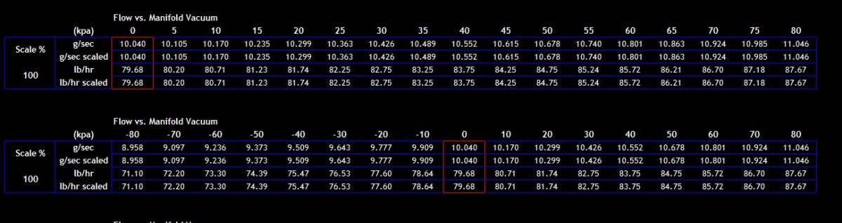

Please forgive me if this has been discussed before, but would it be possible to extend the Injector Flow Rate table to boost areas? I know that up to know people have been compensating by either adding more fuel or using a boost referenced regulator, but I think it would be pretty neat to give the PCM accurate injector data while in boost. I don;t think one would need to increase the table size, just change the values that are referenced. Please take a look at the attached injector data, I took this from the ID725 spreadsheet. The top table is what the P59 currently has and the bottom table is what I'm talking about changing it into. I'm not sure what OS or ECM uses the lower table.
0 kPa is atmospheric pressure, positive kPa is vacuum and negative kPa is boost. The lower table would max out around 12 psi in boost. Maybe the two halves can be scaled differently so the boost side could include more columns than the vacuum side?
