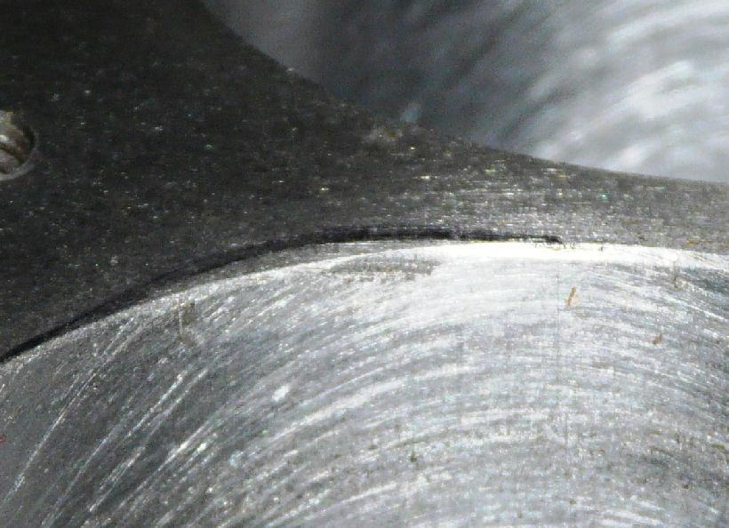

heres the mark from the exhaust valve, compared to the inlet, only just hitting

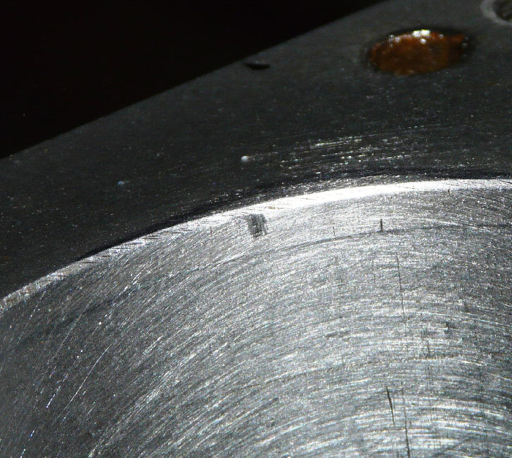

and the inlet as you can see has left more of a mark

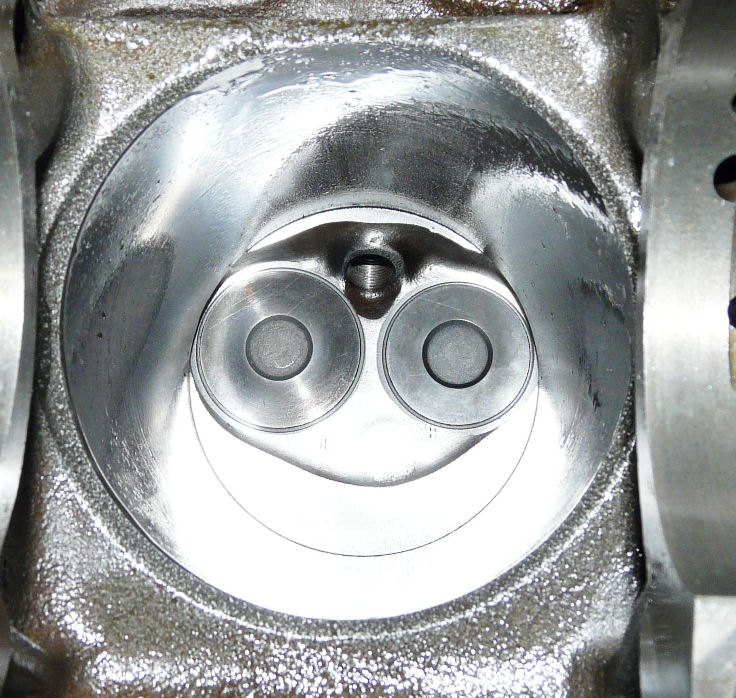

and this is the view from the bottom of the block looking down at the head .....
judging by the depth of the marks it should be no problems to relieve the block well before the top ring area.

Re: My Delcoed Rides
Not much in it ,about half a bees dick.
Do you think you might be able to turn/machine the valve head down 10 thou instead maybe .
