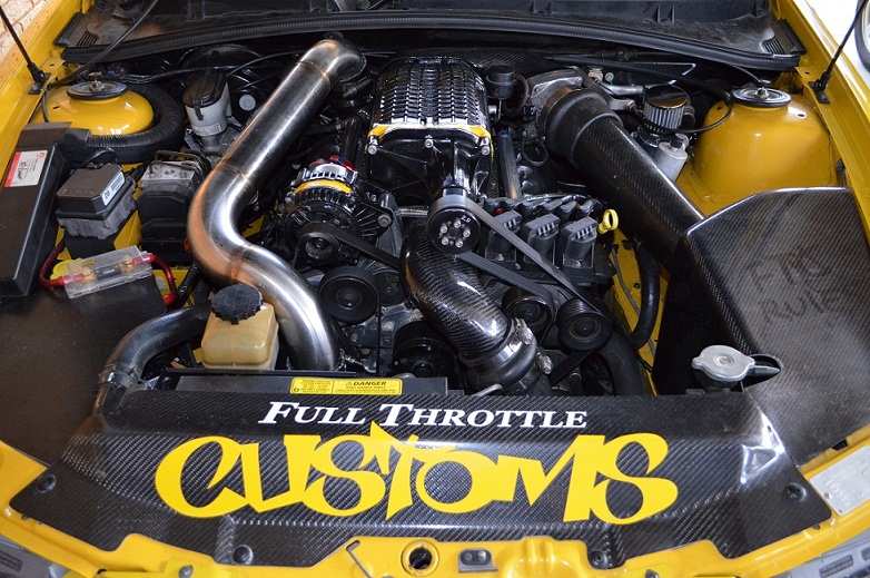

Had you seen this build before Vlad ?vlad01 wrote:Damn straight!
Eaton/Harrop HTV1900 anyone?
Running it through a hybrid A2A/W2A intercooler set up. Using a 85mm pulley was still giving it 14 psi, but a larger pulley was not an option as even with k-Frame spacers & Tuff mounts it was rubbing the bonnet.
Cheers
- mangnaro%20dirty%20engine%20bay%20mini.jpg (254.87 KiB) Viewed 3309 times
sounds like group A scoop time ??OZ38 wrote:... but a larger pulley was not an option as even with k-Frame spacers & Tuff mounts it was rubbing the bonnet.

yeah I contacted harrop and they already have an adapter plate for non intercooler setup but still leaves the pulley at 85mm dia close.
I want to have theirs or my own design with the charger sunk into the plate so its only 10mm + gasket above the LIM giving about 25mm clearance to the bonnet insulation mat with 85mm pulley (biggest off the shelf harrop pulley) so more clearance as you go smaller.
Don't need intercooling with E85 and moderate boost.
