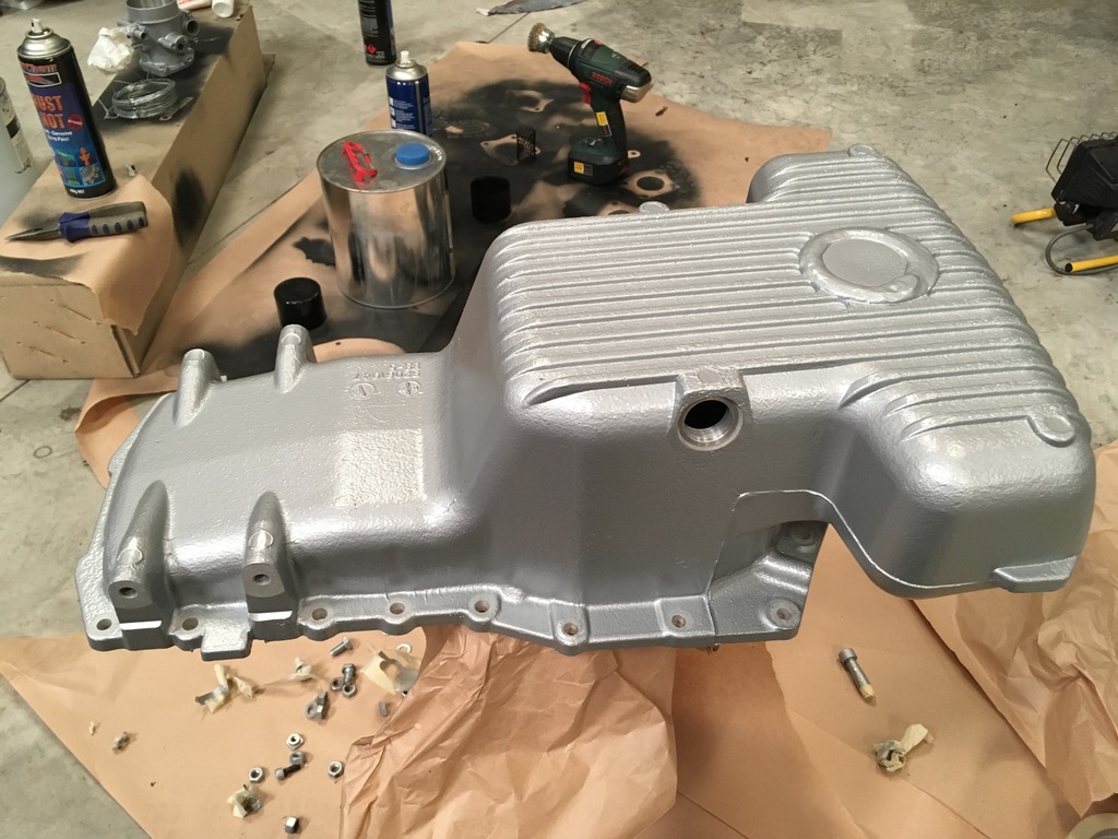

Picked up the sump, prep'd it along with the TB.
The usual chemical cleaning and treatments etc...
Masked and painted :thumbup:
Thats all the painting for this year. So all that I'll be doing over the break is finishing off the engine cradle, mating up the box and engine after I fit the sump.
