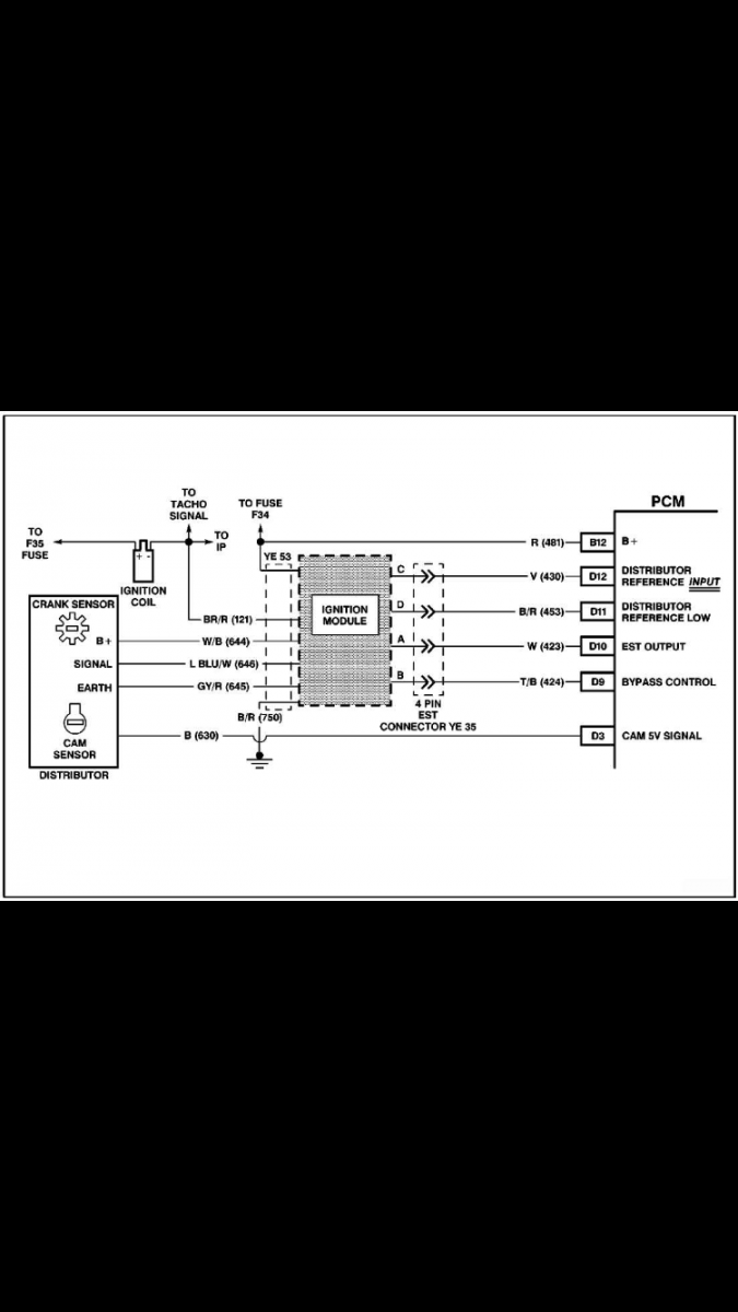

Can anyone confirm that this is actually the wiring diagram for a 4 wire vt distributor?

That looks correct.
This is from the factory service manual.
5b.pdf
(379.33 KiB) Downloaded 504 times

Any one got a wiring diagram for how to wire this into my car? Vr with vs manual loom ls1 coils and the vt distributor?

There won't be anything to suit, will need to work it out around the wiring for the new ignition module.
Re: Programmable Delco Ignition Module
Wire it up something like this....
