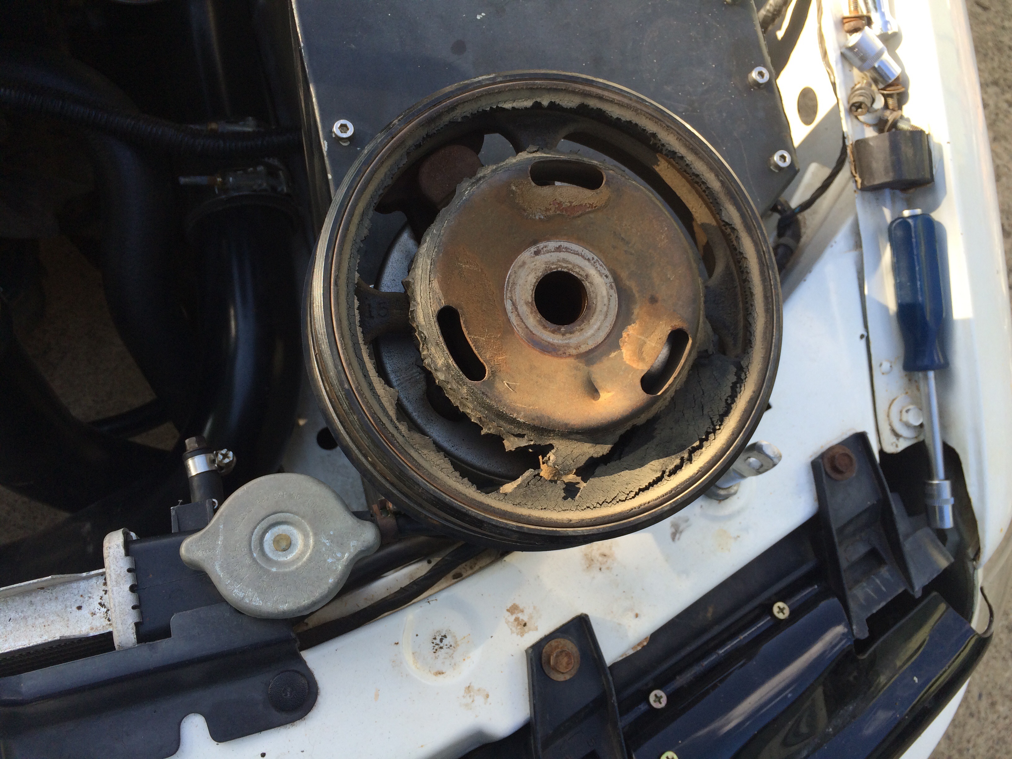

Pretty successful weekend at Gatton Street sprints, although we suffered a couple of failures on the Saturday. After the second runs, we had a failure of en engine mount, but pushed on and by the end of running on saturday had a major Harmonic balancer failure. Baz, the other driver was 2nd in class and I was 4th at this stage. We were unable to source another balancer sat night to sunday morning. We decided to have baz try complete his 75% runs on sunday to hopefully hold onto his second placed time and we were successful.

Re: Sc14 to buick and e85
[attachment=0]image.jpg[/attachment][attachment=0]image.jpg[/attachment]
Had its day is my best guess.
lol, yeah fairly conclusive that!

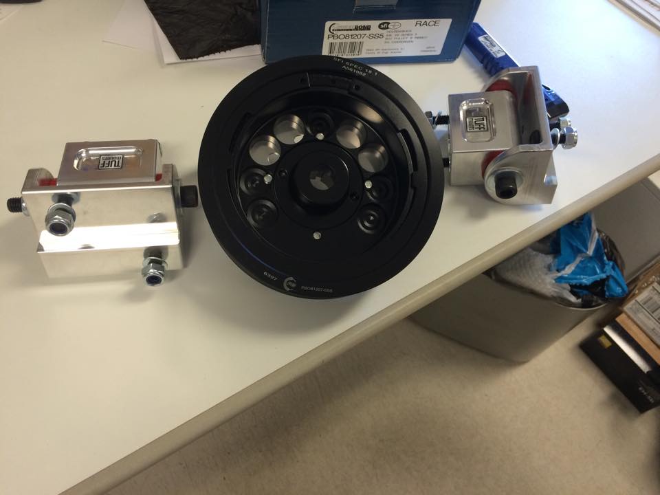

The remedy-
