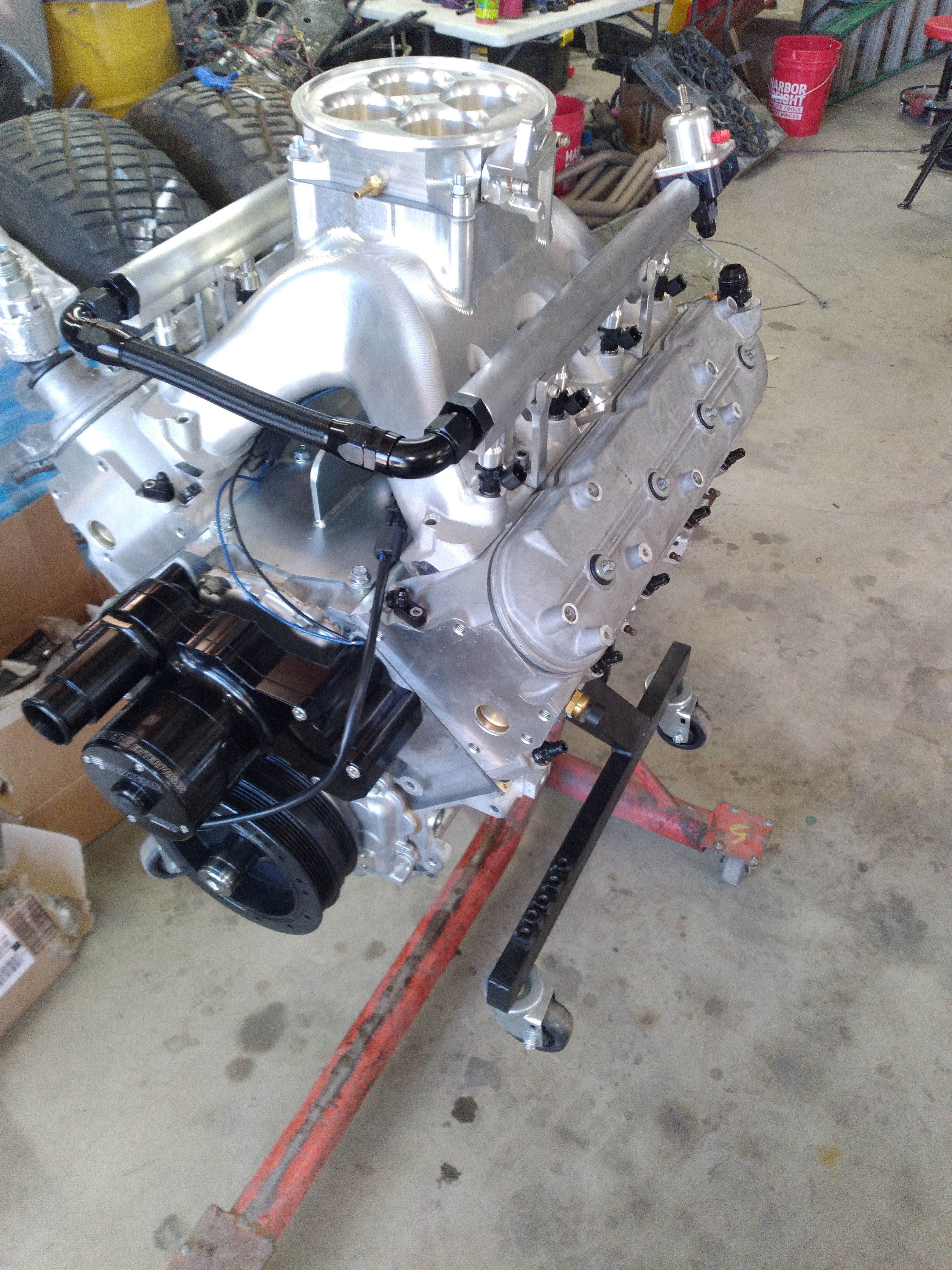

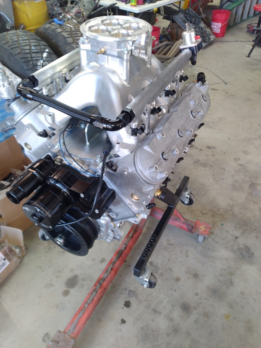

Fuel dampen has and will always be an issue. If you want your gauge to be a little more stable, use a restriction jet before the gauge.
Fuel rails are a bit tougher. Always use as large a rail as you can. If you can fit dampers, use them. Otherwise, as large as you can and regulate at the end.
Here's some -12 rails, dual pumps, Y adapter with check valves(redundancy thing, one pump at a time), big fuel lines over 12ft each to the rail and then back to the tank, then return after the bypass regulator and still a -8 bypass. Sorry, the pic shows the regulator at the end of the return rail. I moved it to the rear of the truck next to the tank.
