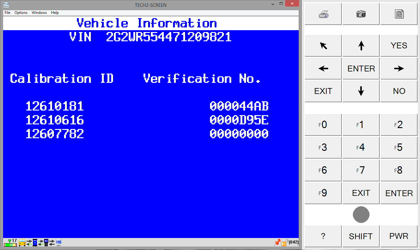

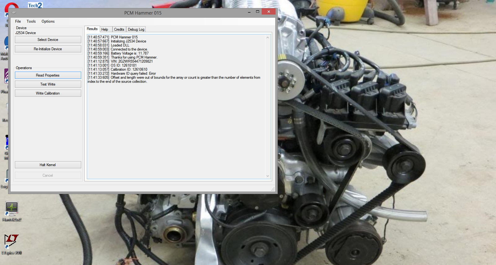

For shiggles, i hammered "Read Properties" on my 07 Grand Prix. Wiring systems are still pure Class 2, Tech2Win comms only over DLC Pin 2. Screenshots of results below, both Tech2Win and PCM Hammer 015 going through the VXDIAG tool. Was able to pull OSID, fail at HWID.
interestingly, Tech2Win shows 3 rows of 8-digit CalID numbers on this PCM, along with 3 rows of 8-digit "Verification No." that seem to be hex values. Top CalID line matches "Read Properties" OSID line, #12610181. Where it gets weird, middle CalID row matches up until the 8th-digit, '0616 on Tech2 vs '0610 on PCM Hammer 015. Any insight as to what the 3 CalID rows represent? On a 2001 L67 P04, Tech2Win shows me only one CalID.

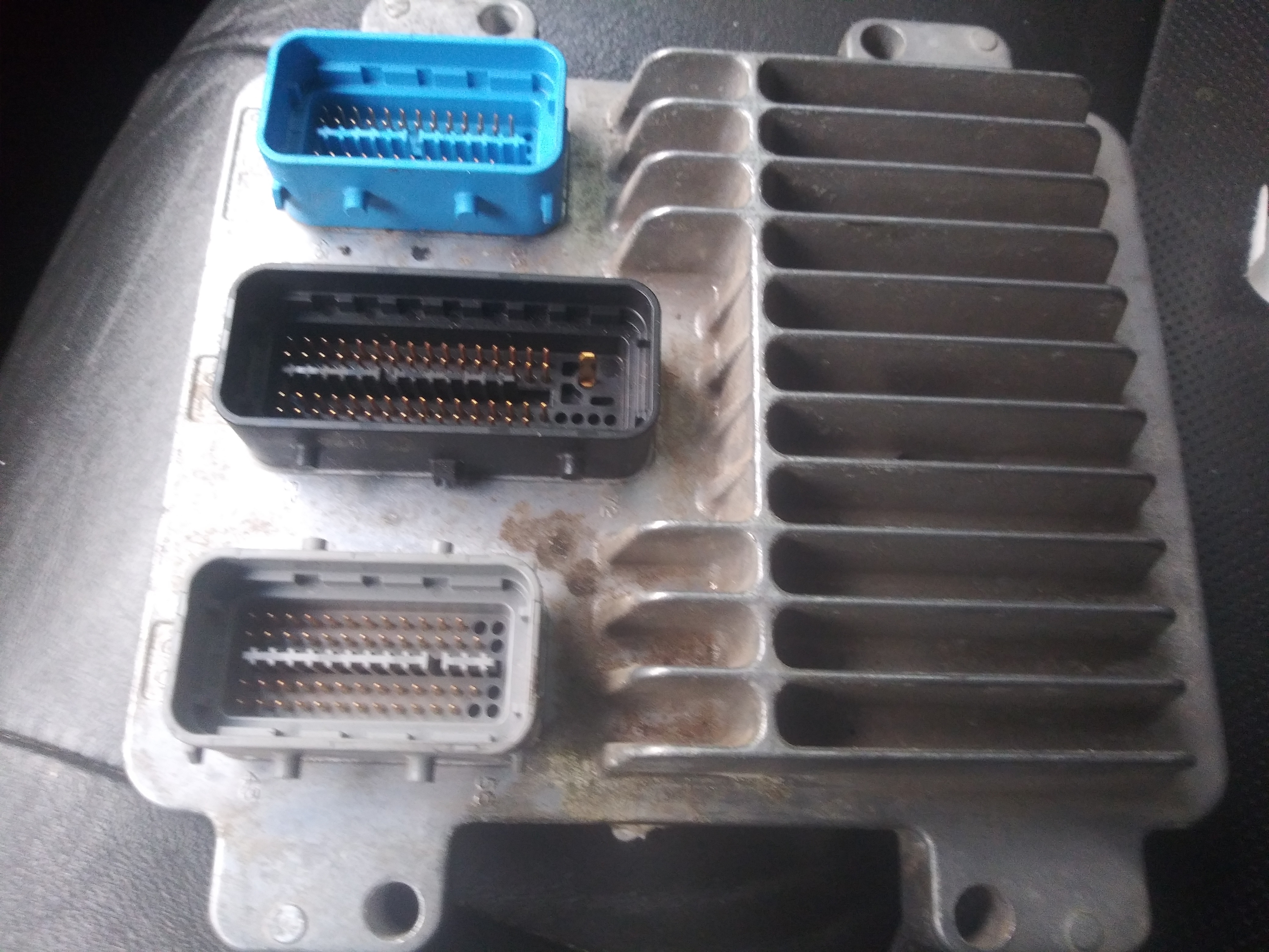

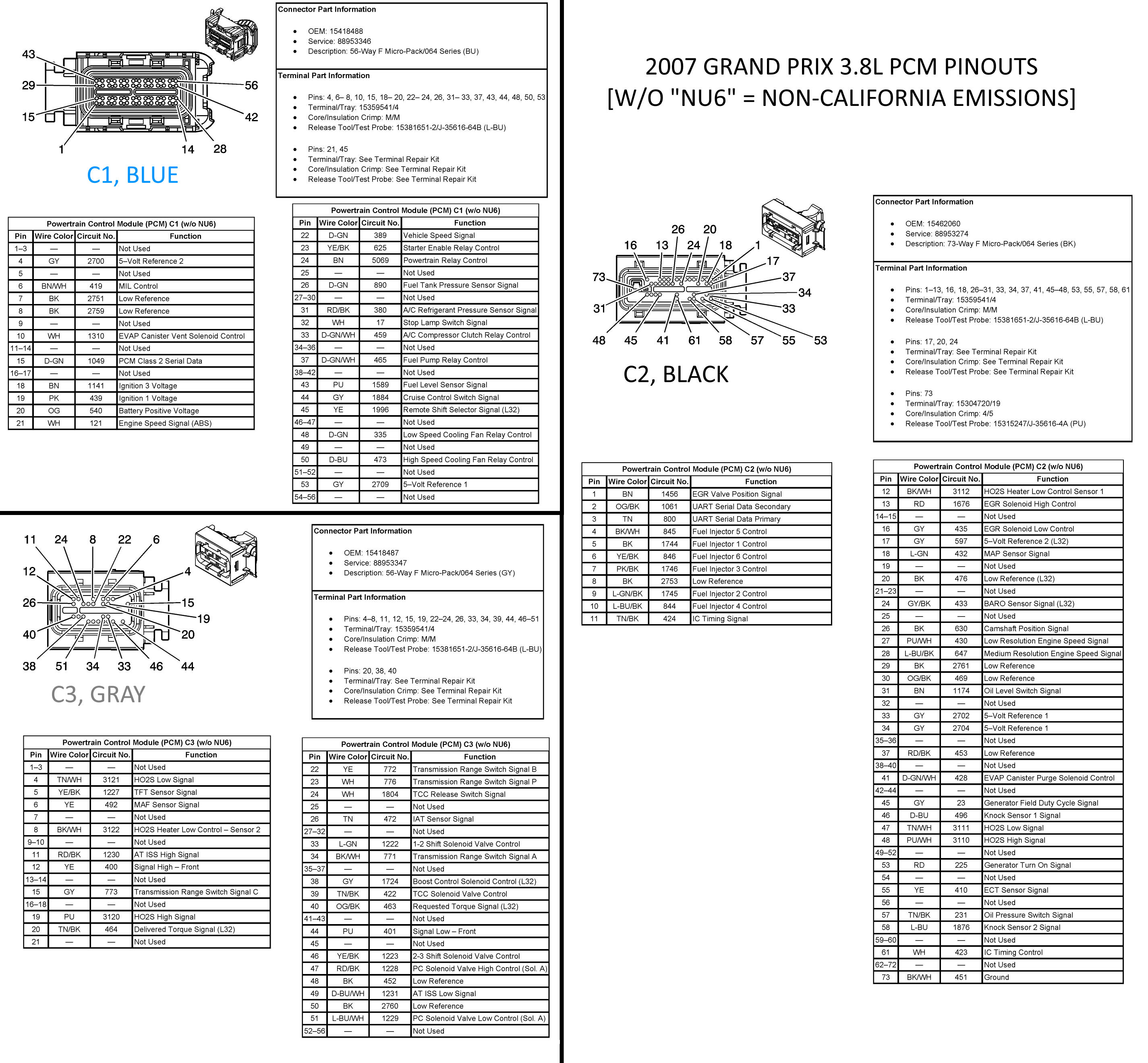

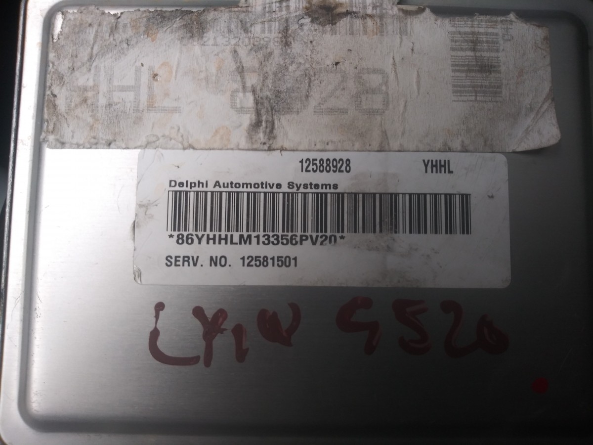

in the next few days i'll gather Delphi barcode label pics of the P04 and 2x P05's i've got on hand. i also have diagram/pinout/service info/description & operation access for 2001 Pont W L36/L67, and 2007 Pont W L26/L32 3.8L if any of that is of interest, like PCM pinouts.

P05 pulled from a 2004 L32 application for reference
