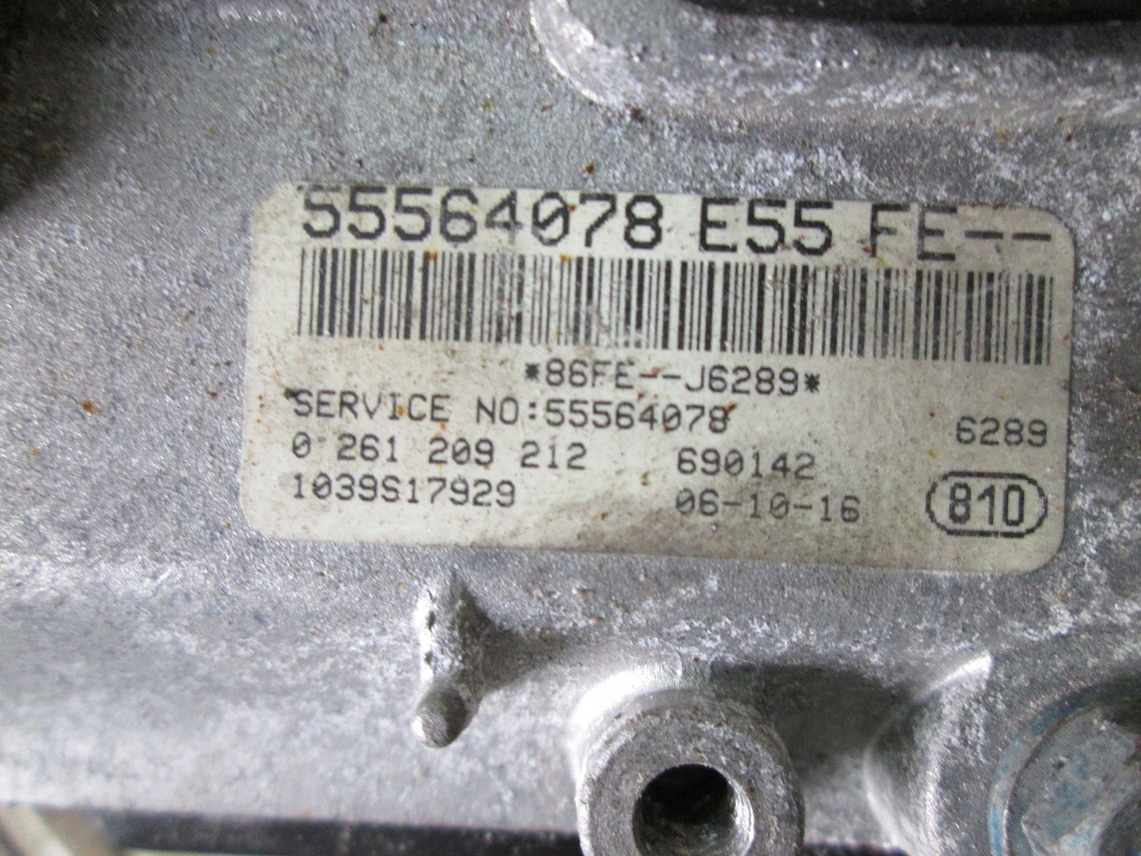

Will this brute-force tool
also work for an Opel Vectra OPC (Z28NET Engine) ECU? I believe it's also compatible with the E55 ECU.
I have several tools available (AutoTuner, K-Tag) but none of them can perform a Full Read
I purchased a donor ECU, because the previous one died
. I only need the PIN, and I can unlink it using OP-COM. Its an Bosch ME9,6
