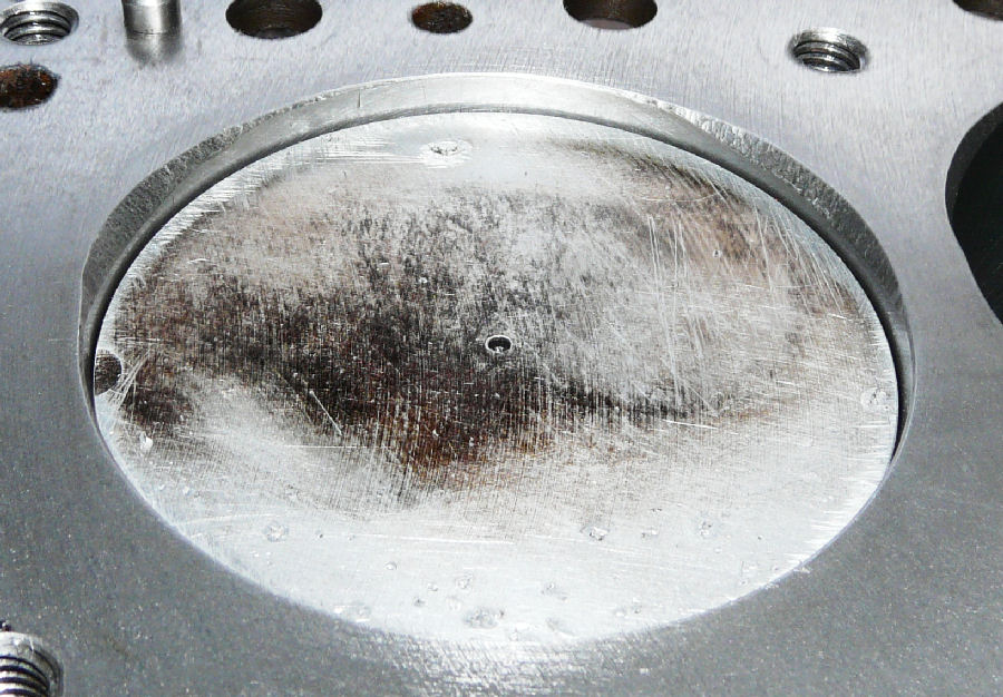

got the bottom end back together this arvo, everything seems to be ok, theres a good few mm between where i've die grinded and where the top ring is so im happy with that, below picture shows just how much i have removed, i really only needed to remove a small area, but i went further to make it into a nice flowing bit, and also this will help air flow around the edge of the valve into the bore.
the bit die grinded out actually go to the edge of the head gasket, i'm not really sure why the head gaskets are made that shape but you get that!
so now i just have to wait for a week or two before my head stud kit arrives, then i'll be able to get the head on!
