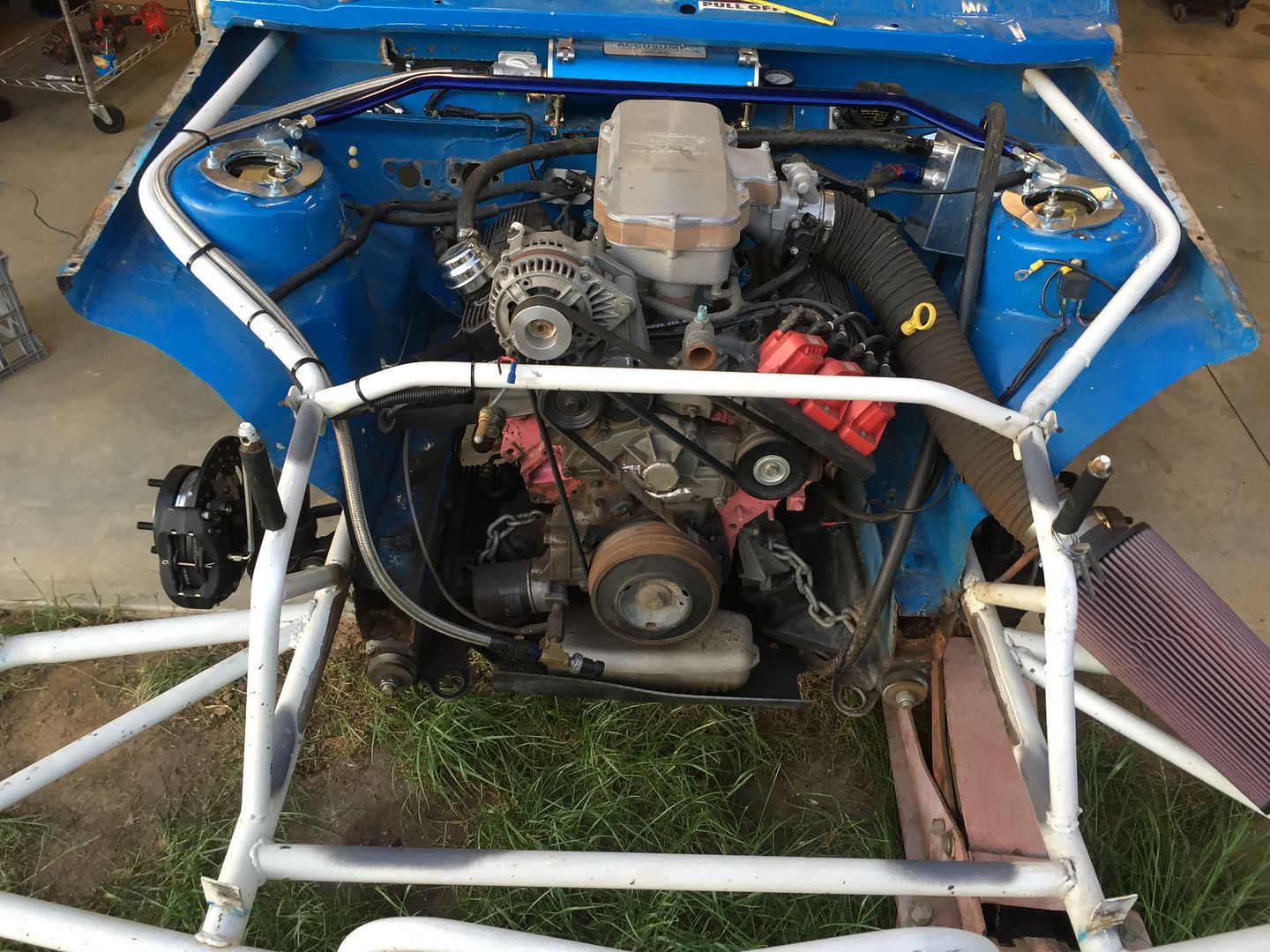

steering looks like it fits in nicely
keen to see what you think of electric steering after the first event!

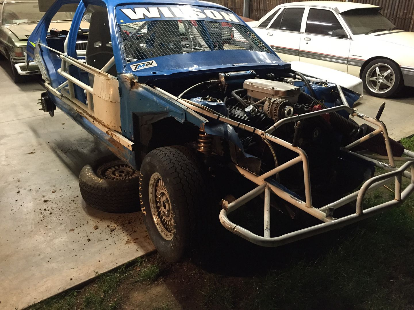

How about now...When does it stop being a commodore and become an engine with a seat?

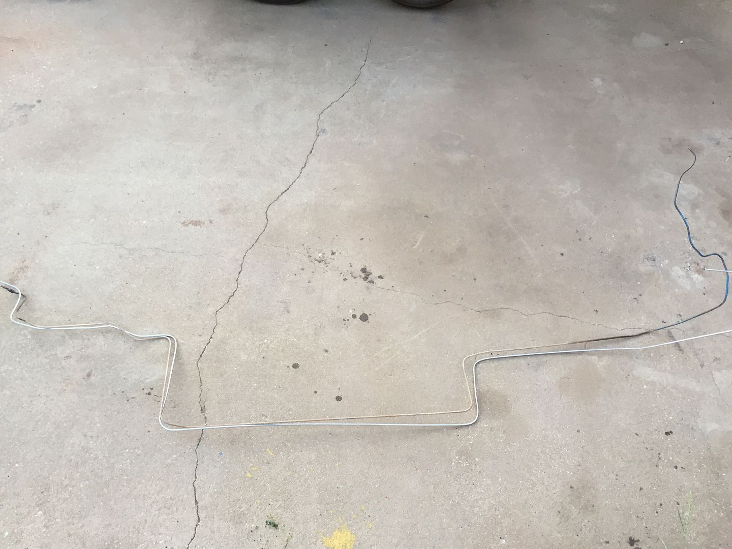

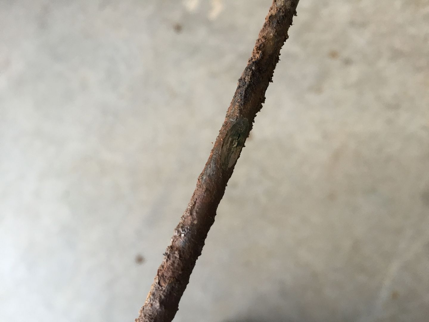

So it's been a little while, got the brakes and clutch plumbing done tonight. Was going to use the original rear line and this is what I found in about the middle of the car...
So made a new line

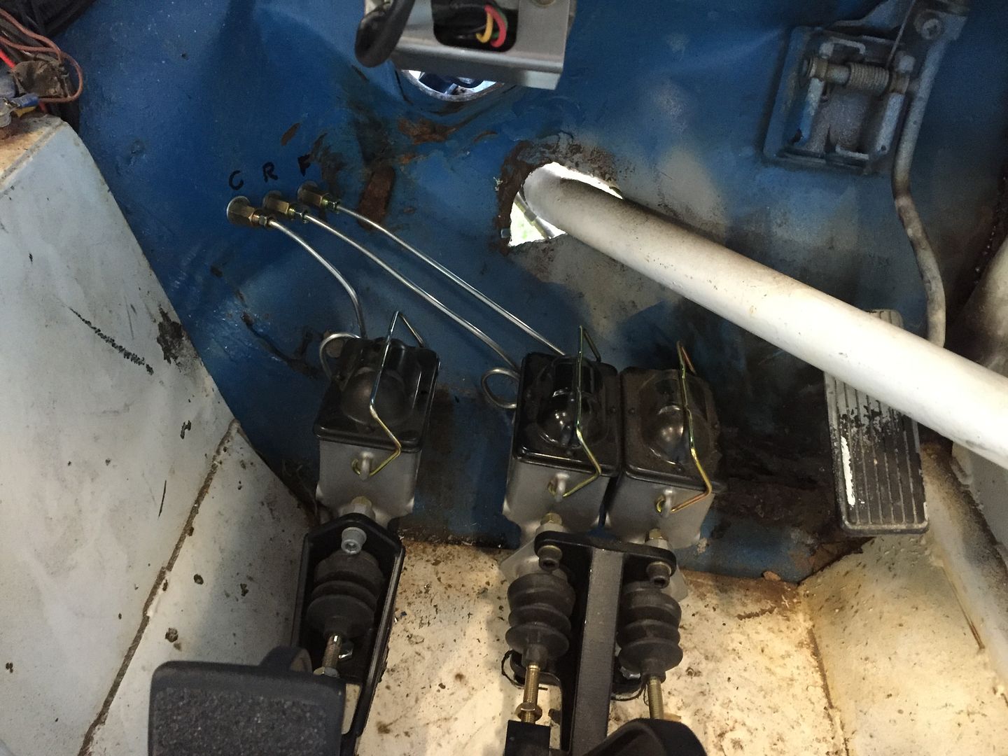

Inside... Used bulkhead connectors to get through the fire wall

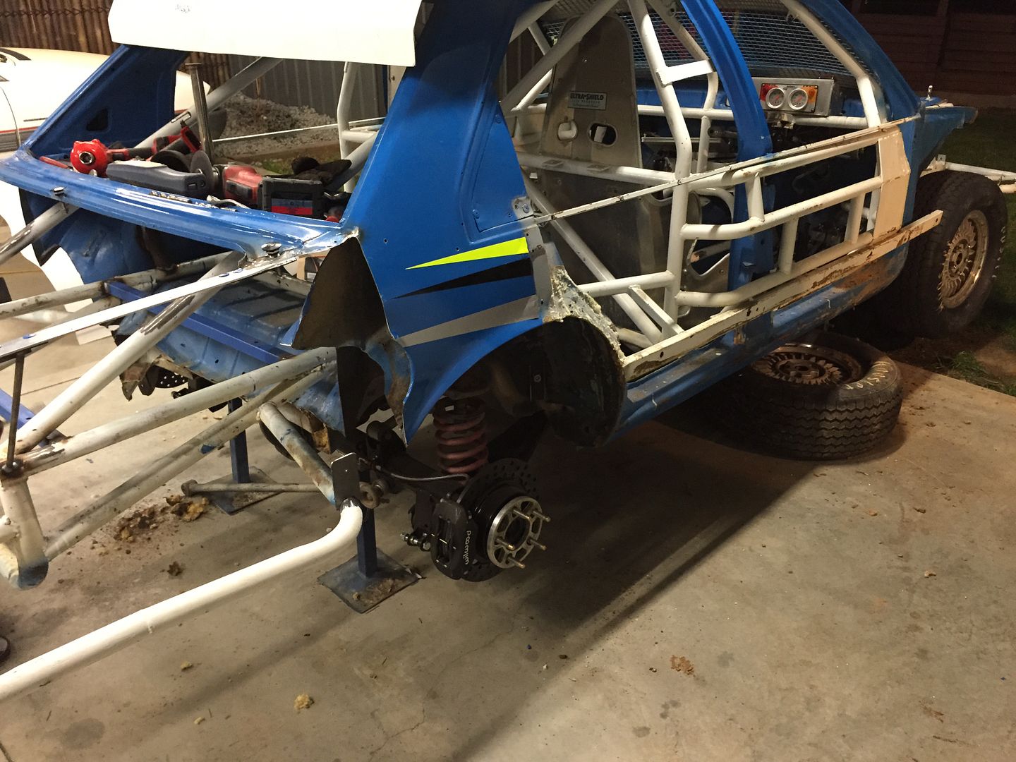

You can see the new strut brace and how much is now missing from the chassis rails now... About 5kgs worth of rail!!!

So made a new line

Holy crap that is weird to look at with all that sheet metal missing. Good to see you having a crack still.
