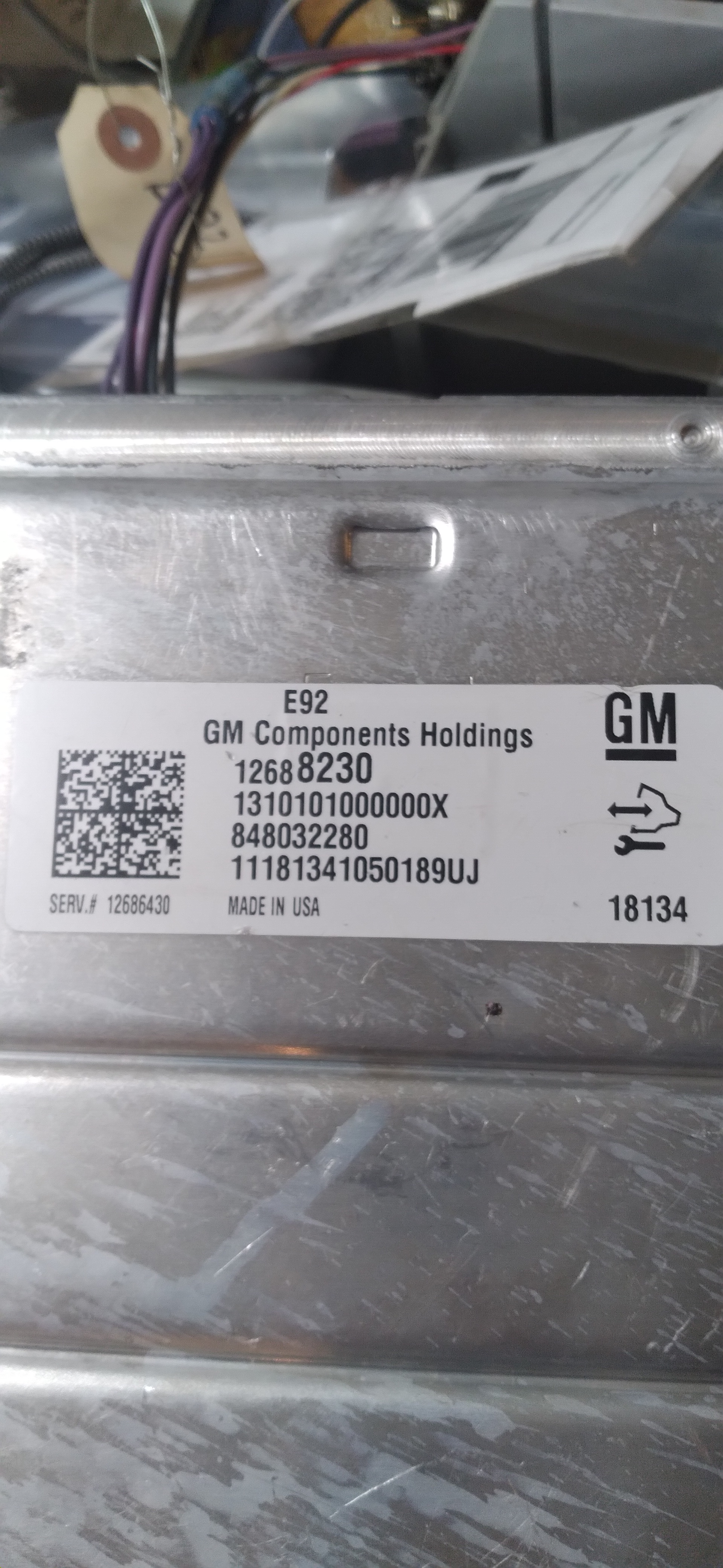

Might have to pick one up. How would I identify it from a standard E92? Probably look on eBay for one.

In-Tech
Posts: 785
Joined: Mon Mar 09, 2020 6:35 am
Location: California
Re: E92 PCM Reverse Engineering
Post by In-Tech »
Here's the one I am working with. Transplant into an early Chevelle, BTW does anyone know if I can use a 2015/2016 8 speed T87 and just swappy? I've heard warnings that it will kill the trans :(
