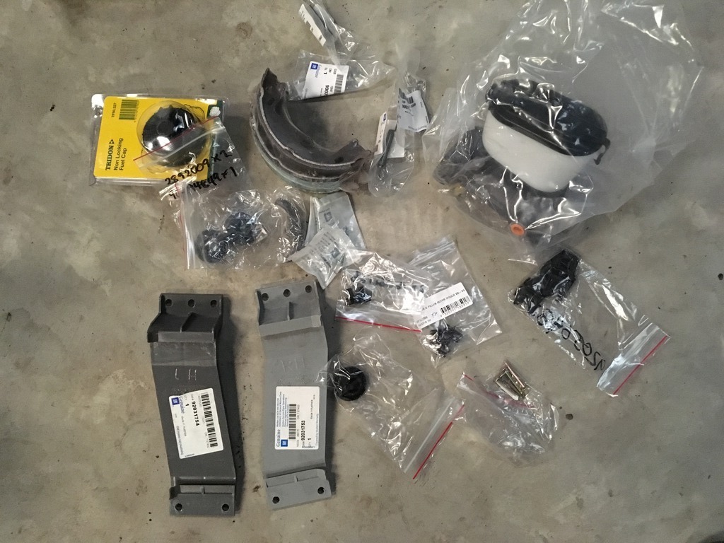

Got my stuff from speeds.

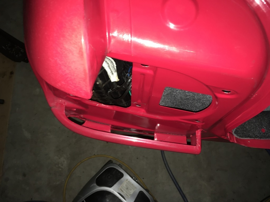

I need to make another trip from work for the other bumper as I only just managed to get one in there with great difficulty.
And got the other bits alongside.

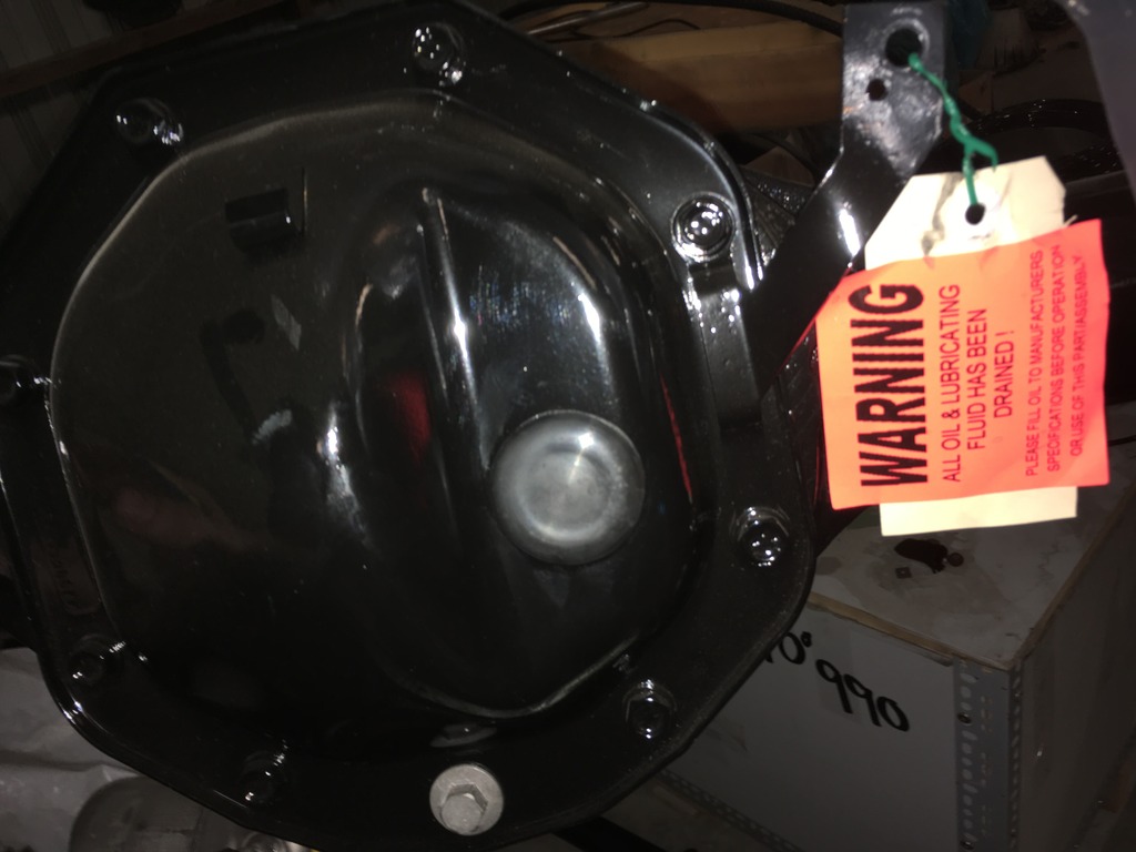

And finally a new diff plug, amazing how soft a NOS one is.

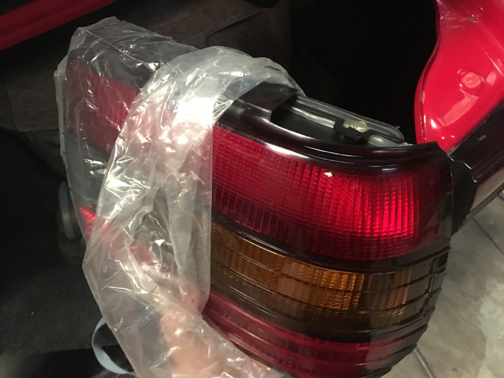

NOS RHS rear tail light cos that was cheap and where the car was hit at some stage so it looks funky the way the studs sit so I reckon they would be broken. Too bad I could find a NOS left one to match, but worst case I should be ble to find a really nice used one or make do with mine by making a new seal and cut/polish the acrylic.

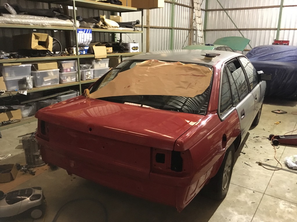

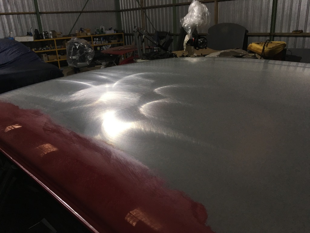

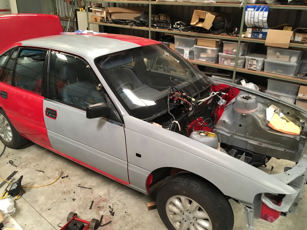

Also more progress on the paint stripping. Nearly out of microfiber cloths, all 40 of them and nearly 12L of acetone :lol: Not to mention a bag and a half of normal rags but they suck for doing this. To think I'm not even half way :lol:

250, not a nos one, just a Bosch/PBR one for the VP S. I got it for convenience and the res/cap since it will all be converted to run DOT5

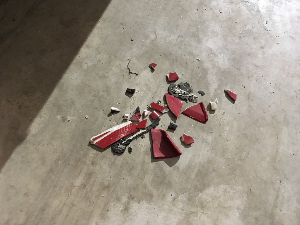

Couldn't even flex it the slightest without it shattering and bits flying off at the speed of sound.
Most of it I vacuumed up, but these bits were all on the floor. Was a painful process to pick each little bit off with all sorts of tools only for it to break in more bits.

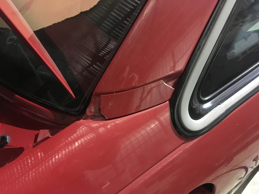

Got The pillar mould areas finally clean of the sikaflex stuff. a real PITA! Can't wait for the windscreen groove. :roll:

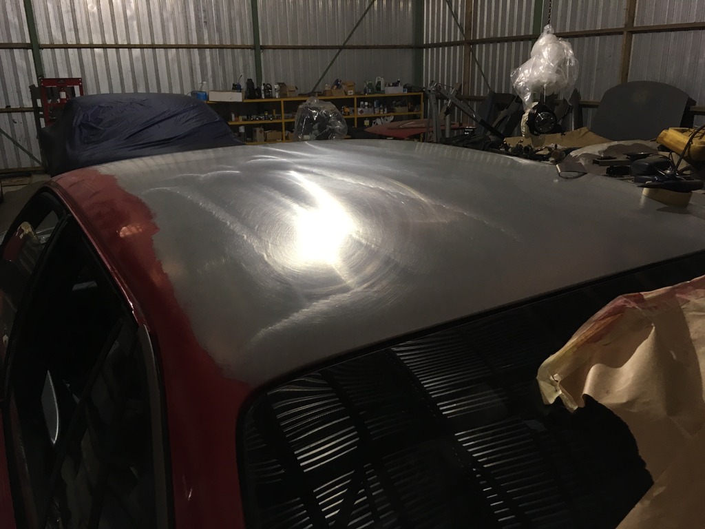

I always found it interesting seeing the prep and painting process the factory used by uncovering it using this unconventional method of paint stripping.
You can see the big ass sander, maybe a robot's markings in the intermediate/high build primer.
A close up.
