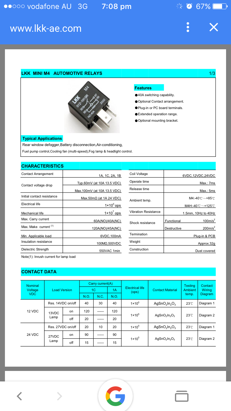

Post by Wade »
This is the relay I've got

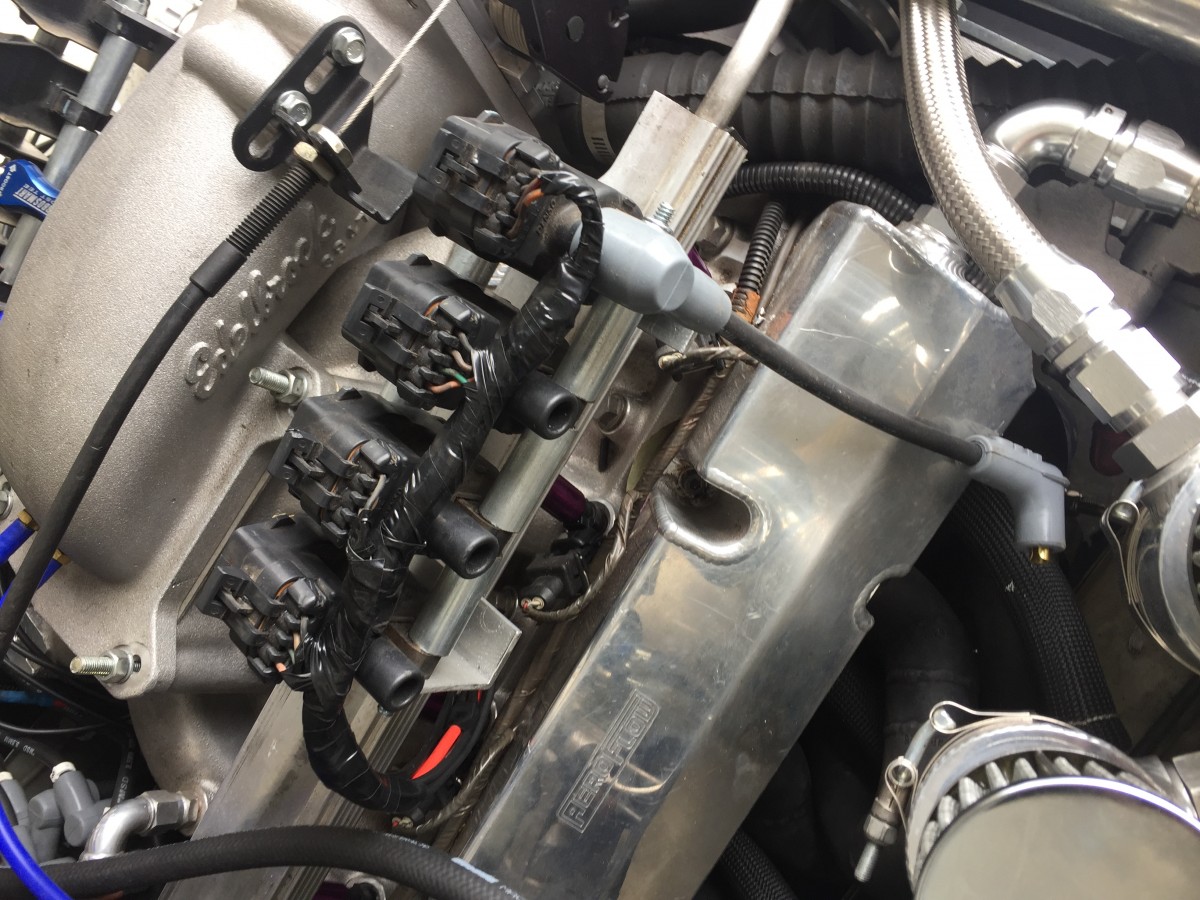

Post by Wade »
Got started on the coil wiring today
Re: Programmable Delco Ignition Module
Wade wrote:Will it be ok to run the coil grounds to the back of the block and ground them at the same location that the pcm wiring loom ground is? Also with the coil v+ will a 40a relay do? And as for the wiring I've got 25a wire.
Run the coil power grounds to near the coils or back of the block - keep it away from the clean/signal PCM ground. The coil signal grounds go back to the module.
The 40A relay is plenty, same with your 25A wiring. The each coil draws around 5A, wont have more than 2 dwelling at any one time.
