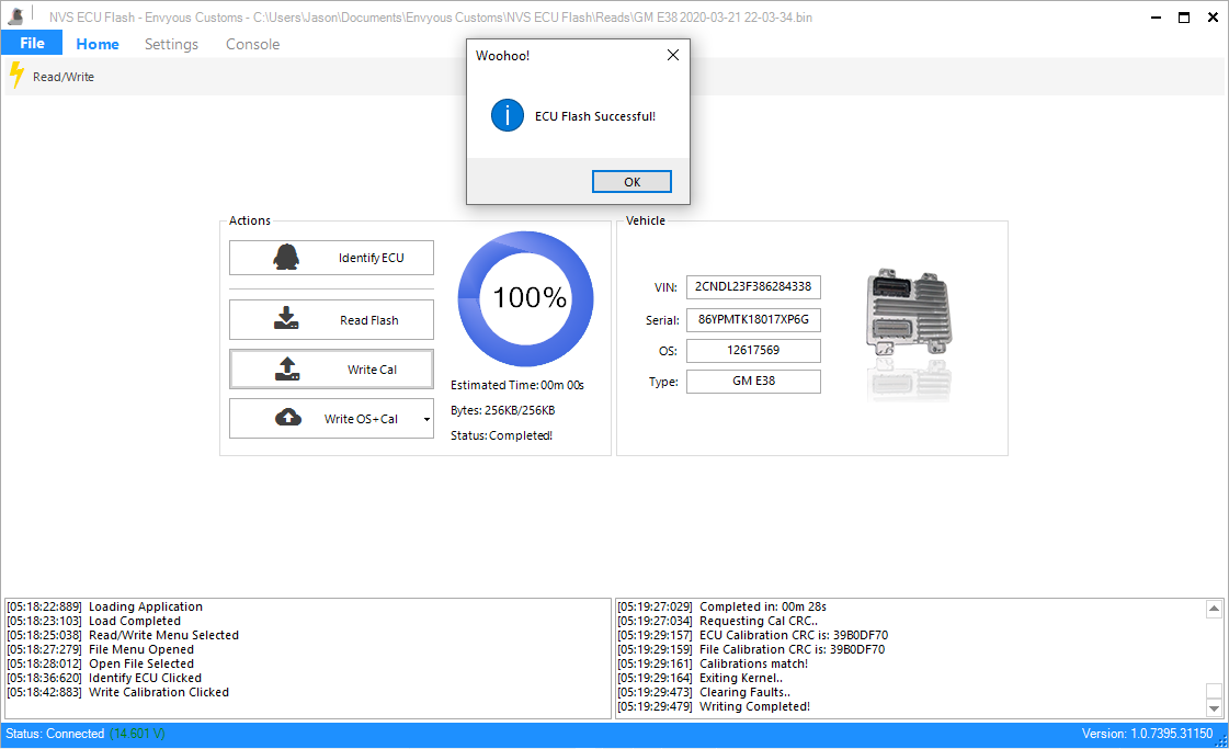

Re: GM E38 E67 Kernel/Bootloader Development Extravaganza
Allllllrighty!!
CRC and SUM working (And saved.. ).
Now, I opened up a file I saved from a tuned ECU, and the CRC (CVN) was correct, but the SUM was actually incorrect.
So... I would assume the SUM doesnt actually need to be done? Or maybe commercial tuning softwares are too lazy to implement?
I currently have the software to reject files which do not have a valid CVN and SUM.. but maybe thinking should only look at the CVN and ignore SUM if its out?
Allllllllllllllllmost there!!!
Tested on the laptop and it freaked out since I dont have coding in place to handy the initial folder creation in documents (Where its going to recommend saving reads and logs ect).
So.. we are now down to the last little fiddly bits
Nice, I noticed the dropdown menu on the write os and cal. What's in there?
Btw, the stock key(I assume that is what you posted) for that seed no worky. Interesting is efi will read it if I choose alt keys so I wonder if that means it's locked with something of theirs. Time to hook up the usb sniffer
Yes, I could just throw this in the trash and get another ecu from the junkyard but I like playing
Oh? Id be interested to see what key they enter.. Would imagine it must be either one of theres.. or hptuners autogenerated key.In-Tech wrote:Nice, I noticed the dropdown menu on the write os and cal. What's in there?
The dropdown on the OS+Cal has the clone option. Didnt want to put another button for it.
