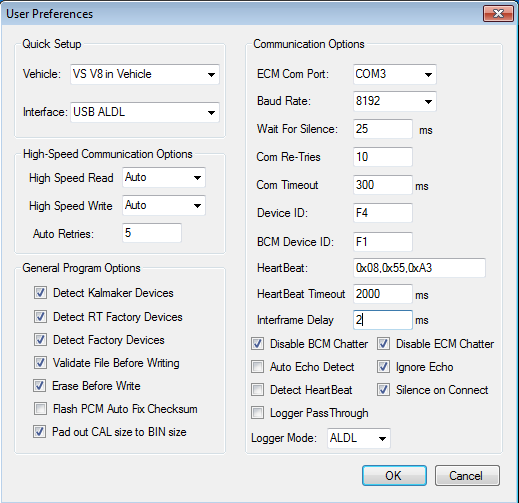

Attempting to use the flash tool to tune a VS V8 with 531 manual pcm via your usb aldl connector
Do I need to do any wiring to the pcm to enable read as I cannot connect?
I HAVE A ds1245Y WITH vs v8 enhanced $A5 loaded and the car runs no worries. Just no comms between laptop and nv ram
Any help is appreciated

Re: Delco FlashTool V1.51
check that you have 12v's and ground properly at the ALDL plug, as for checking the data wire, not much you can do there (other than it working) but you can check that the connectors are all in the plug and such I guess.
so the flashtool isn't connecting to it I assume ?
what settings are you using in the config ?

I'll confirm pinouts are good now.Holden202T wrote:check that you have 12v's and ground properly at the ALDL plug, as for checking the data wire, not much you can do there (other than it working) but you can check that the connectors are all in the plug and such I guess.
These are the settings I'm using
531 is series 3, which is a VT pcm... try the VT settings.
Good call mate. The VS bin only being 64k will still get looked up in the same place only anyways wouldn't it? I think the jumpers on the NVRAM dictate that and the Flash tool options don't accomodate for VTJayme wrote:531 is series 3, which is a VT pcm... try the VT settings.
I may be having a blond moment but not sure what else to try there
Pin outs are all good too btw
Try "VS V8 on Bench" and change to F5 for device ID, or "VS Eco or S/C on Bench". Without seeing the log from the flashtool its possibly the BCM not responding.
VS series 3 are 128k bins.
My bad, yes 128k is rightVL400 wrote:Try "VS V8 on Bench" and change to F5 for device ID, or "VS Eco or S/C on Bench". Without seeing the log from the flashtool its possibly the BCM not responding.
Tried to connect flash as Ecotec bench and we're in business
