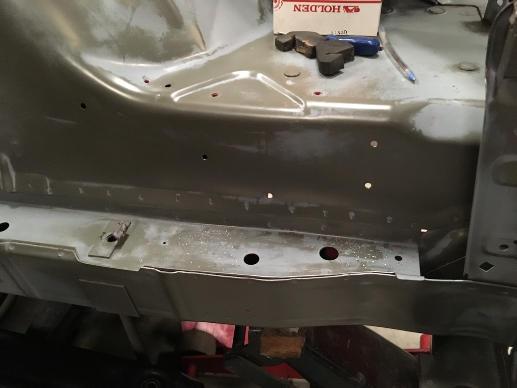

Drilled the holes today for the cruise control module. I cut a section of inner guard out from the vacationer before it went to scrap so I had a template for the hole locations. :thumbup:

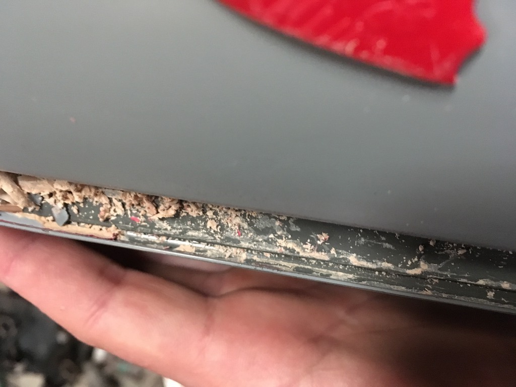

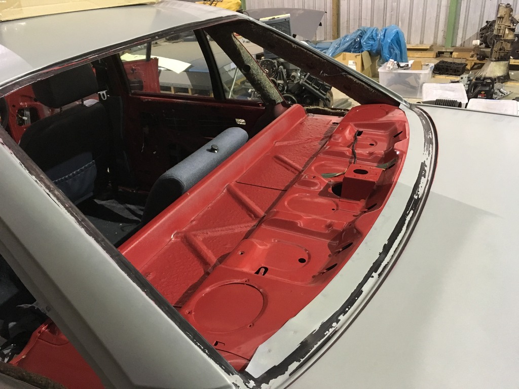

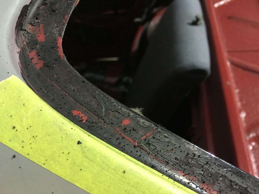

Also managed to sort out one of the roof gutters. What a pita that was. Sore hands blister on my palm. I made scrapers from old kiwi fruit spoons as the plastic doesn't scratch through the e-coat easily allowing me to go nuts on the hard old dried up seam sealer.
It is pretty sad but it got more sad at this stage lol.
Went over it with the cloth and thinners to take off the little bits left.

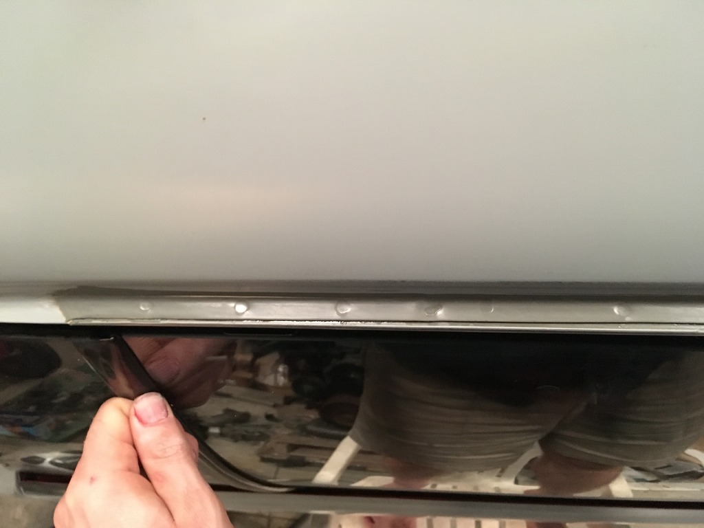

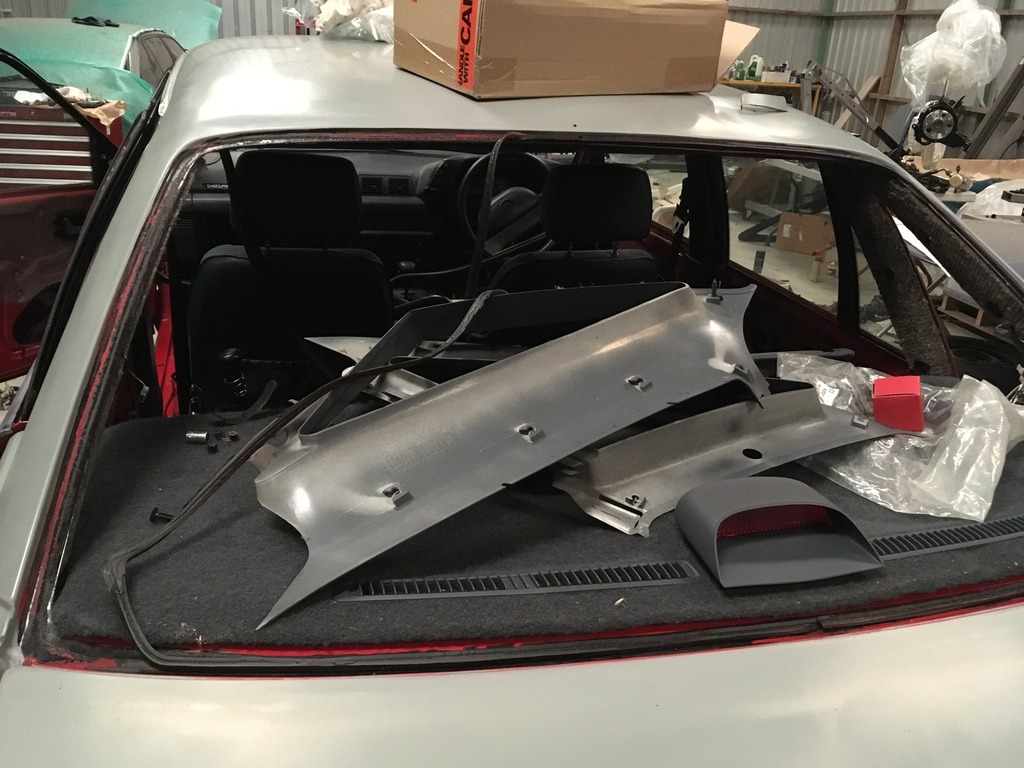

Screens out on Friday, sealant has mostly been removed already just need to wire wheel it to get the remaining crap off and I'll run my magic over the old paint.
Car has been emptied and nearing showtime.

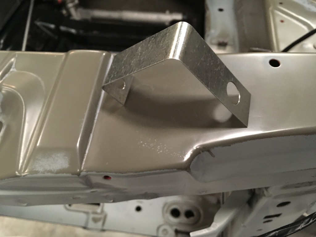

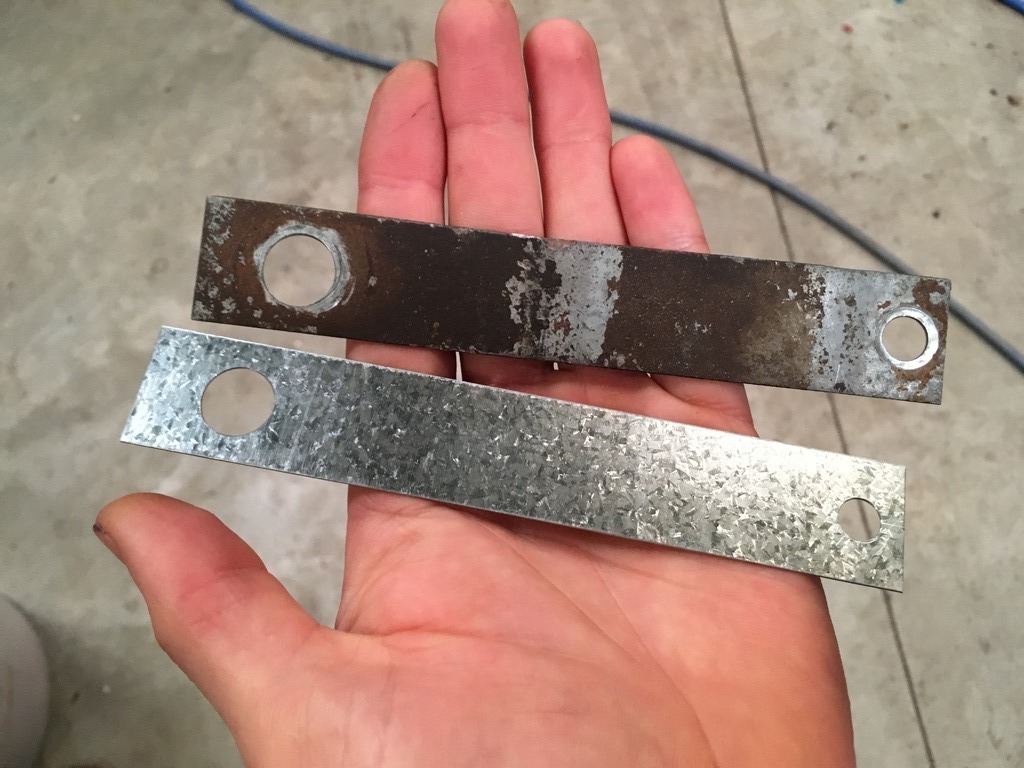

Made this. Its the security tab that goes on the T5 vibration dampener seen in the later photos down below.

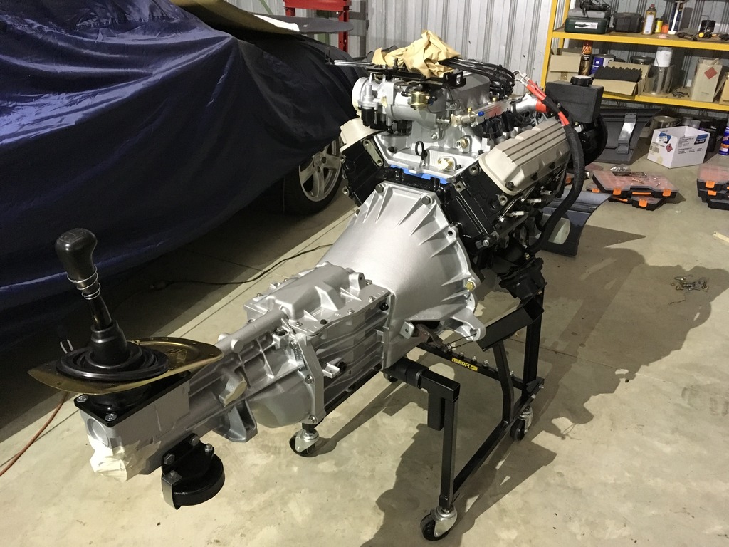

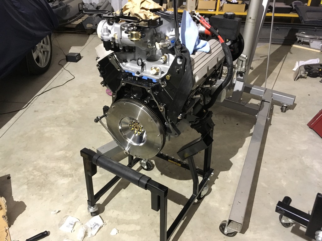

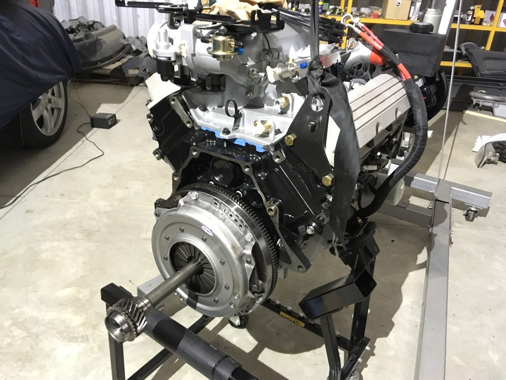

Now that I had the dust cover sorted I could work on getting that engine and trans mated finally.
Setting up the flywheel and clutch. No clutch adjustment data is available for aftermarket Holden T5 clutches in most cases. The stock pivot setting made the fork sit hard against the back of the window and partly engaging it. Stock is 102mm from pivot ball to bellhousing front face. I got 108mm in the end. What I did is worked out the travel distance in a full clutch cycle based on actual clutch pedal and cable range. This worked out to be 45mm.
The 108mm was just a figure I used from the extreme brand clutch I used in the VR as a starting point. After working out the 45mm travel I tested the clutch by operating the fork by hand until it gave and popped in as any good clutch does and measured the distance to where the clutch naturally wanted to pop to and yep, that happen to also be 45mm. So I knew the 45mm was correct and then the goal was to center the 45 travel in the window and after measuring fork clearance at the rear of the window at normal position and then the at the front of the fork at the natural engaged position the initial 108mm actually fluked the centering perfect. :thumbup: So I also checked the side pins of the fork in the center bearing carrier slots, they are close but not touching one side when in home position. engaged they do the same but on the opposite side of the slots. So that means the pins travel arc is also centered in the slots, so there will be no binding.
End measurement for anyone to use with any clutch is to aim for 71-73mm give or take from the clevis point of contact to the rear of the bellhousing face. That way its a good ball park way to adjust regardless of clutch kit used as they vary wildly. Visually its 1/3rd of the window in its home position, travel is another 1/3 and there is 1/3 left spare room before it bottoms out on the window.
Tadda!
Bloody long unit!

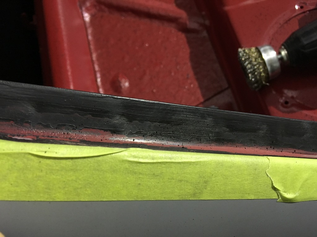

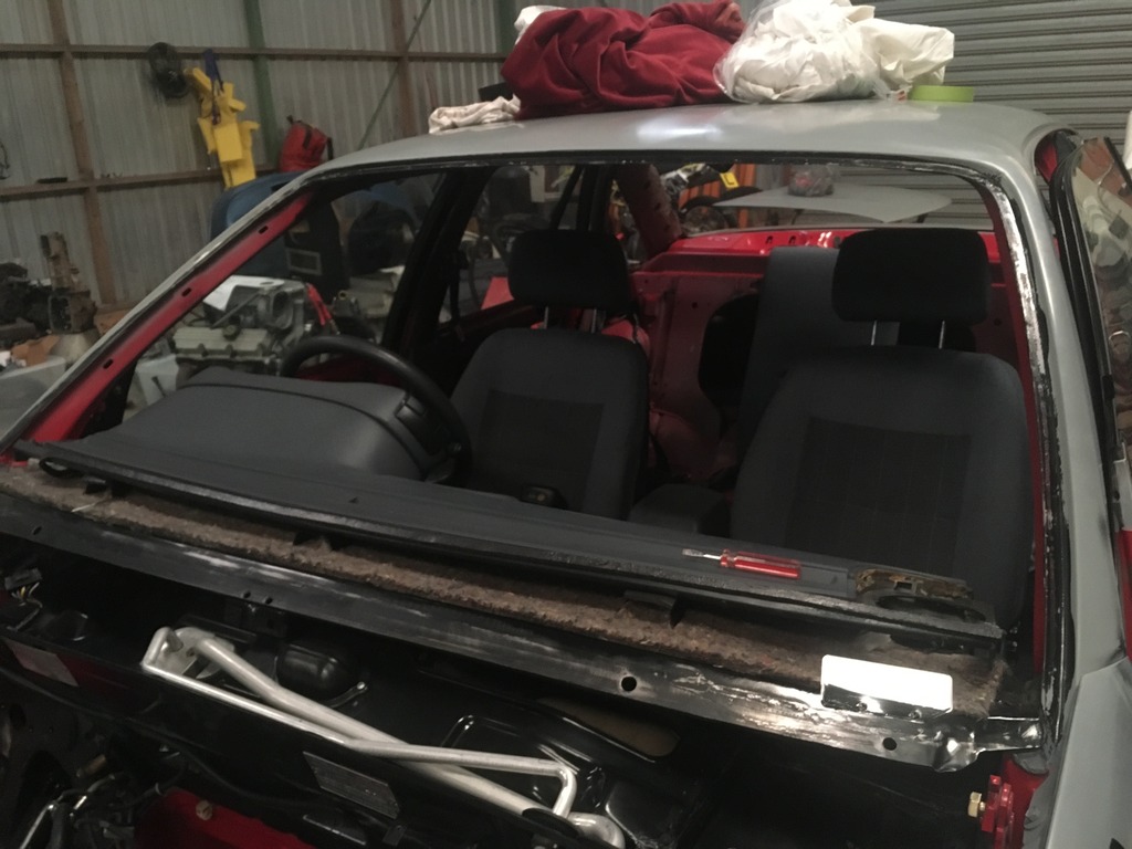

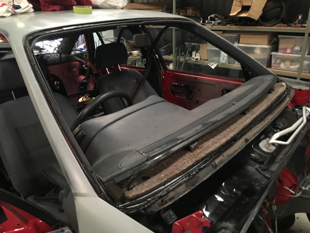

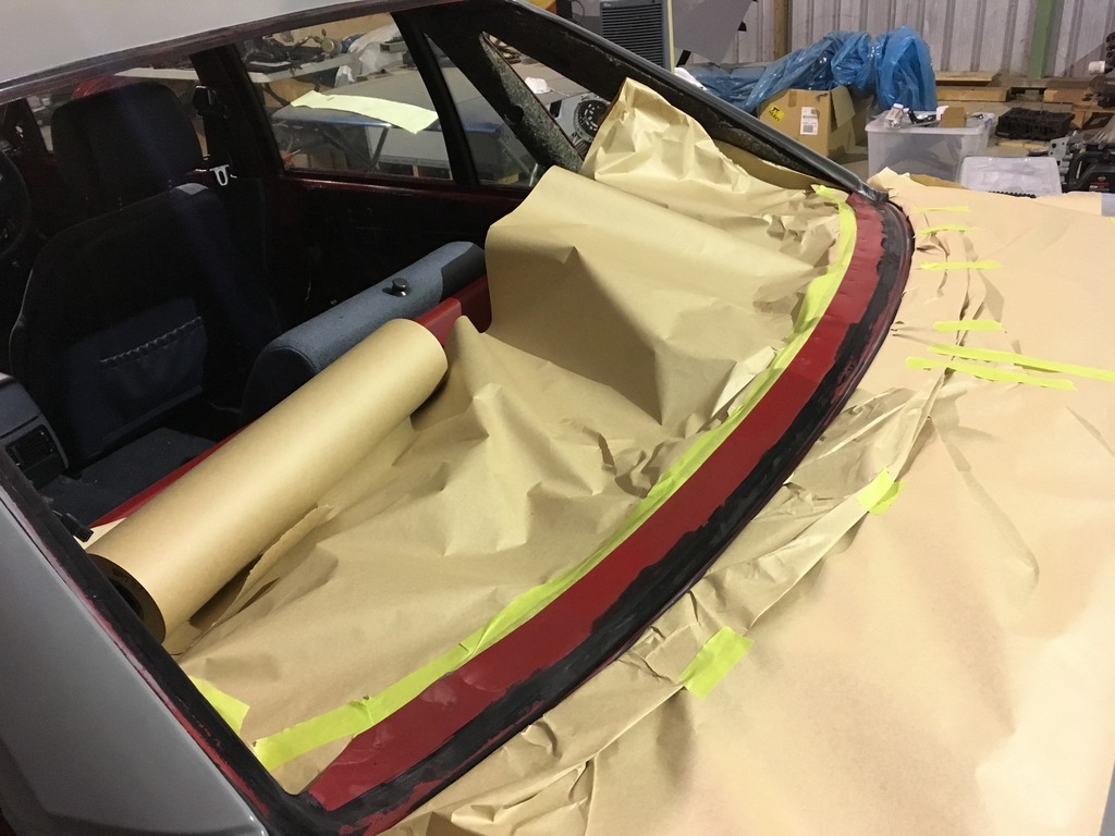

Time to wire wheel this sealer off.
After. You can see that 2 pack black paint is like armor lol
Mask it up.
All cleaned up as best as i could. Obviously that black crap will need to be flappy or corral disked away and all 2 pack epoxy primed but I'll leave that to the shop.
Front done.
