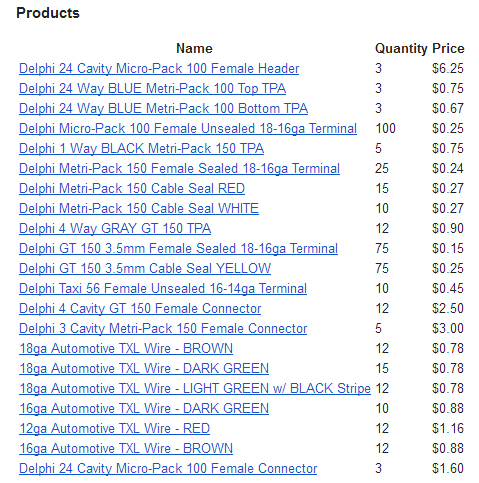

Made another order. I forgot the oil pressure switch connectors on the last order. I also found a fair few wires no good, brittle as glass so running complete new ones for those.
Also got a heap of late model LS style coil connectors and bits to suit. Stocked up on some terminals too. That will be for the future VP S project.

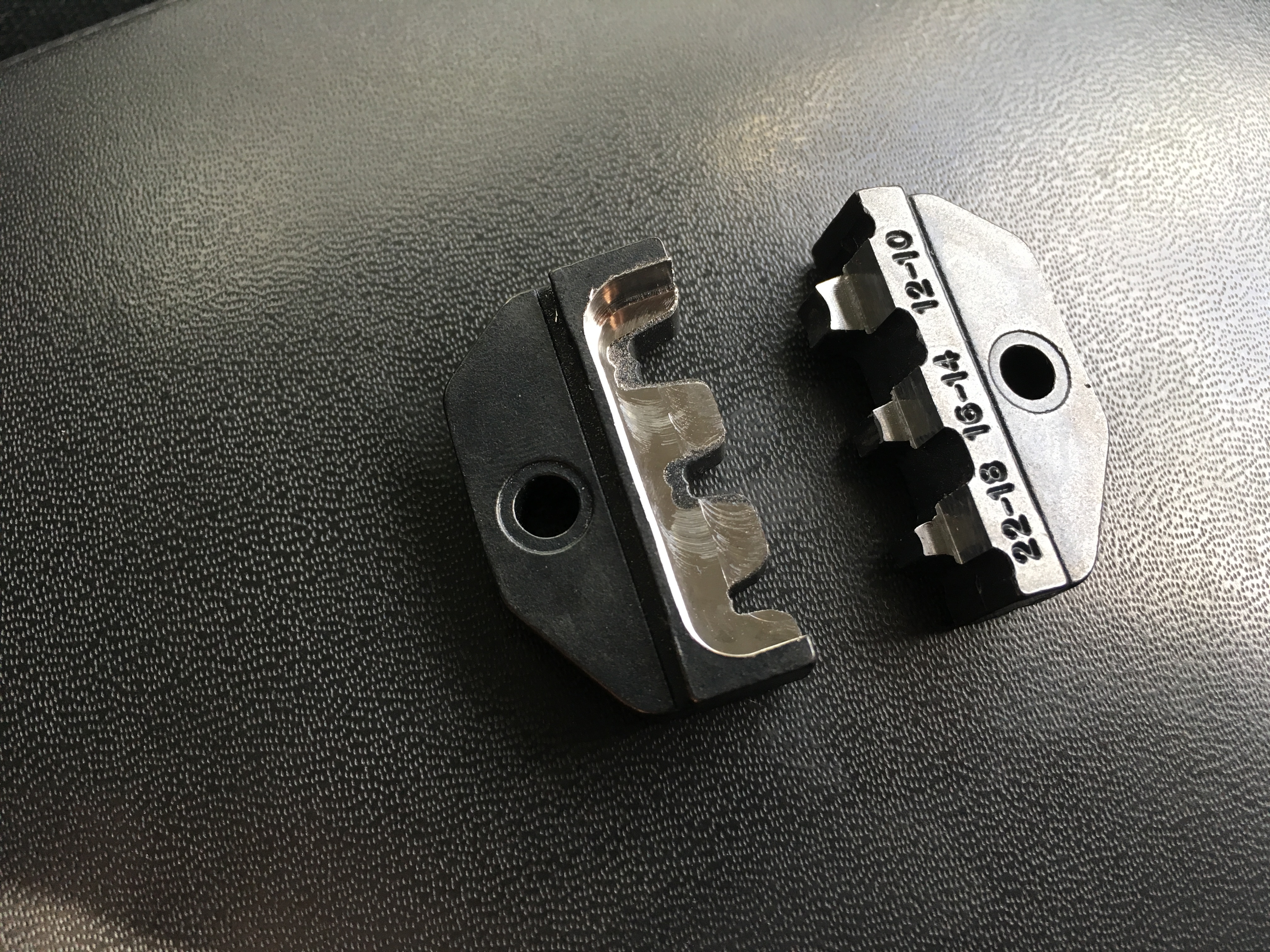

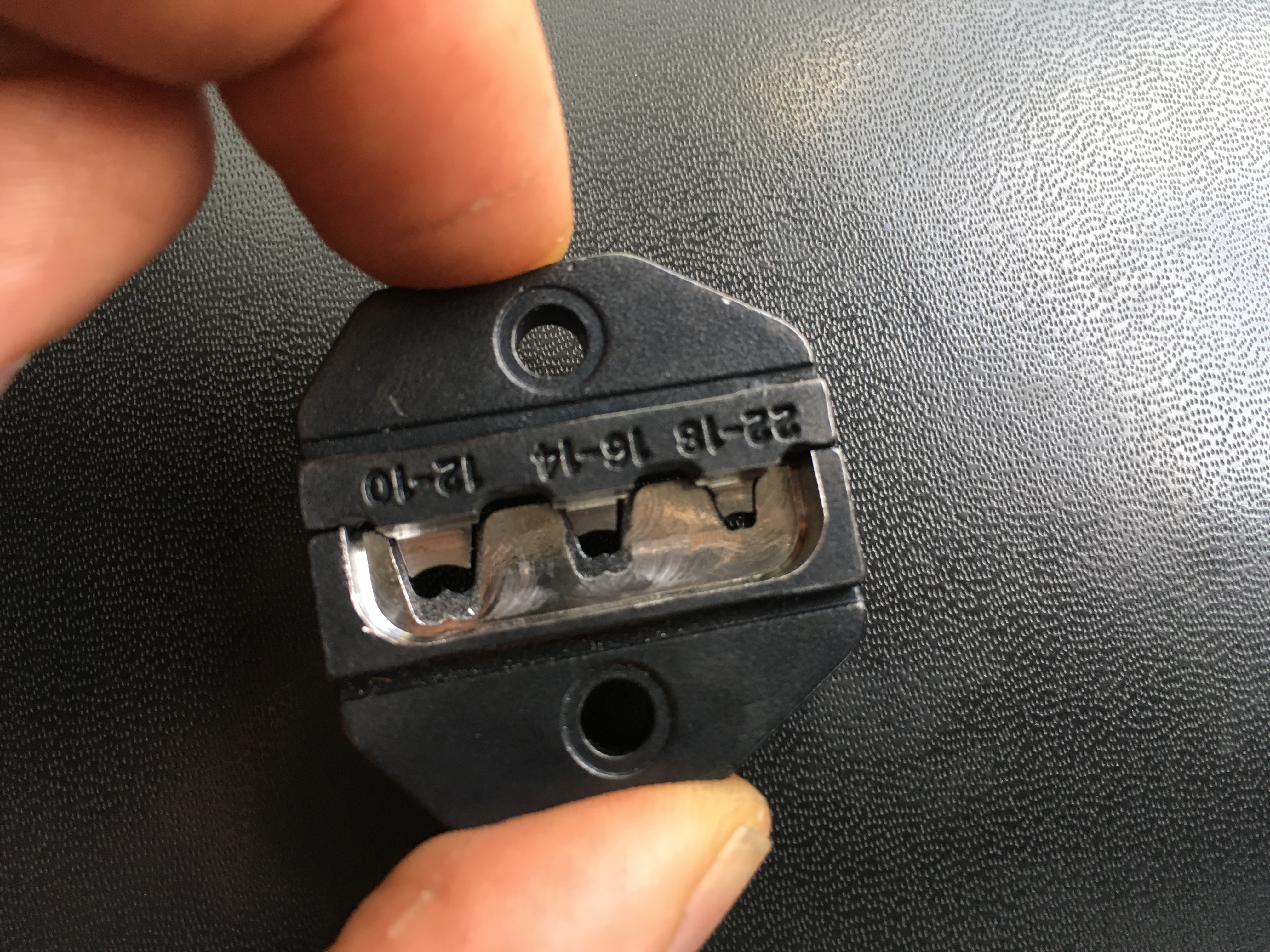

Only thing I am now short on is 12g red with black stripe, purple 14g wire and a bunch of 0.250 series non sealed, tang-less and dimple-less female spade type connectors.
G reckons he has them, but its its not exactly the right fit as the OEM ones I found the identical ones right here at RS components.
http://au.rs-online.com/web/p/crimp-rec ... s/6831443/
http://docs-asia.electrocomponents.com/ ... df81f5.pdf

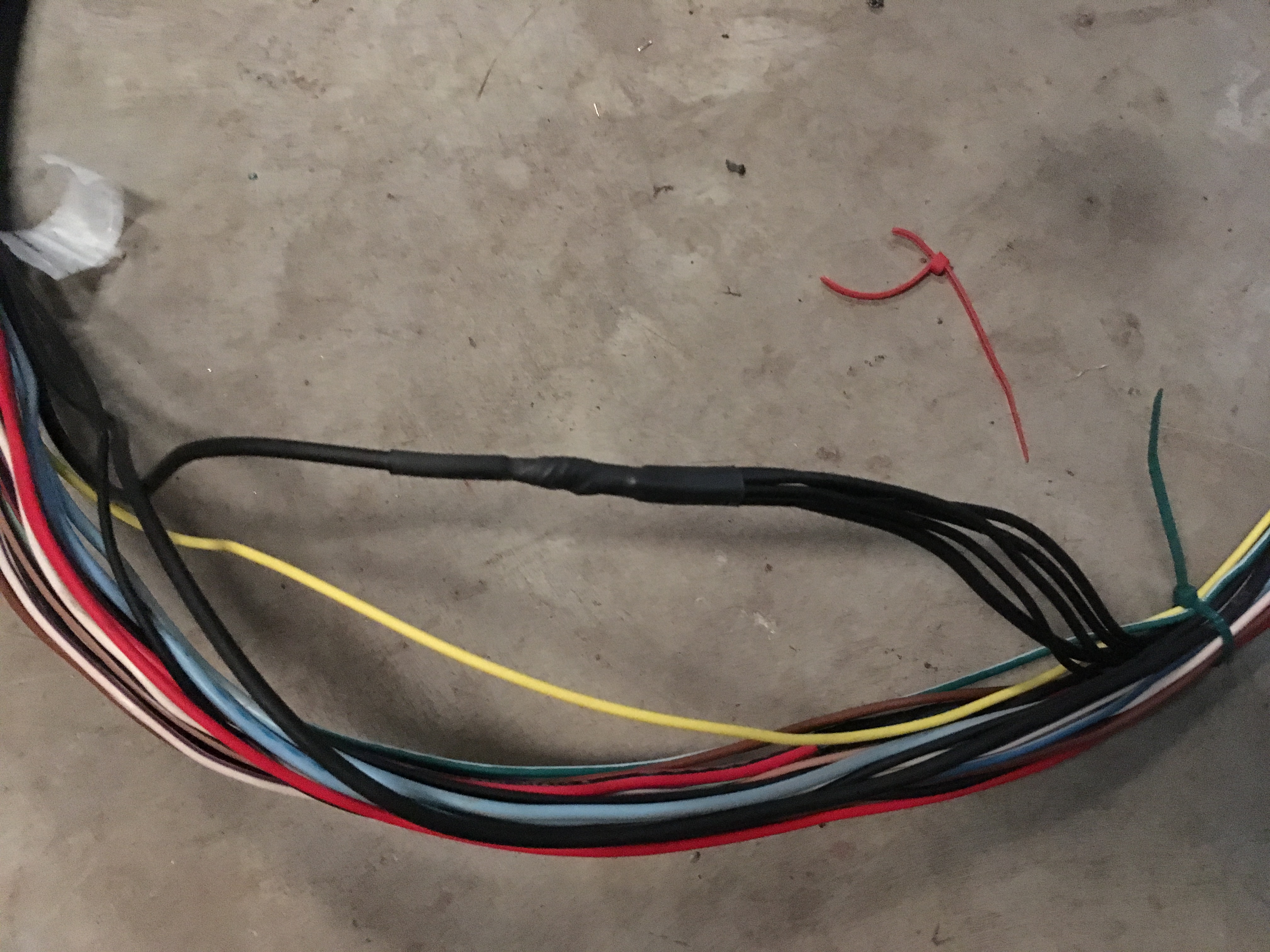

Did some more on the loom. All grounds run with new wire and lug terminals.
O2/WB heater and ECU grounds done.
lol this one was a bit hectic. That has A12, D10, D6, ALDL Ground, WB (ECU ground) all to the 10mm ground lug.
D1 and D3 are as per normal except I added WD heater ground down close to the 8mm lug so it has lest interference to the rest of the system.

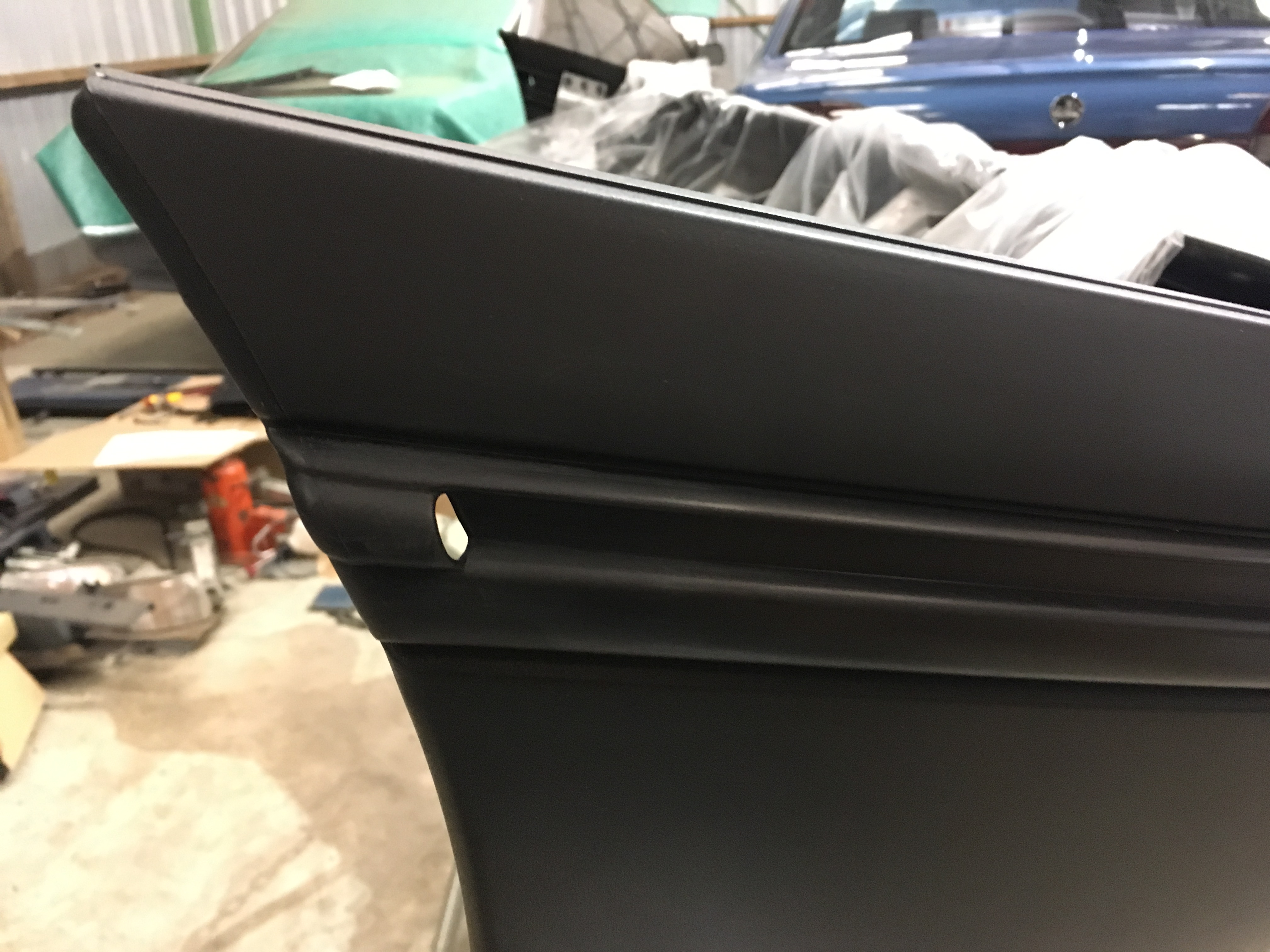

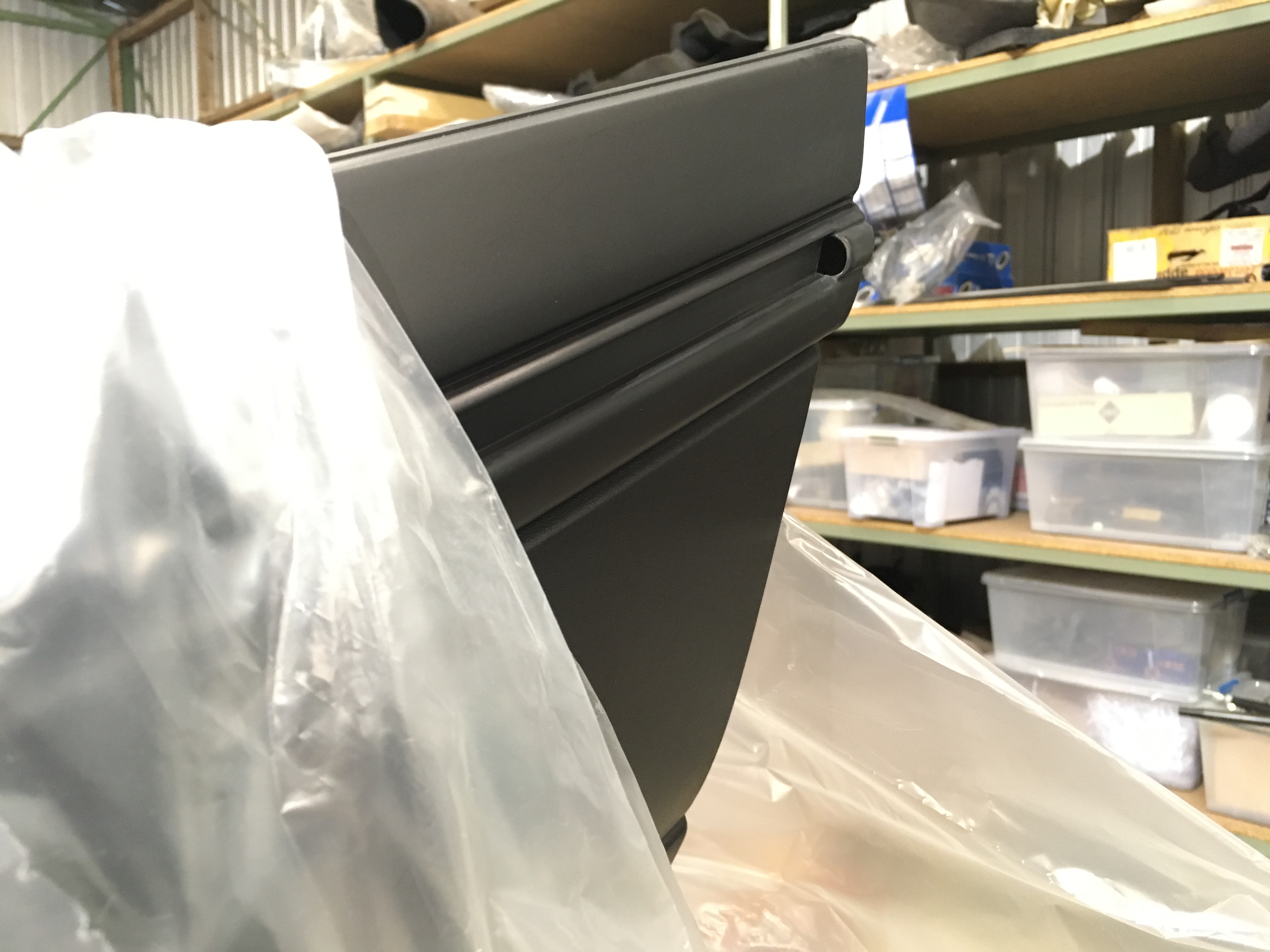

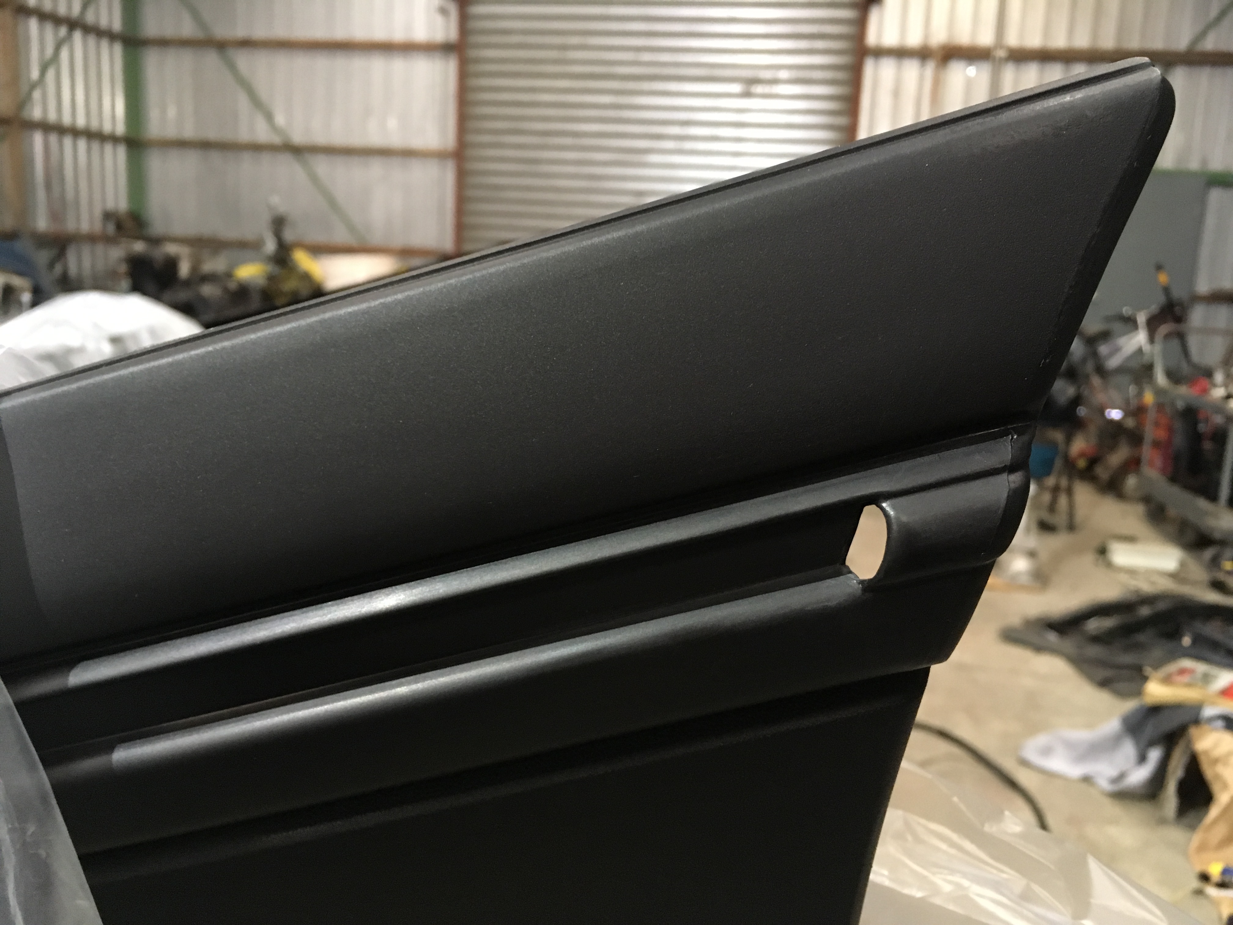

Also I heard the car was getting close to paint so I got into gear to try get the bumpers ready.
These are a damn PITA! can't just cut them out. I found a thin scalpel type blade heated red hot and slice the section out that way and then spend the next 20 carefully sanding it out to shape and smooth. This plastic doesn't sand really. its got s stringy grippy like grain, just fluffs up and rolls off little bits. Like trying to sand the rubbery grip stuff that put on phones and pens etc..
Just 2 more to go
Seriously I wish there was a die cutting like tool for this shaped hole. The factory probably did.
Just 2 more to go
