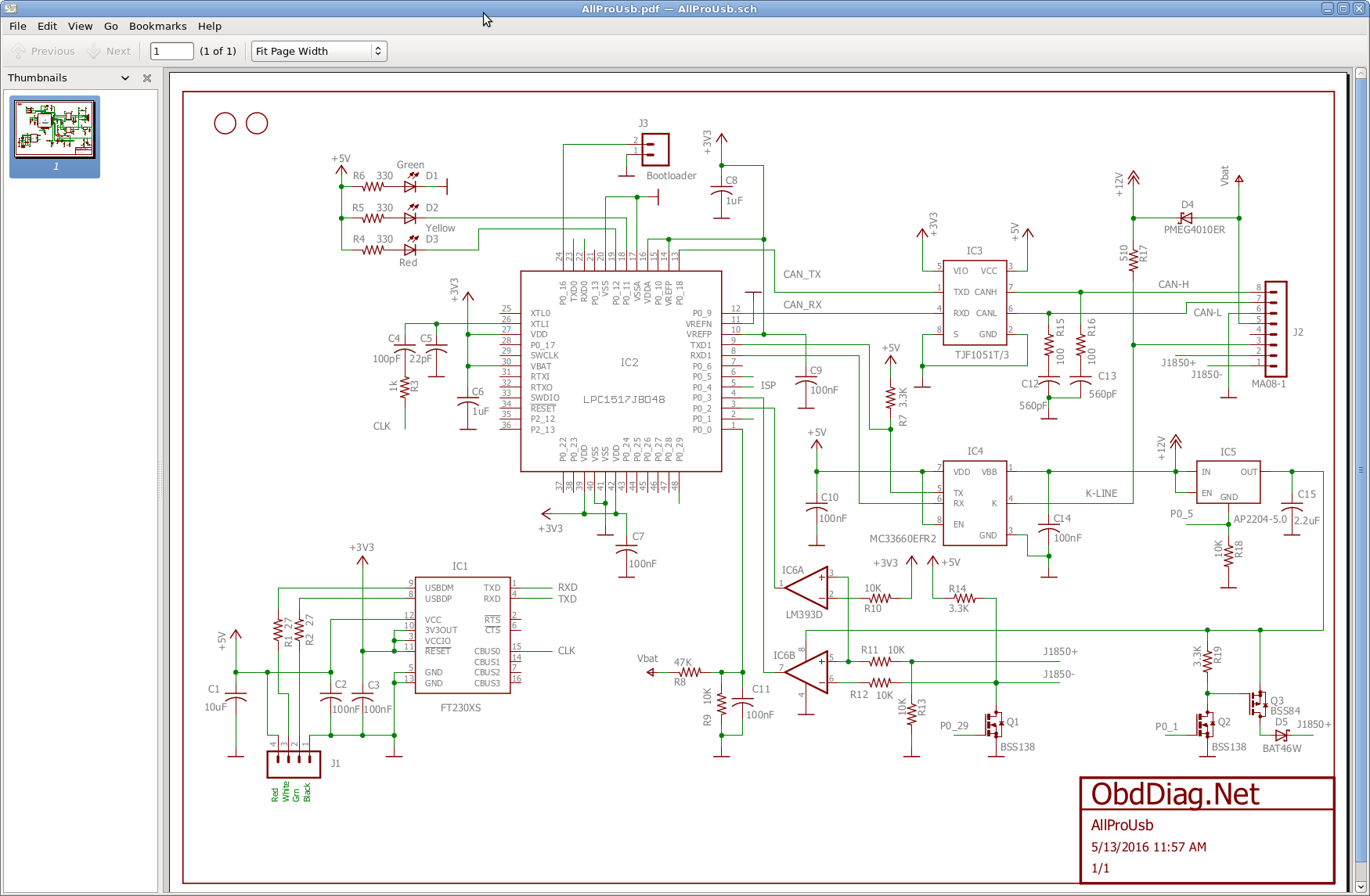

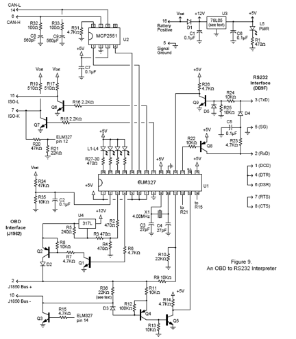

https://e46canbus.blogspot.com
Thaniel
Posts: 10112
Re: Open source GM OBD2 flash tool using a ELM327 device
Just looking at your post, you seem to be searching for an electrical solution but havnt mentioned evaluation of the allpro or elm electrionics. There are also voltage tolerances in the official J1850 spec.
Most devices dont follow the spec 100% and just generate a square wave, rather than the slope which is a documented part of the official standard.
