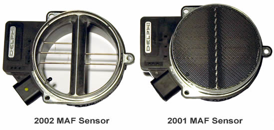

Just a note to all those out there using the LS6 MAF's, i have had 3 cars now using the MAF's and have found the one's even being sold as genuine to be limited, in the range of 9500 - 10000hz, they will start to jigsaw on the graph and make the engine run lean/rich which limits RPM like stalling the engine, i have so far only tried another one which has the "Delphi Sliver badge" on it not the white sticker only model and it has worked fine well past this limit and is the original type i tested on the bench and in the first vehicles with the enhanced code. Also the ebay link further back in the thread seems to be now selling the non silver badge limited type, so you will have to search elsewhere for a "Silver Badge" type one, below is a photo of the ones i am referring to.

Bit disappointing hopefully the card type tests ok & they don't start making knock off 1's of them!

the sensor internals are also different, the good ones have 3 wire sensors, the bad one only has two wire sensors and normally where the third one is it has a diode in it's place.
Re: Enhanced Factory Bins
Yeah I have noticed the difference between the silver delphi labeled ones and the white sticker type too. White sticker type, jagged airflow above around 7000 hz (now a paper weight). Metal delphi label MAF is fine at least up to around the 10000 that my car can take it to. Seems some factory in China may be making these
. Very good knock-off's though only difference I can see is the diode that The1 mentioned, and the temp sensor looks a bit different too.
Anyway I guess these are the risks you take on ebay lol.
