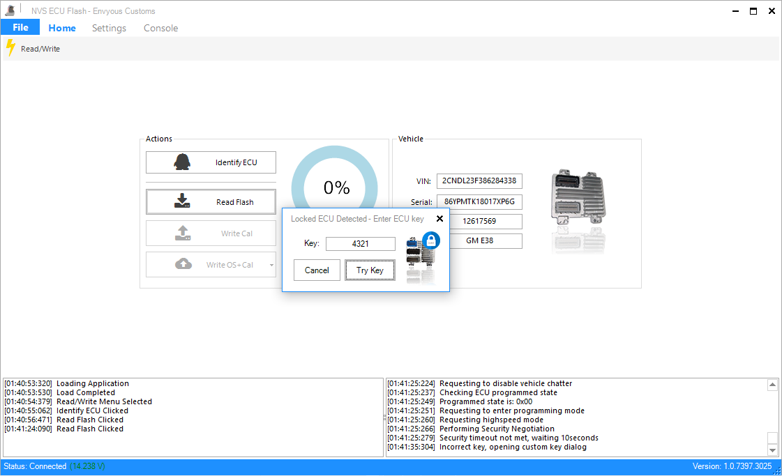

Another late night special update.
Folder check on boot implemented. Warning will display if these folders cannot be created.
And tunerlock form fully working. Application will allow entering a custom key up to 5 times before cancelling the attempt.
And on that note... I would say.. we.. are... done! Will do a final test/run in my ute tomorrow as a final run through.
And also throw a new icon onto it, pop it into a package installer and should be ready for release.
