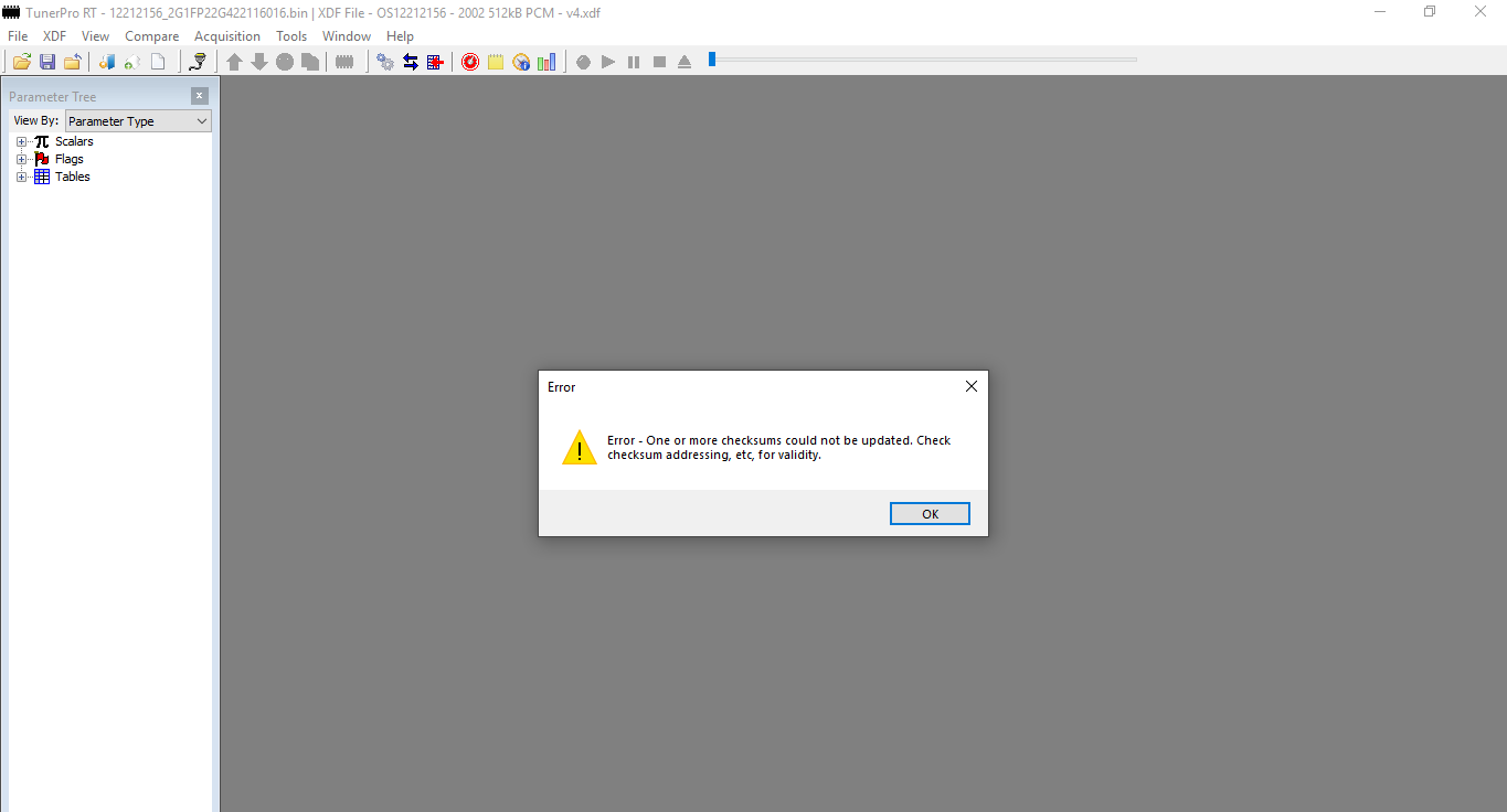

Doesnt seem to want to save anything and i get this error on saving any changes
Will attach XDF I'm trying to use as well as factory file I'm trying to edit
Does anybody have a XDF they are willing to share that known to work so i can add the boost patch to it after?
