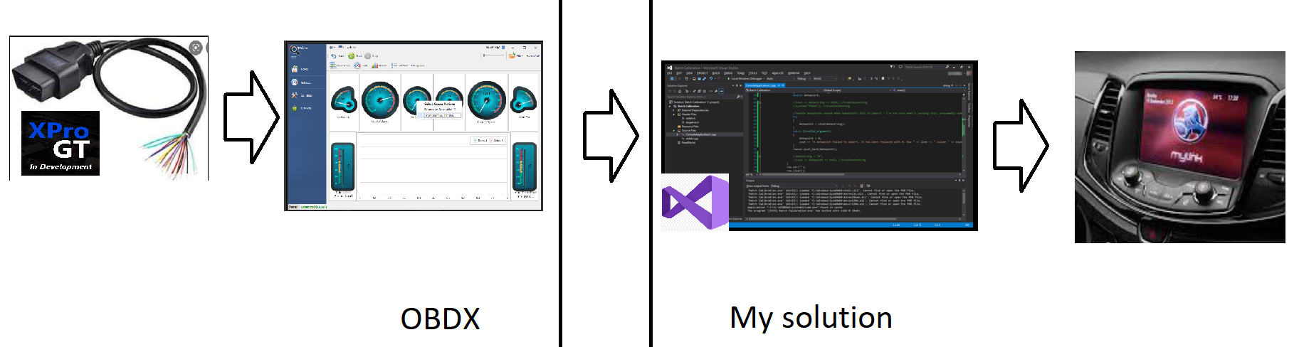

Post by hjtrbo »
Hey Tazzi,
For the homebrew guys, (if you can make sense of what i'm saying), is there a way to have your cable and software running behind the scenes and have the live data available for me to grab with my app and display it on custom gauges that I make?
Reason I ask is for guys like me that haven't got the skills or haven't invested the time to get a custom GM LAN solution up and running by mimicking an HP Tuners device etc to poll for data, we could use your suite of tools to nominate certain PIDs, and you would expose it for us with a easy to use API that we can get running in Visual Studio so that we can write a simple app to do what we want with the PID's. In my case, I would create a custom gauge app with alarms etc and display them on my vehicles mylink via the appropriate GVIF interface boxes.
Posts: 3558
cars: VE SS Ute
Location: WA
Post by Tazzi »
hjtrbo wrote:Hey Tazzi,
The OBDX tools support the basic ELM command set, so you could use that. You could also use a HC05 bluetooth module in master mode to connect to the dongle wirelessly with your microcontroller project (Which is polling for PIDs ect).

Thanks for that Tazzi. Say I was looking for PIDs that aren't normally available in any app I've ever downloaded from the play store but HP Tuners can get them, can I get those enhanced pids using elm commands? Sorry for the newb questions. Once I get into the project all will be much more obvious to me.

If accessible with HP, then its a matter of figuring out the PID value and its calculation to then use with an ELM style application. :thumbup:
