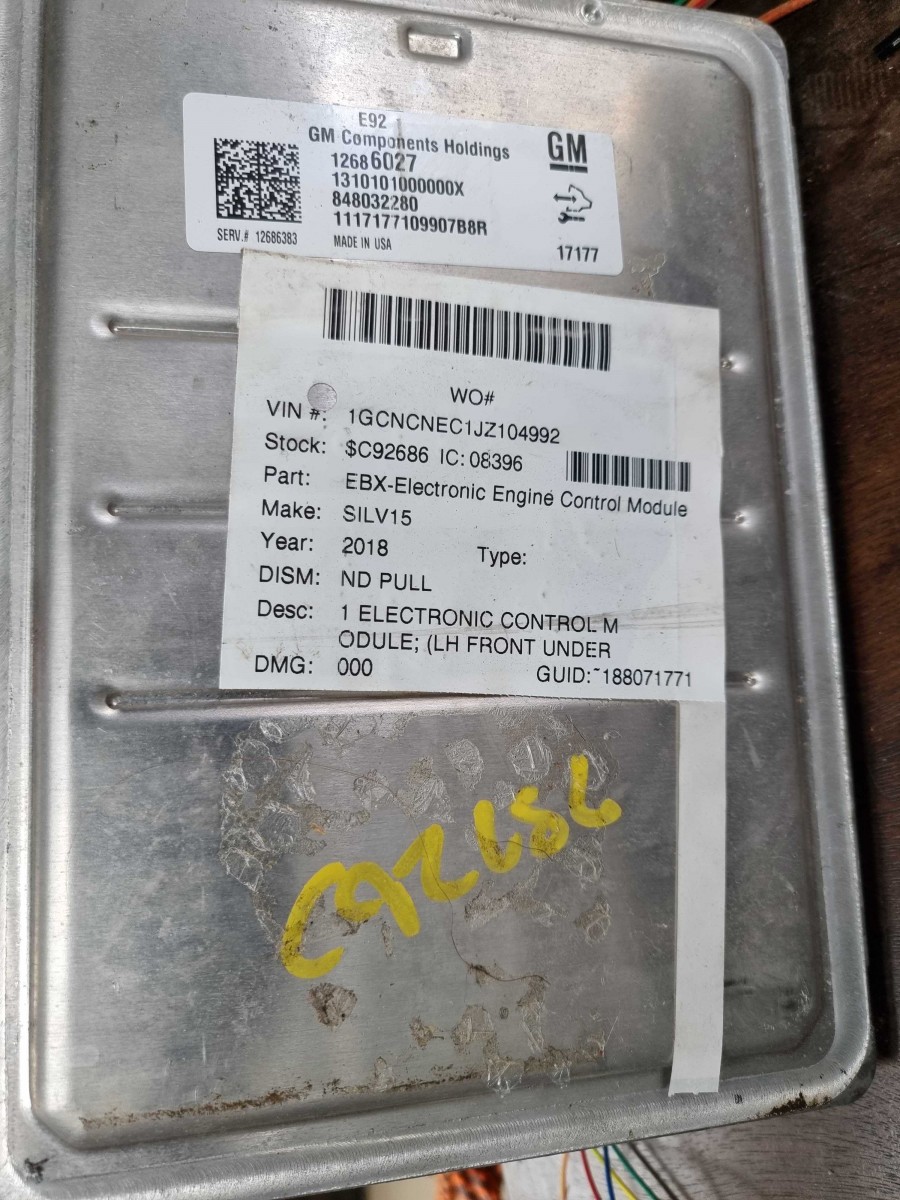

Ok, so I've created a branch of PCM Hammer that can communicate with CAN ECU's (Discussion on that Here) and I was able to upload my kernel and read the ECU for the first time.
The kernel seems to be working quite good, but I've only tried it a few times so there could still be problems. I had a couple issues with it crashing the ECU part way through the reading, but I was able to figure it out.
I have some cleanup that I need to do with the kernel. I would like to try and move onto the flash programming, but I know that the CRC, checksum, or whatever is in this ECU will stop me in my tracks. This is the only ECU I have at the moment so I would like to keep it alive, so I'll start researching what needs to be done so that I don't brick it.
Ideally I would be able to find a way to recover it from a software brick of some sort, but I imagine I would have to solder to that board for that.

I can and I'm sure others can give it a try on a bench E92.. For writing I am using the factory sps format and the aftermarket's appear to be doing the same.. In any case if your writing your own I would stick to doing something in the calibration section as if it does get bricked it can get fixed with gm sps or other software..
