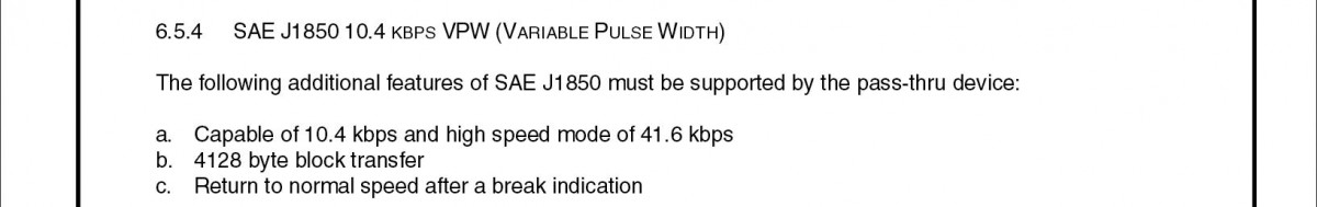

SAE J2534-1 Revised DEC2004

just a suggestion here but how about adding a section in settings for the j2534 devices to be able to manually set the max send a receive size if it turns out that you have an odd device like mine. makes it a little more dummy proof for those who dont know visual studio.Gampy wrote:I agree it does not conform to the standard, and it does not support 4x.
I do not know the exact wording of the J2534 J1850VPW buffer size specification off the top of my head, but the specification size is: 4128 bytes.
So their VCI does not meet the J2534 J1850VPW specification, or even the J2534 specification which I believe is the same size.
If you have MS Visual Studio 2017/2019 installed (it's free), it's simple to build PCMHammer, just use the Kernels out of a release and copy them to the Apps\PcmHammer\bin\Debug directory, then reduce the MaxSendSize and MaxReceiveSize here: J2534 Packet sizing, build and test ... Wash and repeat until you find it's max capabilities.
It's probably not worth the hassle, or even wasting your time communicating with them ... They likely know, they likely don't care!
That is a lot of money for a non-compliant J2534 VCI ...

Whats happening is the tool looks designed as a scan tool (scan matik) which has minimal technical requirements. Slow/standard speed, packet lengths ~ 12 bytes. As soon as you get in to reflash territory - high speed (4x) and large packets (up to 4096 bytes payload plus headers), the cable isn't made for it and it looks like its dropping the data or cutting it off instead of transmitting it as intended.
