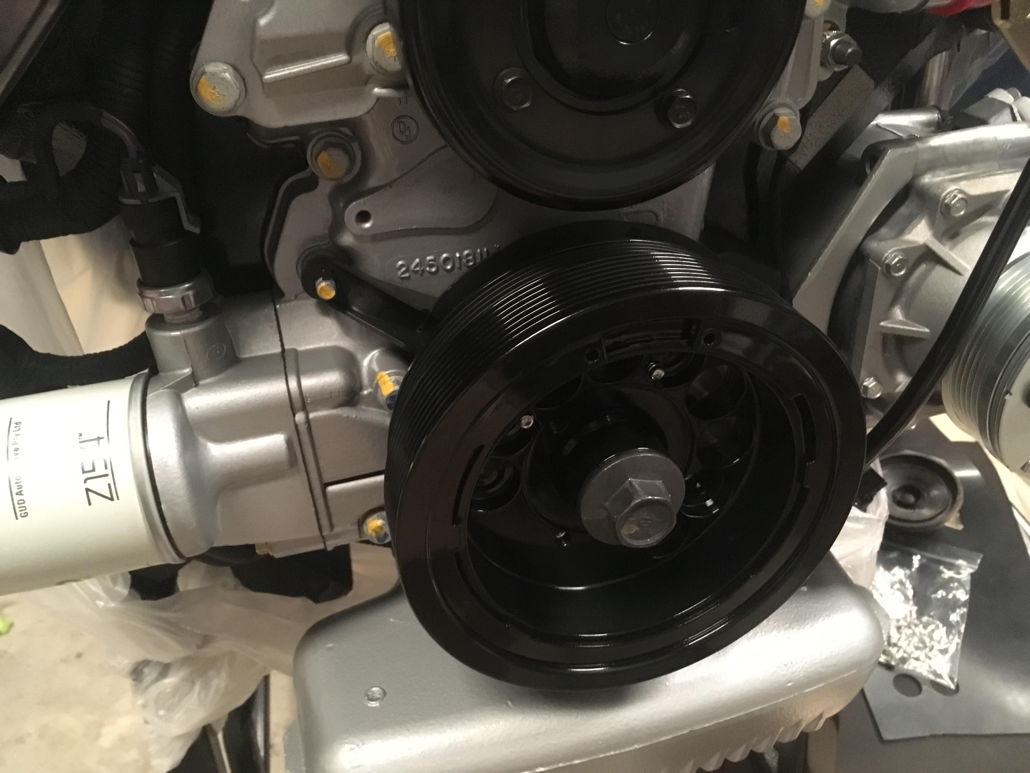

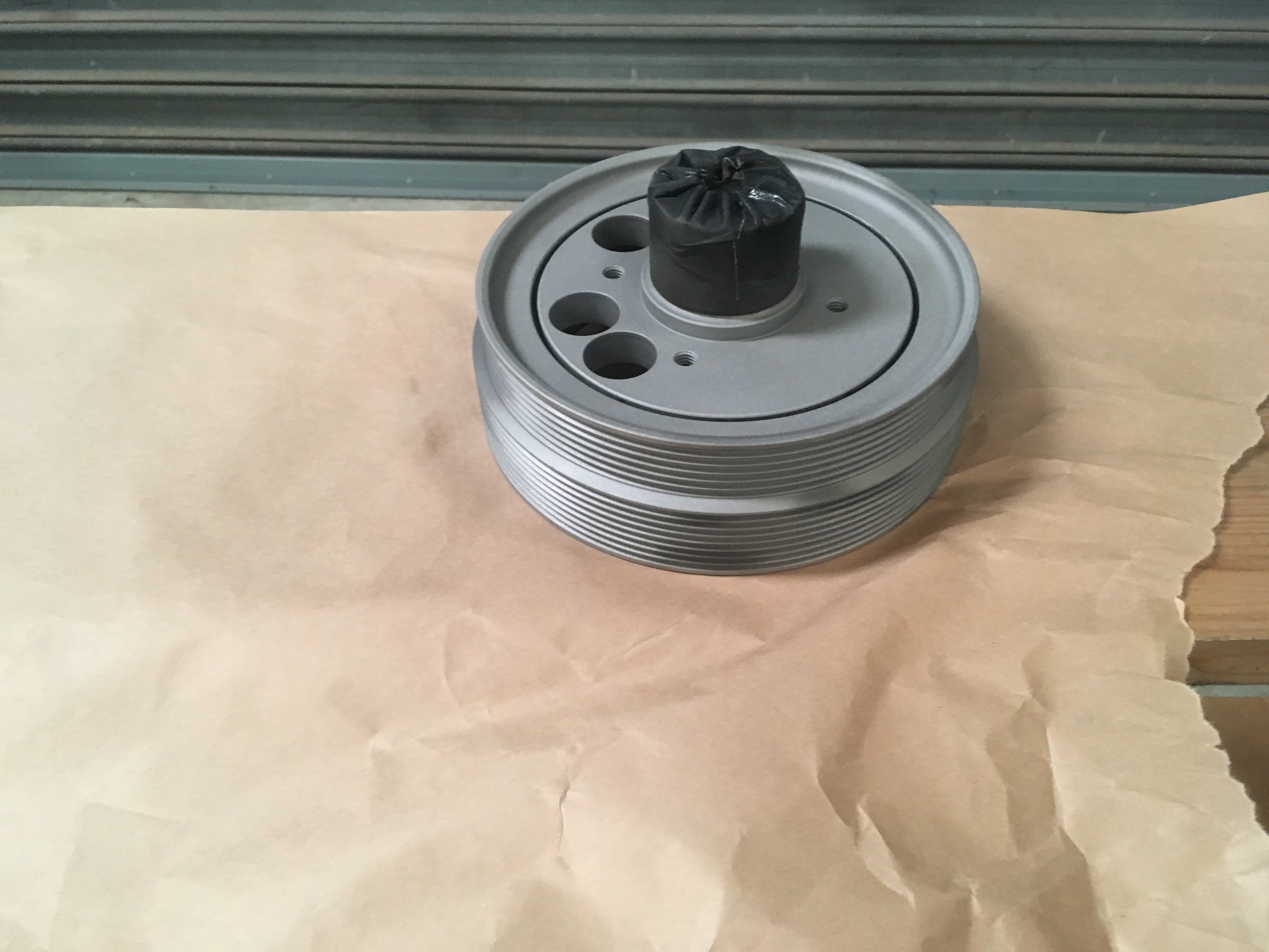

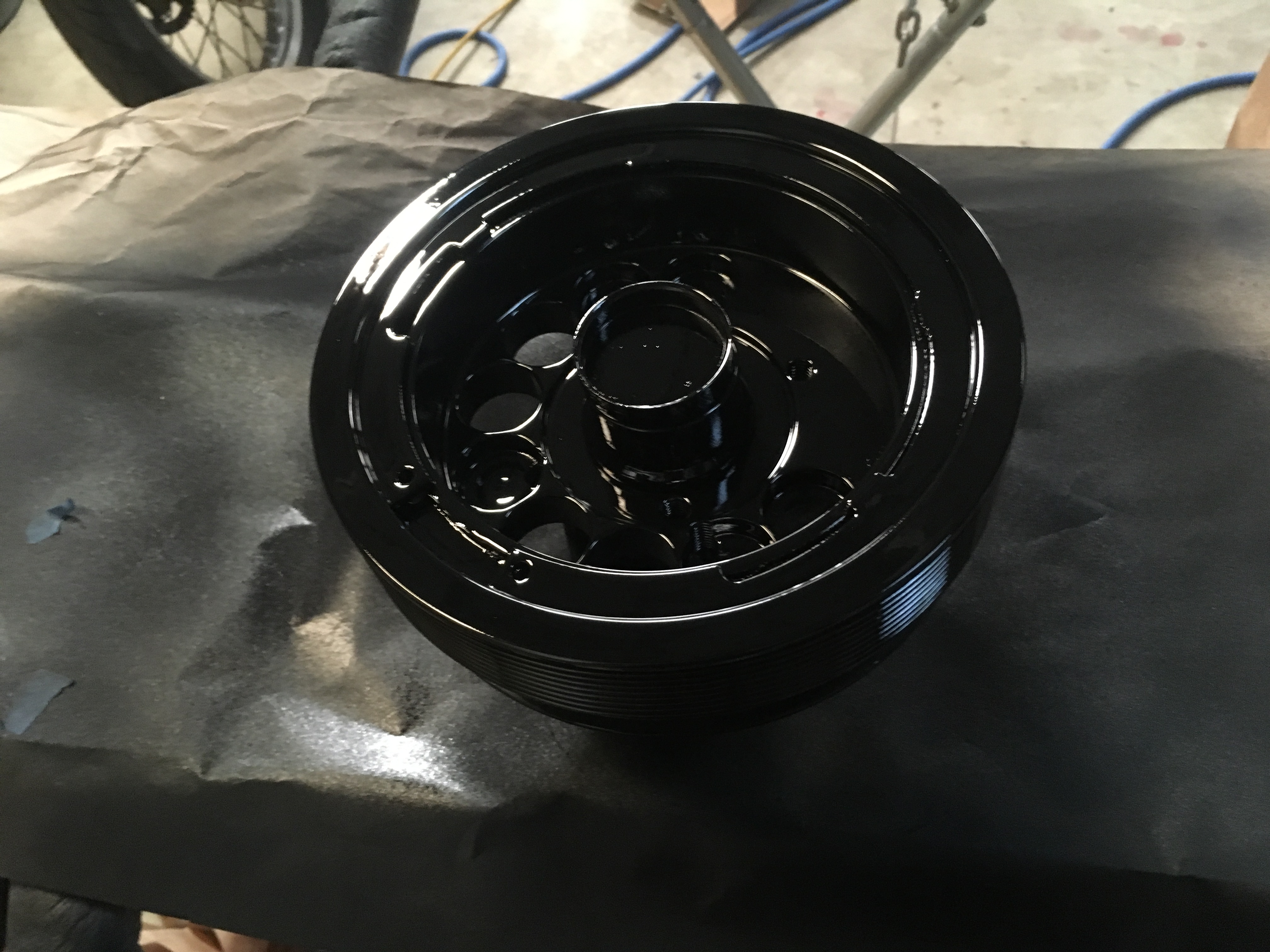

The shit $2 shop paint on the very expensive race balancer was pissing me off with its flaking and rusting, not even seen the light of day.
So I fixed that and made it look and be the quality of the other pulleys.
Bettera!
And installed, looks at home now.

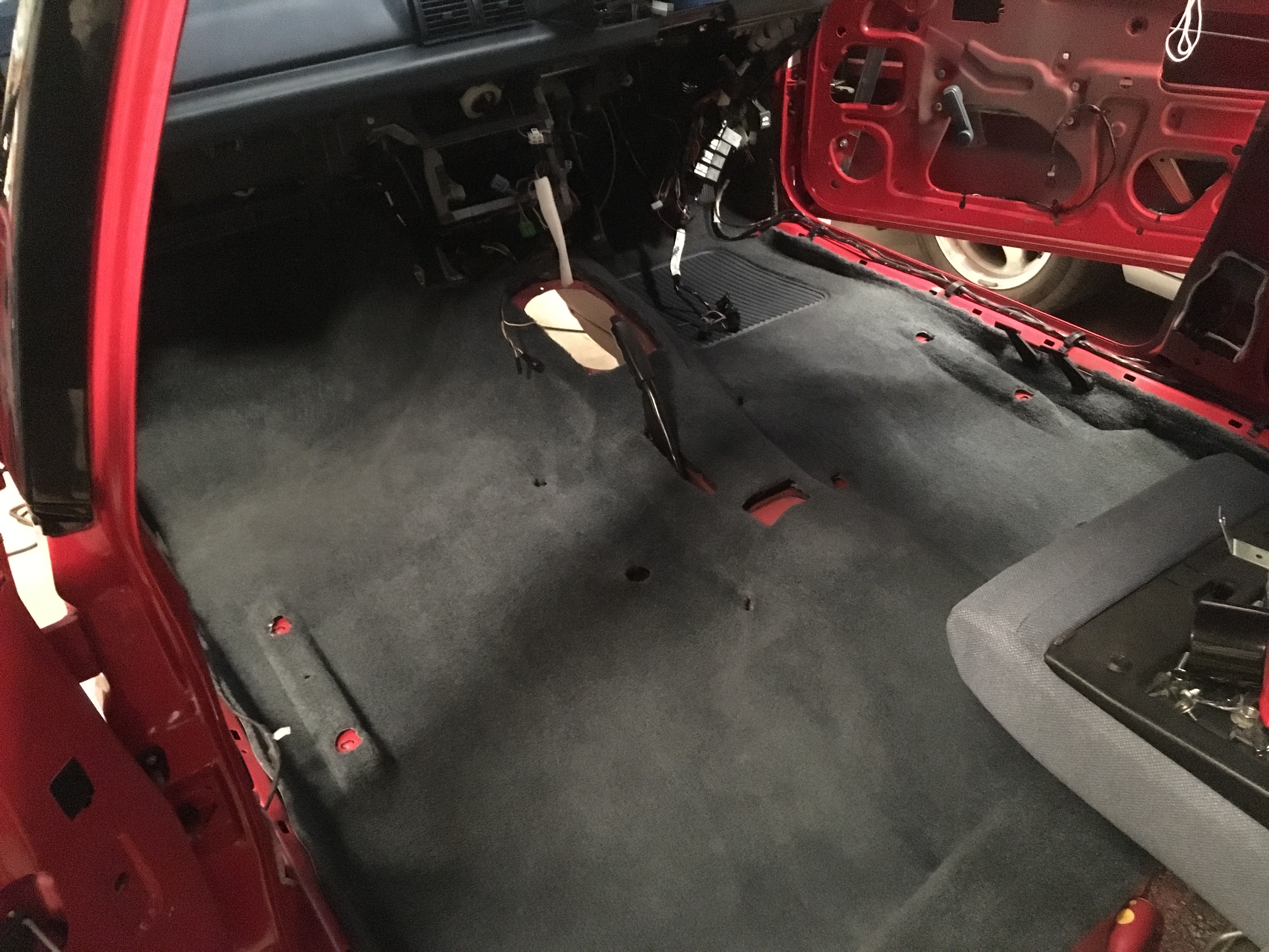

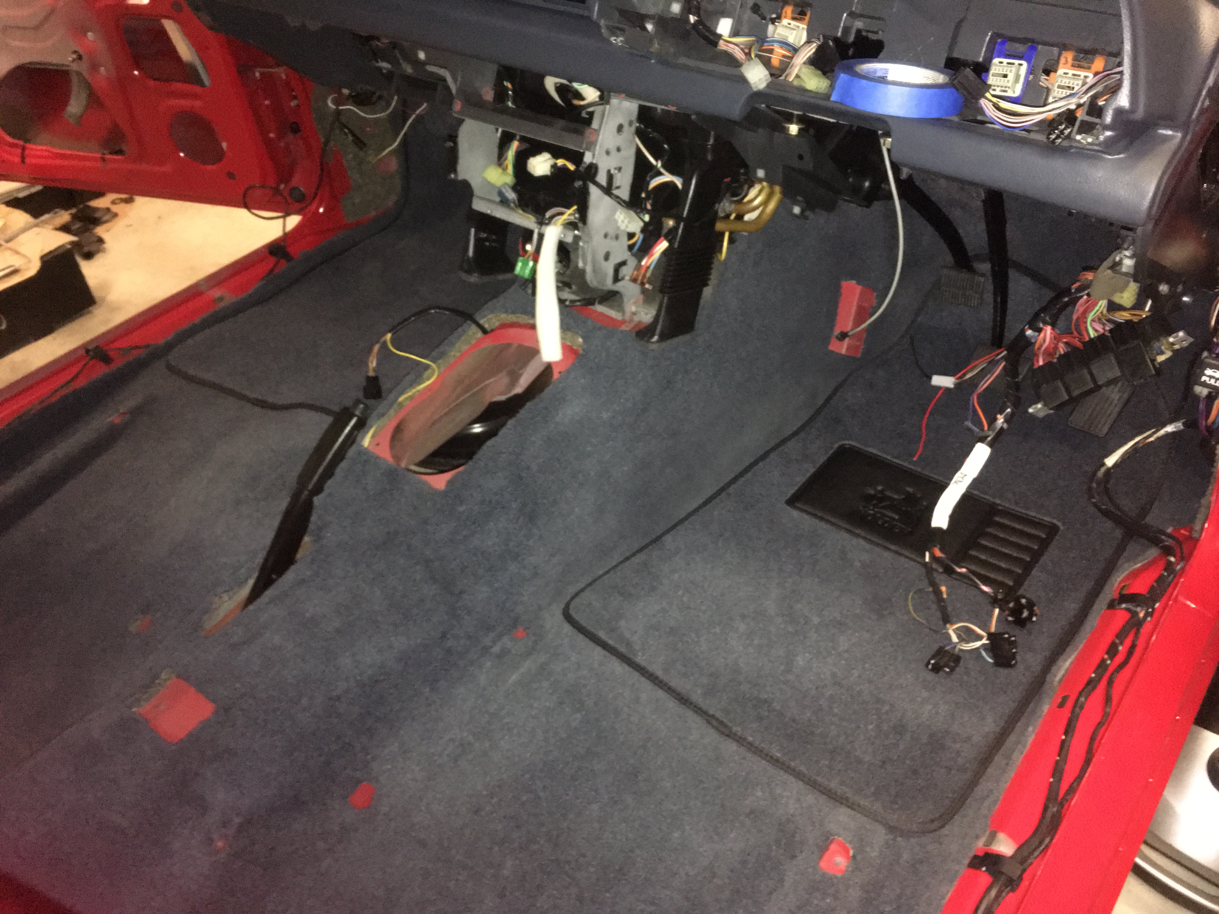

Carpet in
Bettera!

Carpet in
- Posts: 8124
Even more
with NOS matching VP mats.

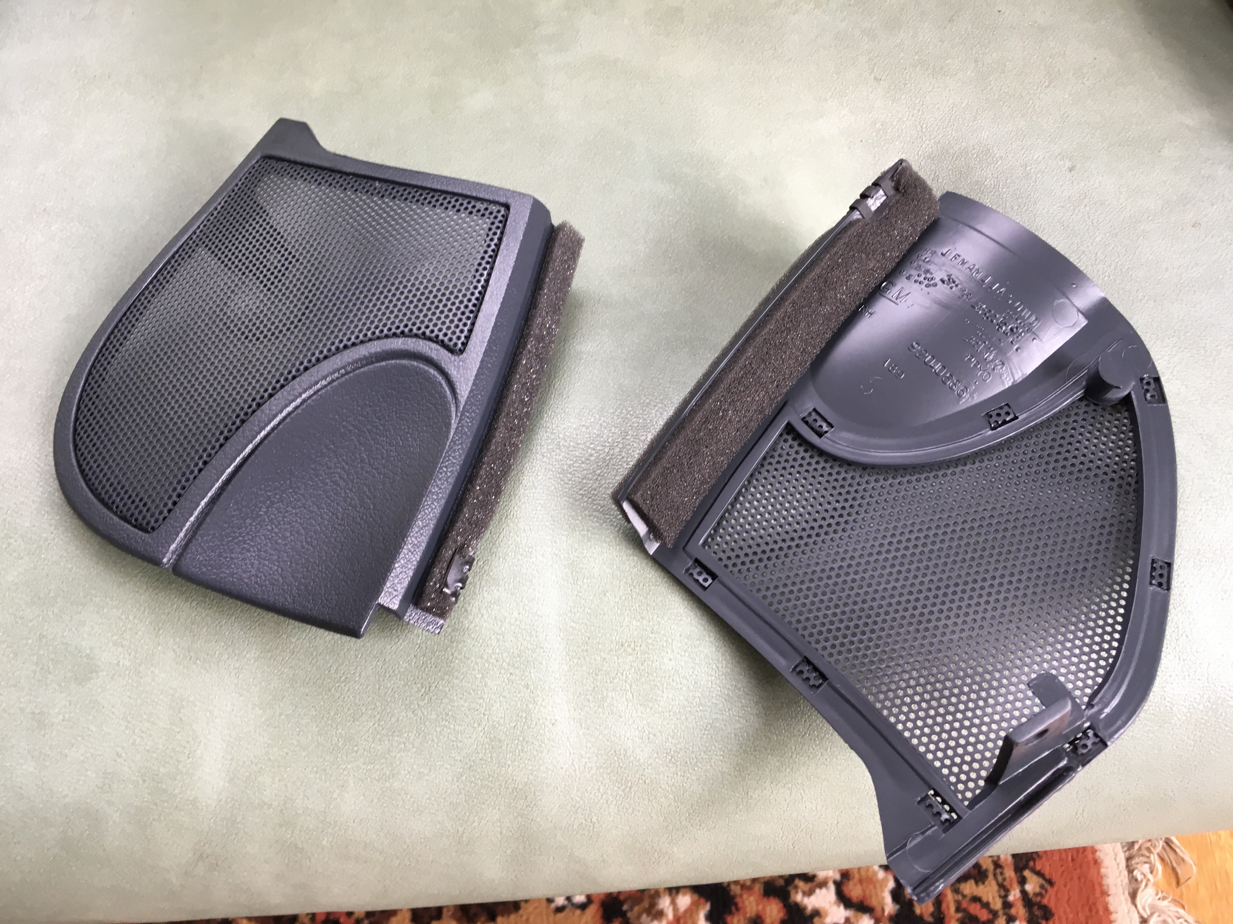

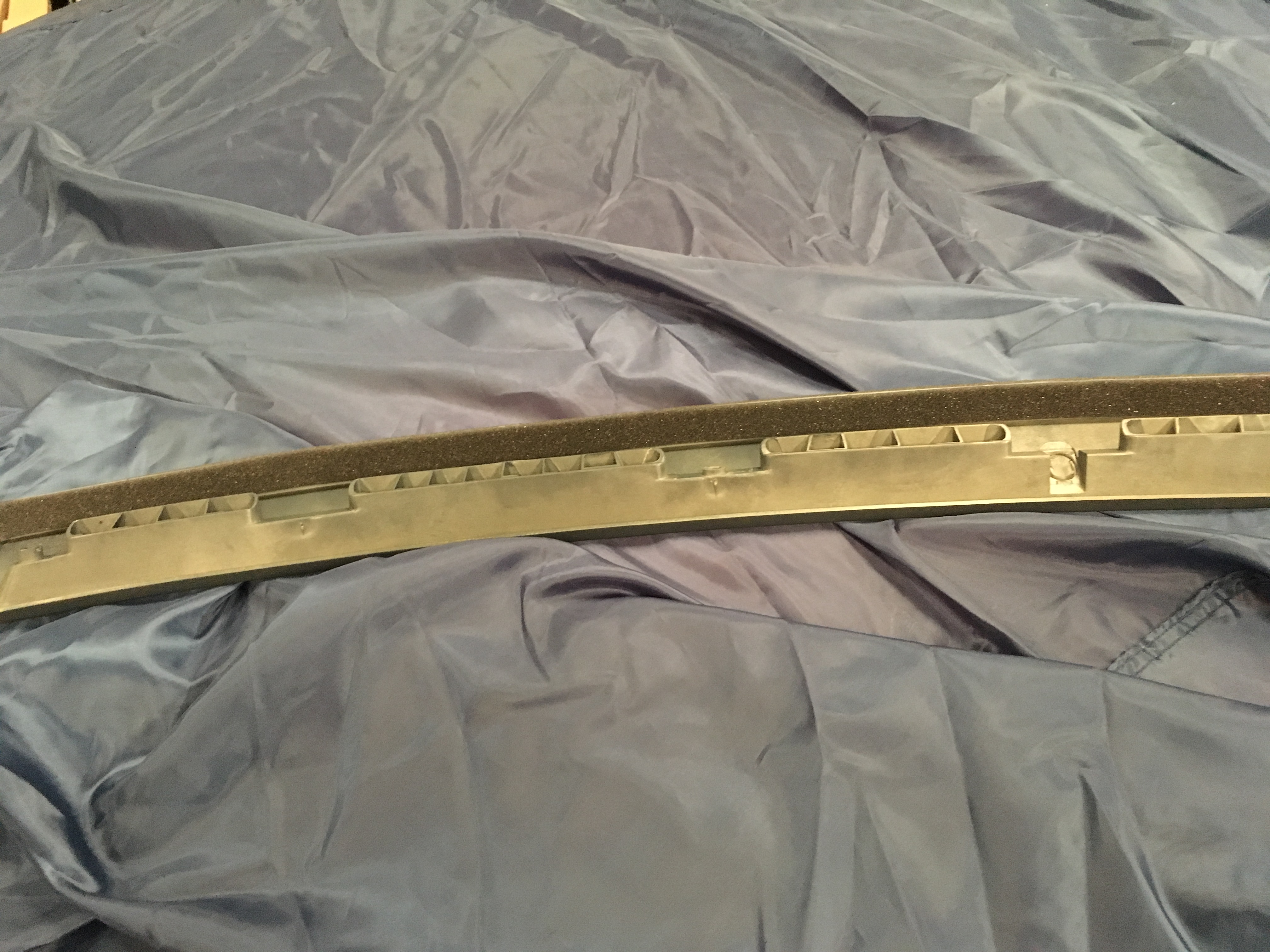

Then I sorted the vent trim foam edging.
Finally found the speaker grilles from this actual car, they were in the box I already looked twice lol, they were much better than the ones I first restored, only one needed the screw hole tab repaired at the bottom edge of the hole, cleaning up, some primer on one of the grille's mesh and 2 coats of custom dye, foam tape and the retaining clip put back on.

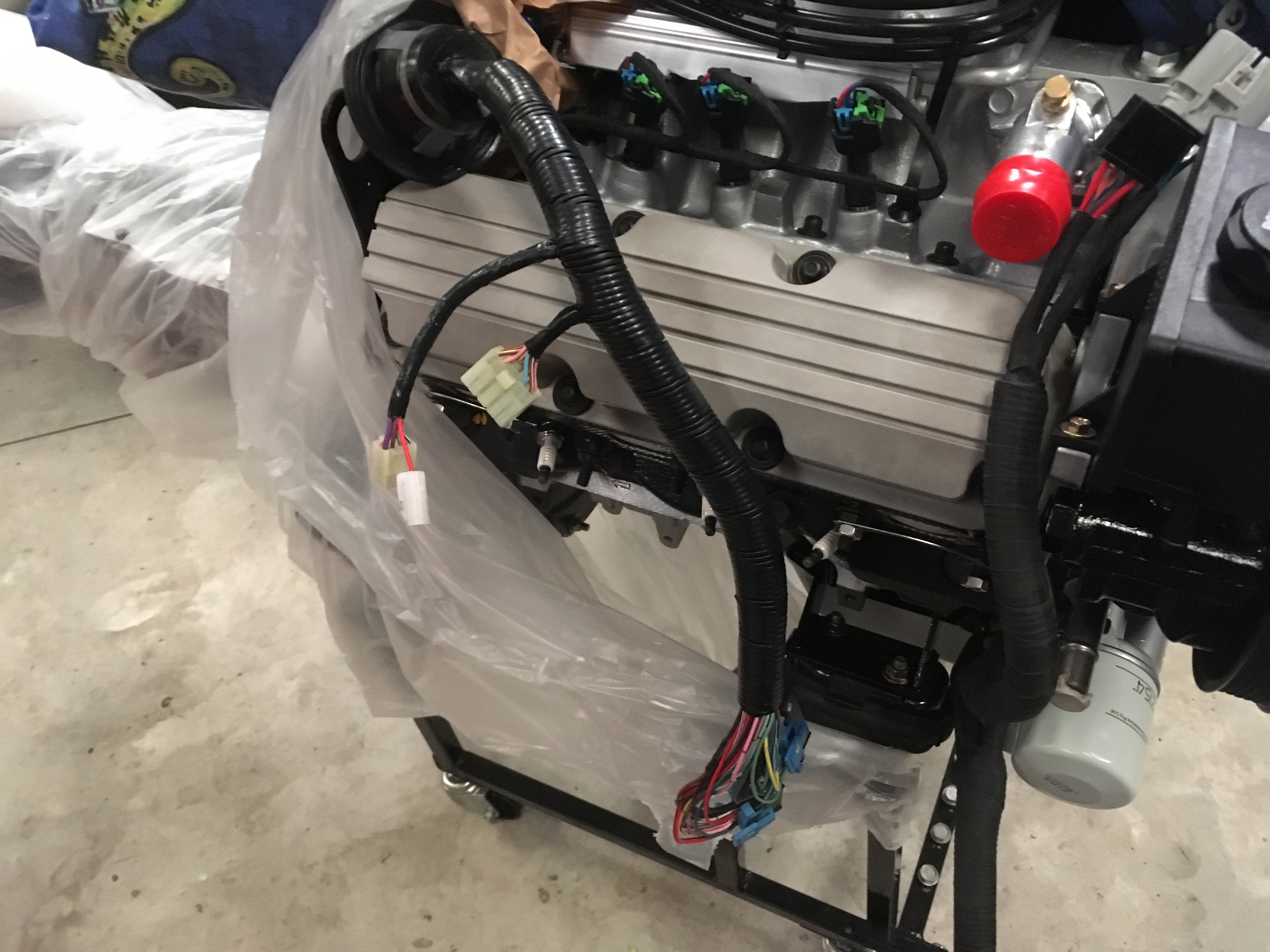

Then the last thing was to finish off the ECU end of the conduit and tidy that up, finish off the data connector and call it done!

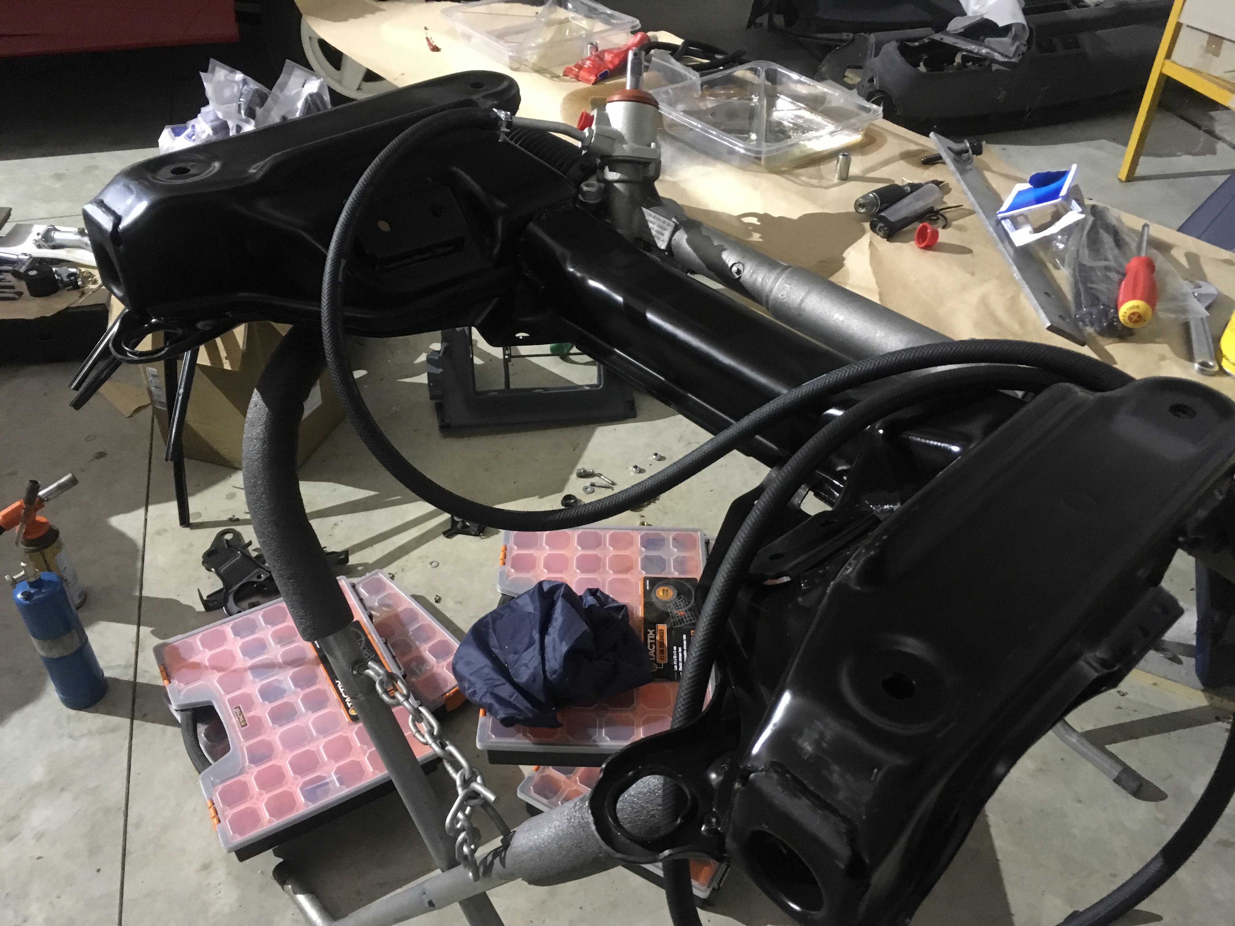

Also today I cleaned up the k-frame and installed the rack on it with return line.
This will meet the engine/trans halfway in the car so I can install the extractors with relative ease, not possible to install them onces the frame and engines are installed.

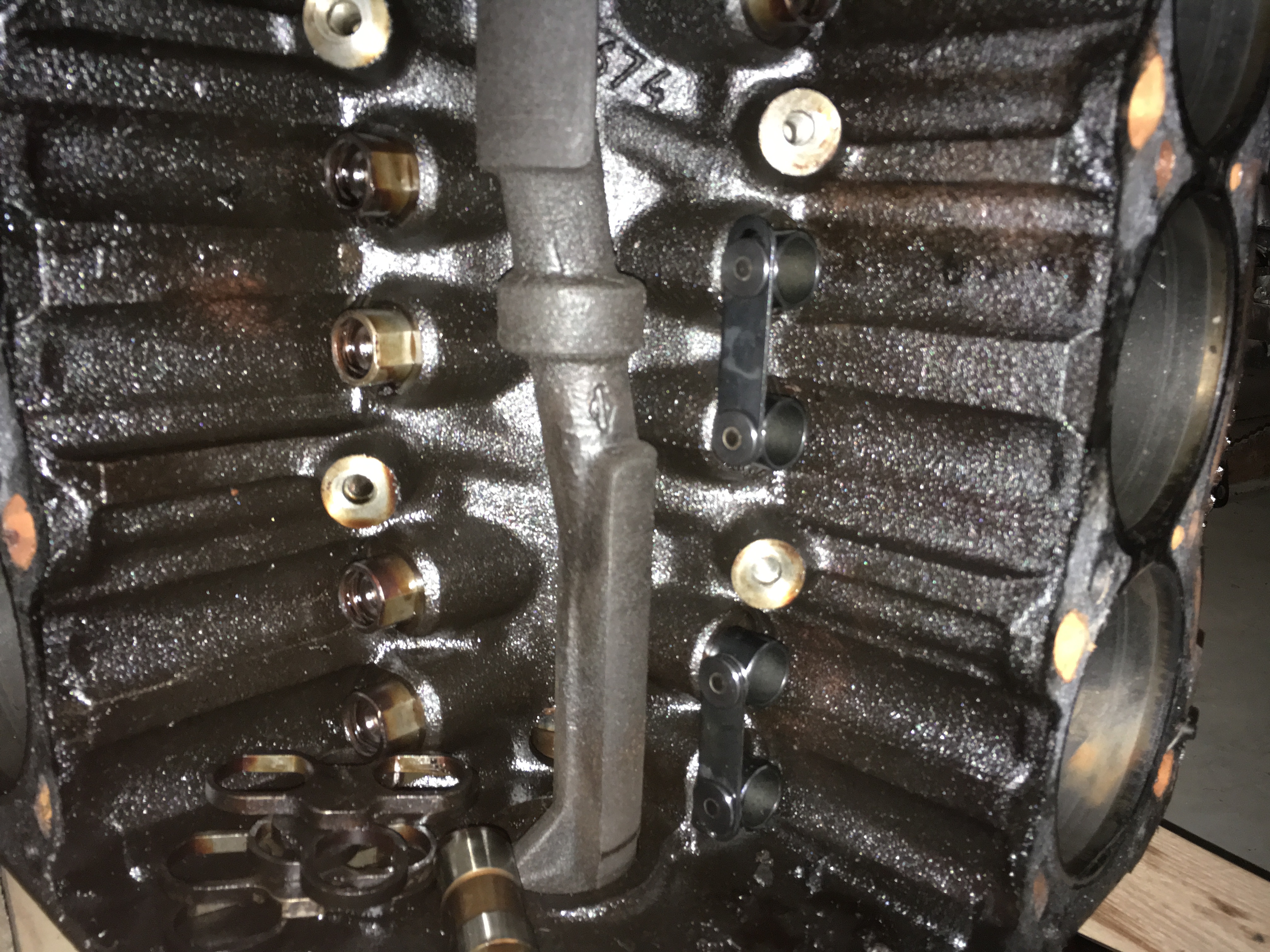

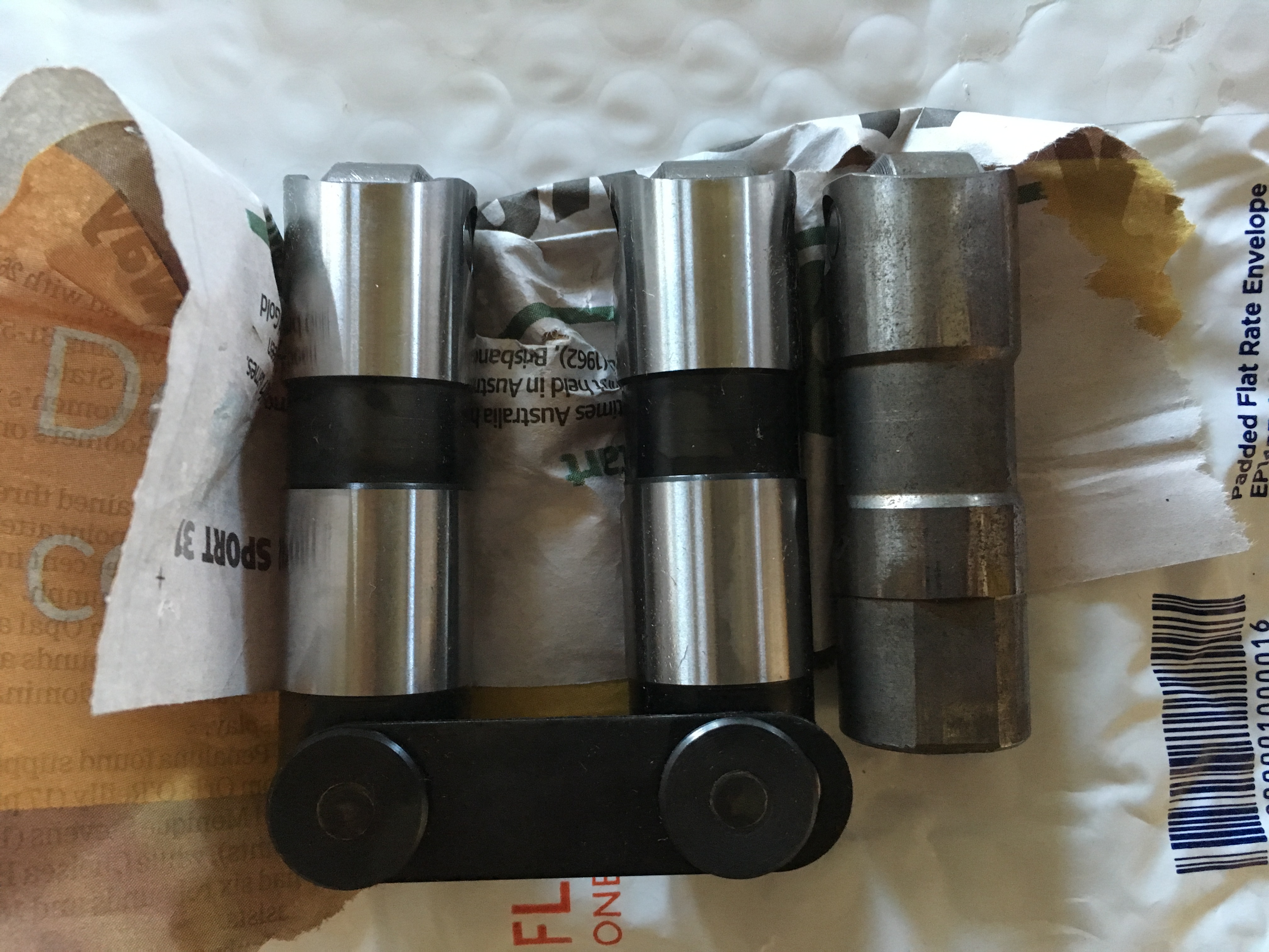

These turned up yesterday.
Custom short travel, slow bleed, tie bar roller lifters by Johnson to suit Buick. Also have another set coming for G and his ecotec.
As seen the Buick set has long and short tie bars as they have odd lifter bore centers from middle pairs to outer pairs. Ecotec have all equal centers which as the same as the longer ones in this set.
And they fit!

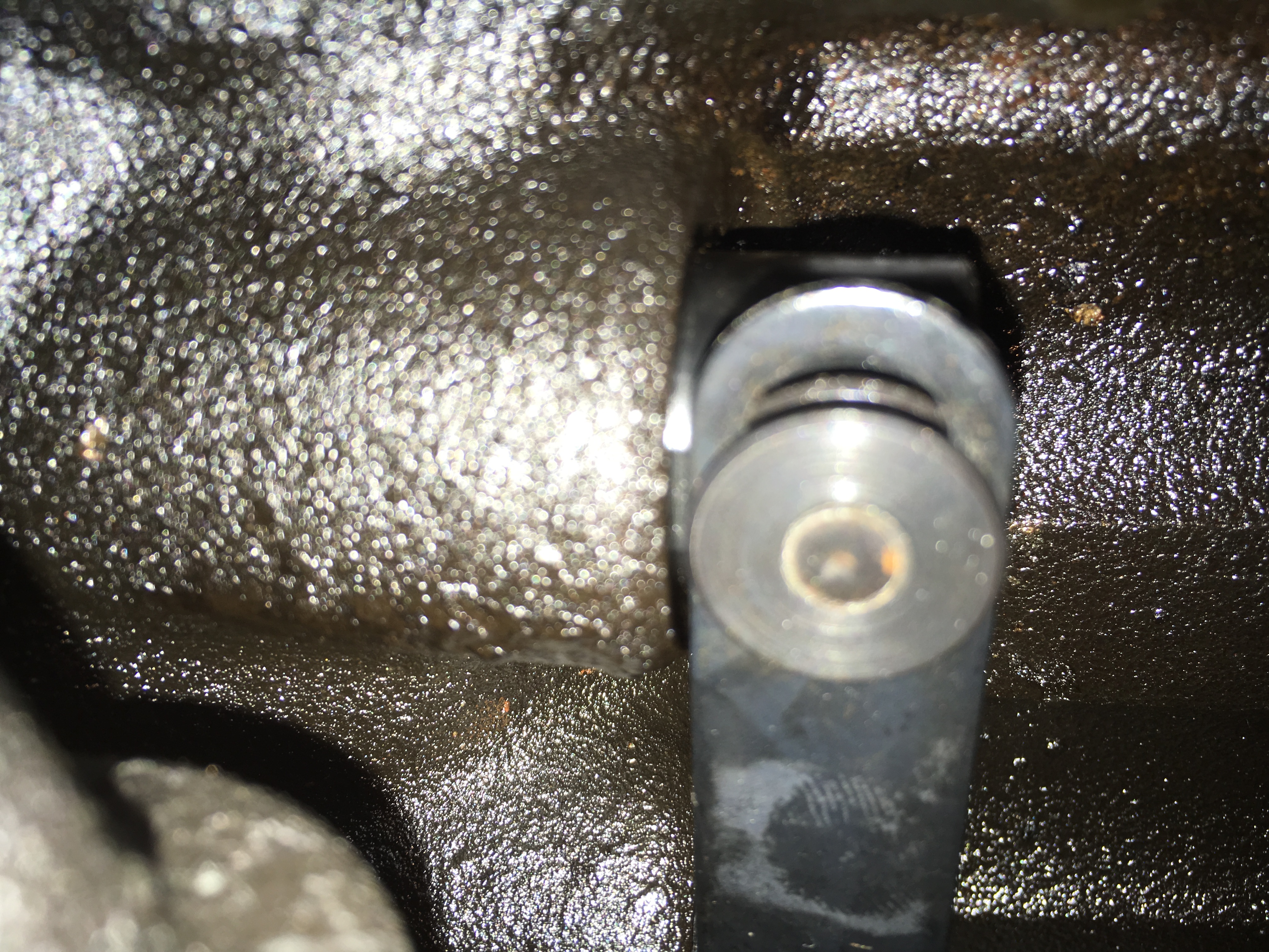

as calculated they have about 40 thou clearance on stock base circle, so they should work even with my custom cam for the next engine but I probably will have the front edge of the lifter bores machined to add clearance to be sure.
This is not an issue with ecotec as they have slightly shallower bores giving an extra 1-1.5mm from memory to those tie bars so they should work with just about any cam.
And they fit!

That balancer is not NOS or OEM....
Looks good though and a much better piece than OEM.
- Posts: 8124
yeah I needed a heavier more robust balancer to deal with the increases RPM and abuse.
Its SFI 18.1 ? race spec and cost a bomb. They could of put better paint on it but of course it was shit and ended up rusting after a few months.
Of course ! What the fuck were they thinking lmfaovlad01 wrote:yeah I needed a heavier more robust balancer to deal with the increases RPM and abuse.
