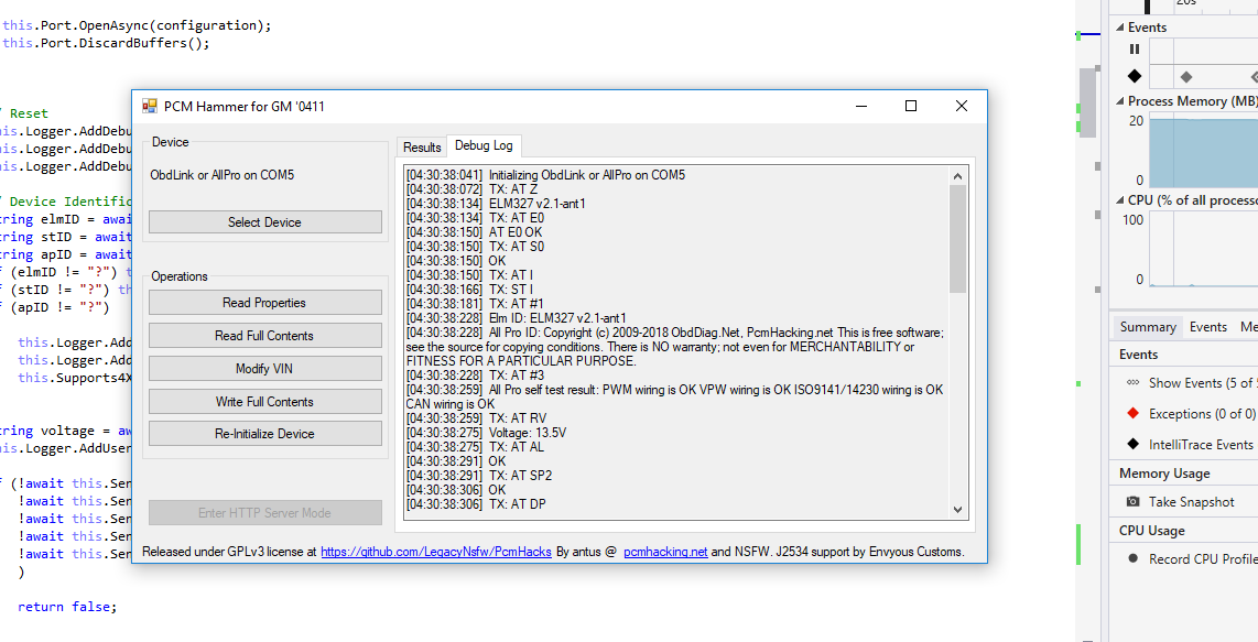

The odbdiag.net allpro http://www.obddiag.net/allpro.html is working at 4x with 128 byte packets now, which is sufficient. The USB variant is recmmended. Alex (obddiag.net) has said he will accept a merge. Ive got a different RX led pin configured in my branch because ive got an older hardware board. Im also not sure of the upper packet size limit and want to make sure that is sain before sending the merge request. If you want to try it, see https://github.com/antuspcm/allpro/tree/4xj1850 . The code should end up in master soon, then all allpros should have the support needed out of the box.
The app is looking decent too. The AVT support is behind, and the J2534 doesnt have 4x, but the foundations are starting to look pretty solid.
[04:26:54:417]  Initializing ObdLink or AllPro on COM5
[04:26:54:464]  TX: AT Z
[04:26:54:542]  ELM327 v2.1-ant1
[04:26:54:542]  TX: AT E0
[04:26:54:558]  AT E0 OK
[04:26:54:558]  TX: AT S0
[04:26:54:573]  OK
[04:26:54:573]  TX: AT I
[04:26:54:620]  TX: ST I
[04:26:54:636]  TX: AT #1
[04:26:54:683]  Elm ID: ELM327 v2.1-ant1
[04:26:54:698]  All Pro ID: Copyright (c) 2009-2018 ObdDiag.Net, PcmHacking.net This is free software; see the source for copying conditions. There is NO warranty; not even for MERCHANTABILITY or FITNESS FOR A PARTICULAR PURPOSE.
[04:26:54:698]  TX: AT #3
[04:26:54:730]  All Pro self test result: PWM wiring is OK VPW wiring is OK ISO9141/14230 wiring is OK CAN wiring is OK
[04:26:54:730]  TX: AT RV
[04:26:54:745]  Voltage: 13.5V
[04:26:54:745]  TX: AT AL
[04:26:54:761]  OK
[04:26:54:761]  TX: AT SP2
[04:26:54:777]  OK
[04:26:54:777]  TX: AT DP
[04:26:54:792]  SAE J1850 VPW
[04:26:54:792]  TX: AT AR
[04:26:54:808]  OK
[04:26:54:808]  TX: AT SR F0
[04:26:54:823]  OK
[04:26:59:042]  TX: AT SH 6C 10 F0
[04:26:59:058]  TX: 3C 01
[04:26:59:308]  RX: 6C F0 10 7C 01 00 36 48 38 56 54
[04:26:59:308]  TX: AT SH 6C 10 F0
[04:26:59:324]  TX: 3C 02
[04:26:59:558]  RX: 6C F0 10 7C 02 4B 36 39 46 58 4C
[04:26:59:574]  TX: AT SH 6C 10 F0
[04:26:59:574]  TX: 3C 03
[04:26:59:824]  RX: 6C F0 10 7C 03 34 37 38 37 35 37
[04:26:59:824]  VIN: 6H8VTK69FXL478757
[04:26:59:824]  TX: AT SH 6C 10 F0
[04:26:59:839]  TX: 3C 0A
[04:26:59:918]  RX: 6C F0 10 7C 0A 00 BA 8A 32
[04:26:59:918]  OS ID: 12225074
[04:26:59:933]  TX: AT SH 6C 10 F0
[04:26:59:949]  TX: 3C 08
[04:27:00:027]  RX: 6C F0 10 7C 08 05 7D 2A 69
[04:27:00:027]  Calibration ID: 92088937
[04:27:00:043]  TX: AT SH 6C 10 F0
[04:27:00:043]  TX: 3C 04
[04:27:00:136]  RX: 6C F0 10 7C 04 00 F7 81 C2
[04:27:00:136]  Hardware ID: 16220610
[04:27:00:152]  TX: AT SH 6C 10 F0
[04:27:00:168]  TX: 3C 05
[04:27:00:246]  RX: 6C F0 10 7C 05 32 44 47 30
[04:27:00:261]  TX: AT SH 6C 10 F0
[04:27:00:261]  TX: 3C 06
[04:27:00:339]  RX: 6C F0 10 7C 06 48 30 4C 36
[04:27:00:355]  TX: AT SH 6C 10 F0
[04:27:00:355]  TX: 3C 07
[04:27:00:433]  RX: 6C F0 10 7C 07 39 31 36 39
[04:27:00:449]  Serial Number: 2DG0H0L69169
[04:27:00:449]  TX: AT SH 6C 10 F0
[04:27:00:464]  TX: 3C 14
[04:27:00:543]  RX: 6C F0 10 7C 14 43 52 55 4D
[04:27:00:543]  Broad Cast Code: CRUM
[04:27:00:543]  TX: AT SH 6C 10 F0
[04:27:00:558]  TX: 3C A0
[04:27:00:652]  RX: 6C F0 10 7C A0 00
[04:27:00:652]  MEC: 0
[04:27:01:589]  TX: AT SH 6C 10 F0
[04:27:01:605]  TX: 27 01
[04:27:01:683]  RX: 6C F0 10 67 01 4F 99
[04:27:01:683]  TX: AT SH 6C 10 F0
[04:27:01:699]  TX: 27 02 F9 FE
[04:27:01:777]  RX: 6C F0 10 67 02 34
[04:27:01:777]  PCM Unlocked
[04:27:01:793]  Unlock succeeded.
[04:27:01:793]  This interface does support VPW 4x
[04:27:01:793]  TX: AT SH 6C FE F0
[04:27:01:808]  TX: A0
[04:27:01:886]  RX: 6C F0 FE E0 AA
[04:27:01:886]  PCM is allowing a switch to VPW 4x
[04:27:01:902]  Asking PCM to swtich to VPW 4x
[04:27:01:902]  TX: AT SH 6C FE F0
[04:27:01:918]  TX: A1
[04:27:01:980]  SendMessage produced NO DATA
[04:27:01:996]  AllPro setting VPW 4X
[04:27:01:996]  TX: AT VPW4
[04:27:01:996]  OK
[04:27:02:027]  Loaded kernel.bin
[04:27:02:043]  Going to load a 919 byte payload to 0xFF9150
[04:27:02:043]  TX: AT SH 6C 10 F0
[04:27:02:058]  TX: 34 00 00 8A FF 94 5D
[04:27:02:152]  RX: 6C F0 10 74 00 44
[04:27:02:152]  TX: AT SH 6D 10 F0
[04:27:02:168]  TX: 36 00 00 8A FF 94 5D 10 00 01 67 00 00 0A 0C 28 00 FE 00 01 66 88 4E 75 13 FC 00 55 00 FF FA 27 13 FC 00 AA 00 FF FA 27 08 B9 00 07 00 FF D0 06 08 F9 00 07 00 FF D0 06 4E 75 61 00 FF DC 14 39 00 FF F6 0E 02 02 00 03 0C 02 00 03 67 EC 4E 75 28 63 29 32 30 31 33 20 41 6E 74 75 73 2F 50 43 4D 48 61 63 6B 69 6E 67 2E 6E 65 74 01 00 00 00 00 00 00 00 00 00 00 00 00 00 00 00 00 6C F0 10 60 6C F0 10 75 01 54 6C F0 10 36 00 00 00 00 00 00 28 B7
[04:27:02:308]  RX: 6D F0 10 76 00 73
[04:27:02:308]  TX: AT SH 6C 10 F0
[04:27:02:324]  TX: 34 00 00 8A FF 93 C7
[04:27:02:386]  RX: 6C F0 10 74 00 44
[04:27:02:386]  TX: AT SH 6D 10 F0
[04:27:02:402]  TX: 36 00 00 8A FF 93 C7 82 14 39 00 FF 94 E2 D2 82 14 39 00 FF 94 E3 D2 82 14 39 00 FF 94 E4 D2 82 14 39 00 FF 94 E5 D2 82 14 39 00 FF 94 E6 D2 82 4E 75 42 86 61 00 00 78 10 39 00 FF F6 0E 02 00 00 E0 0C 00 00 40 67 00 00 10 52 86 0C 86 00 30 00 00 67 00 FD E0 60 DC 20 7C 00 FF 94 C2 10 F9 00 FF F6 0F 61 00 00 48 10 39 00 FF F6 0E 02 00 00 E0 0C 00 00 40 66 00 00 10 52 86 0C 86 00 30 00 00 67 00 FD B0 60 D6 10 F9 00 FF F6 0F 20 7C 00 36 70
[04:27:02:543]  RX: 6D F0 10 76 00 73
[04:27:02:543]  TX: AT SH 6C 10 F0
[04:27:02:558]  TX: 34 00 00 8A FF 93 31
[04:27:02:621]  RX: 6C F0 10 74 00 44
[04:27:02:621]  TX: AT SH 6D 10 F0
[04:27:02:636]  TX: 36 00 00 8A FF 93 31 83 60 3A 61 00 01 38 13 FC 00 01 00 FF 94 E1 32 00 13 C1 00 FF 94 E3 E0 89 13 C1 00 FF 94 E2 4E BA 00 46 4E BA 01 3A 13 FC 00 04 00 FF F6 0C 13 D0 00 FF F6 0D 14 18 D2 42 51 C8 FF E8 20 01 E0 88 4E BA 01 1C 13 FC 00 04 00 FF F6 0C 13 C0 00 FF F6 0D 4E BA 01 0A 13 FC 00 0C 00 FF F6 0C 13 C1 00 FF F6 0D 4E 75 72 09 22 7C 00 FF 94 DD 13 FC 00 14 00 FF F6 0C 61 00 00 C4 13 D9 00 FF F6 0D 51 C9 FF F4 61 00 00 B6 53 3C 16
[04:27:02:777]  RX: 6D F0 10 76 00 73
[04:27:02:793]  TX: AT SH 6C 10 F0
[04:27:02:793]  TX: 34 00 00 8A FF 92 9B
[04:27:02:855]  RX: 6C F0 10 74 00 44
[04:27:02:871]  TX: AT SH 6D 10 F0
[04:27:02:871]  TX: 36 00 00 8A FF 92 9B E0 66 E8 10 39 00 FF F6 0F 4E 75 61 00 01 C6 22 08 2A 08 13 C1 00 FF 94 E6 E0 89 13 C1 00 FF 94 E5 E0 89 13 C1 00 FF 94 E4 42 83 42 84 22 48 16 18 42 82 61 00 01 9E 52 42 B5 FC 00 08 00 00 67 1A B5 FC 00 10 00 00 67 12 0C 82 00 00 FF FF 67 0A 18 18 B6 44 66 04 60 00 FF DA 20 49 0C 82 00 00 0A 00 65 00 00 34 13 FC 00 02 00 FF 94 E1 32 02 13 C1 00 FF 94 E3 E0 89 13 C1 00 FF 94 E2 4E BA 00 7C 4E BA 01 70 13 FC 00 37 42
[04:27:03:027]  RX: 6D F0 10 76 00 73
[04:27:03:027]  TX: AT SH 6C 10 F0
[04:27:03:043]  TX: 34 00 00 8A FF 92 05
[04:27:03:105]  RX: 6C F0 10 74 00 44
[04:27:03:105]  TX: AT SH 6D 10 F0
[04:27:03:121]  TX: 36 00 00 8A FF 92 05 00 FF AC 4E 70 60 FE 70 04 20 7C 00 FF 94 D7 61 00 00 34 42 80 80 39 00 FF 94 C9 E1 88 80 39 00 FF 94 CA E1 88 80 39 00 FF 94 CB 20 40 42 80 80 39 00 FF 94 C7 E1 88 80 39 00 FF 94 C8 61 00 00 62 60 00 FF 3E 61 00 02 22 13 FC 00 14 00 FF F6 0C 13 D8 00 FF F6 0D 61 00 FF 8C 51 C8 FF F4 13 FC 00 0C 00 FF F6 0C 13 D8 00 FF F6 0D 61 00 FF 76 13 FC 00 03 00 FF F6 0C 13 FC 00 00 00 FF F6 0D 61 00 01 E6 61 00 FF 5E 10 3E 85
[04:27:03:261]  RX: 6D F0 10 76 00 73
[04:27:03:261]  TX: AT SH 6C 10 F0
[04:27:03:277]  TX: 34 00 00 8A FF 91 6F
[04:27:03:355]  RX: 6C F0 10 74 00 44
[04:27:03:355]  TX: AT SH 6D 10 F0
[04:27:03:371]  TX: 36 00 00 8A FF 91 6F FF F6 0E 02 00 00 E0 0C 00 00 E0 66 E8 10 39 00 FF F6 0F 61 00 00 2E 61 00 02 6A 0C 39 00 35 00 FF 94 C5 67 00 00 78 0C 39 00 20 00 FF 94 C5 66 00 FF E6 20 7C 00 FF 94 D3 70 03 61 00 00 9E 61 00 00 44 2A 3C 00 00 27 10 61 00 02 B4 61 00 00 2C 61 00 00 28 61 00 00 24 61 00 00 20 61 00 00 1C 61 00 00 18 61 00 00 14 61 00 00 10 61 00 00 0C 61 00 00 08 51 CD FF D2 4E 75 4E 71 4E 71 4E 71 4E 71 4E 75 13 FC 00 40 00 28 65
[04:27:03:512]  RX: 6D F0 10 76 00 73
[04:27:03:512]  TX: AT SH 6C 10 F0
[04:27:03:527]  TX: 34 00 00 13 FF 91 50
[04:27:03:590]  RX: 6C F0 10 74 00 44
[04:27:03:605]  TX: AT SH 6D 10 F0
[04:27:03:605]  TX: 36 80 00 13 FF 91 50 61 00 00 98 13 FC 00 03 00 FF F6 0C 13 FC 00 00 00 FF F6 09 83
[04:27:03:683]  RX: 6D F0 10 76 00 73
[04:27:03:699]  kernel uploaded to PCM succesfully
