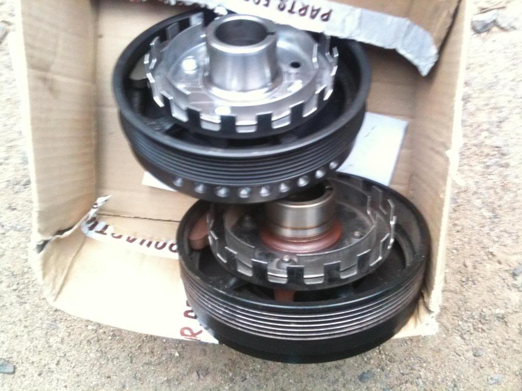

harmonic balancer was a shocker, miles out. something like 50g+ out.
see for yourself. Note the original one has the drillings on the complete opposite side to this newly balanced one so that shows how far out the new one was let alone the amount removed on it.
