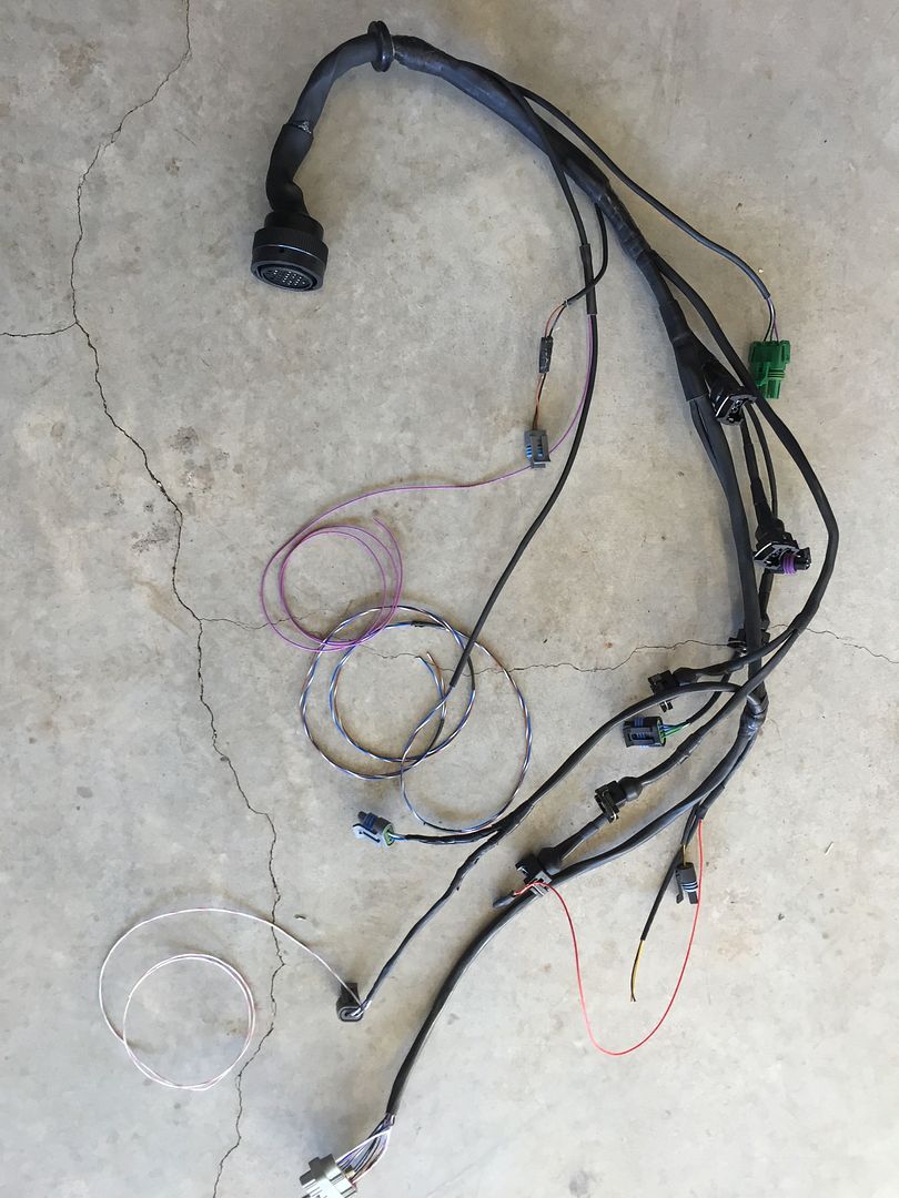

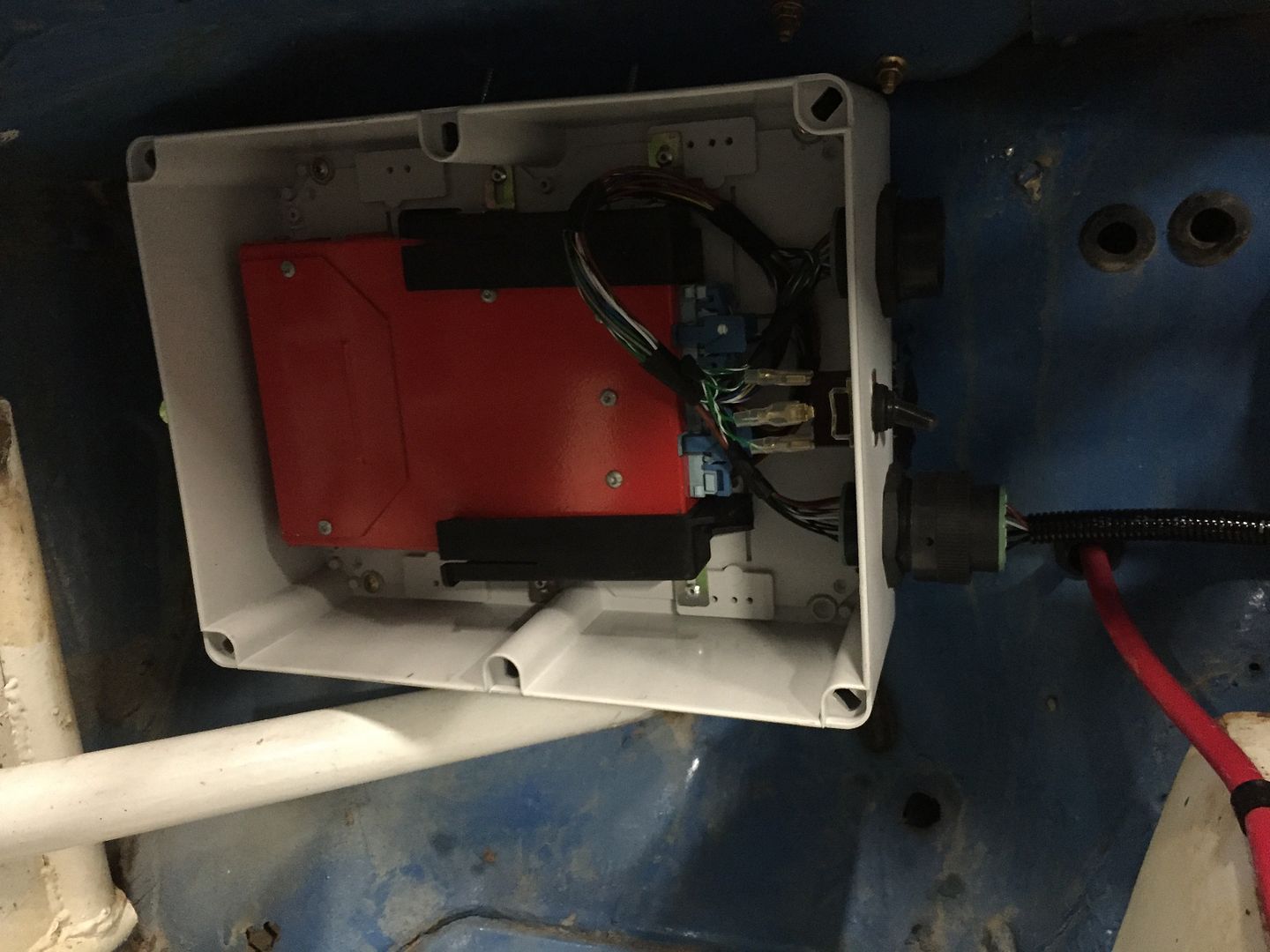

So ive been busy in the shed the last couple of days, managed to get the race car fully rewired, ecu is now impervious to dirt and water
This is the old engine harness
And the new 'almost mil spec' harness (limited by sensor connections) all exposed terminations are insulated buy dual wall heatshrink to prevent water entering the loom. Oh, and it only weighs 600gms
(compared to 1.76kgs)

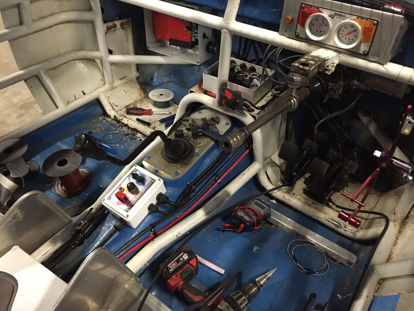

This has been my workspace for the last few days

Good job on the wiring. Did you make a new harness or re work the old one?
Do many guys go right out with there wiring on the race cars? Full mil spec harnesses?
I bet you see some VERY ruff wiring out there, I have.
Good news on the steering. How do you think you woud go on a road registered car fitting that up and keep an engineer happy? Any other race cars running that set up?
- Posts: 2678
Re: How to loose 200kgs?....
Thanks
Thats a brand new harness built using nothing but tefzel wire and almost all new connectors.
In speedway, the wiring is always crap, only higher end cars get this sort of treatment, i have the parts and the ability, so why not?
See much more bad than good with race car wiring, it seems the average enthusiast understands how to build and engine, but when it comes to harness and circuit design, most are lost...
Cant see it being much of an issue on a road car, only thing i can think of is the weight difference between the Barina and the car its going into.
Not around here, no.

It's good fun building new harnesses I love it. Where do you buy your tefzel and connectors from? Run shielded on anything?
