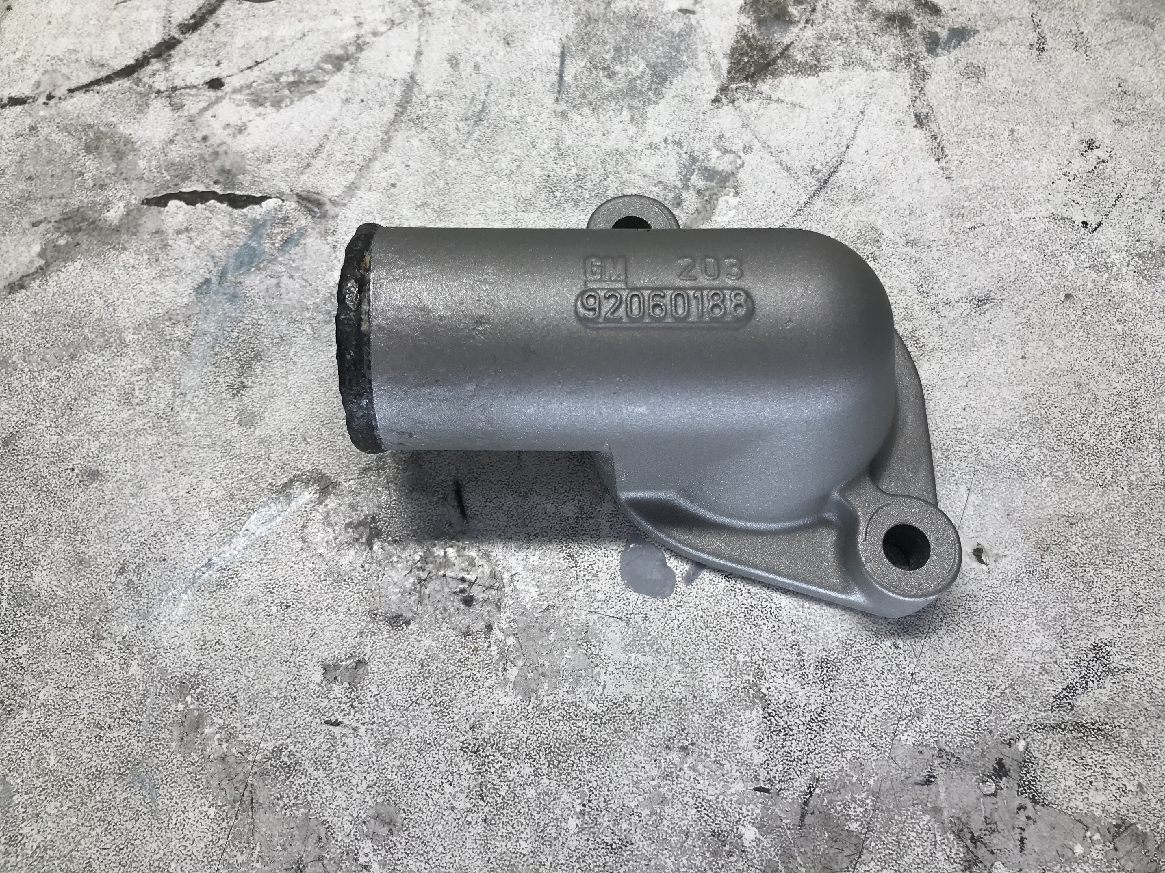

A few pages back I cleaned up the two-piece swivel thermostat housing and made it one-piece with some epoxy. It's not a bad unit but there's a design flaw with the recessed cap screw idea; the base material under them is too thin causing warping and leaking if you crank on them too much. They're also difficult to access. I should have welded it up and machined before painting it - I may still one day, definitely won't be throwing it away because this $70 part apparently now sells for $250!!
At any rate I had a genuine GM housing from a VN in good condition, these are better engineered with the bolt bosses being much thicker. Also cast a chunk of aluminium from some pieces of old piston and machined that up as a spacer to get the correct height. Made it the same shape as the earlier thermostat housing so I can use it if I ever change back, or want to drill the other port.
Fixed the colour and made up some shoulder bolts with slightly reduced size heads, fitted with a new top hose.

Interesting to notice the casting differences. Mine is early VN. I too looked at a new casting, but $250+ is taking the piss! Cleaned and painted it's ready to go again.

Is that 250 for a Kilkenny one? They absolutely take the piss for basic cast parts and are garbage quality as of the last several years in my opinion. See my builds thread on a KC housing brand new out of the packet and the issues I had to sort.
Re: Torana SS
I was talking about an aftermarket swivel one (Aeroflow is one of many suppliers) which is a replacement for pre-VN, but I don't doubt others are just as expensive.
Different castings are interesting, mine was from quite a late VN but possibly NZ assembled. Parts most likely come from multiple sources all over the place.
