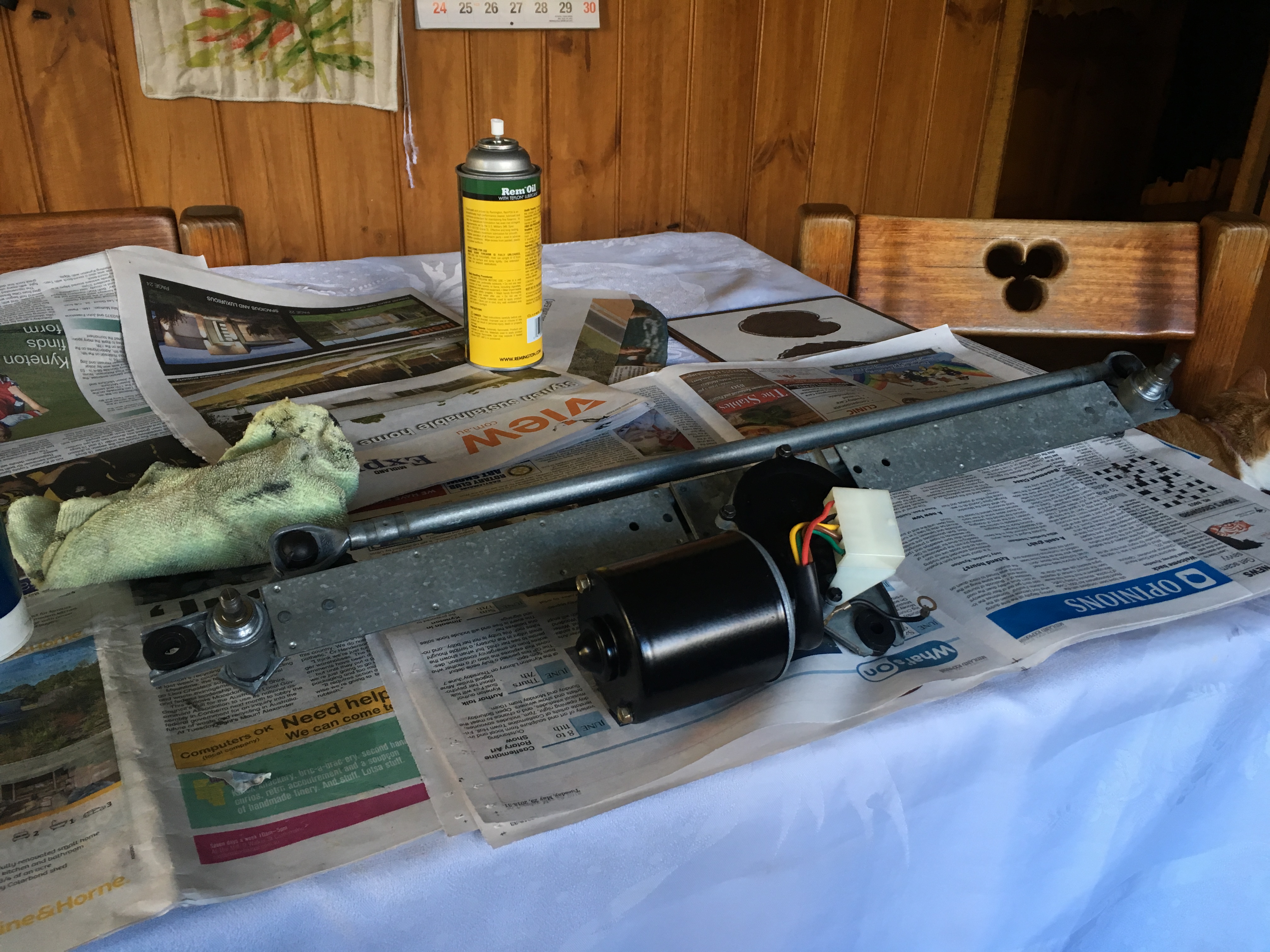

Rebuilt the windscreen wiper gear. Pulled everything apart except for the motor and gearbox, gave everything a clean and coat of rem oil as I have been doing for most stuff for the last 6 months, keeps it water resistant and stops any spontaneous corrosion as I normally get here with the high humidity in winter.
The shafts and joints all got new moly grease and the joints I replaced the stuffed foam seal rings with normal o-rings. They are there to act as a dust/dirt seal for the joints.
Everything moves as smooth as butter and looks a whole lot less crusty than it did before. I have already installed it in the car.
It's worth going over there as typically the motor/box comes loose from the main assembly as this one was no exception. This is typically what causes the ends of the wiper travel to drift, making accurate adjustments of the arms difficult.
I fixed this with use of serrated washers as there are no washers and a dab of loctite as well and done up real tight. I have had these come loose and the entire gearbox housing break apart from all the slamming around loose on the metal plate.
That's one more thing done from the list.

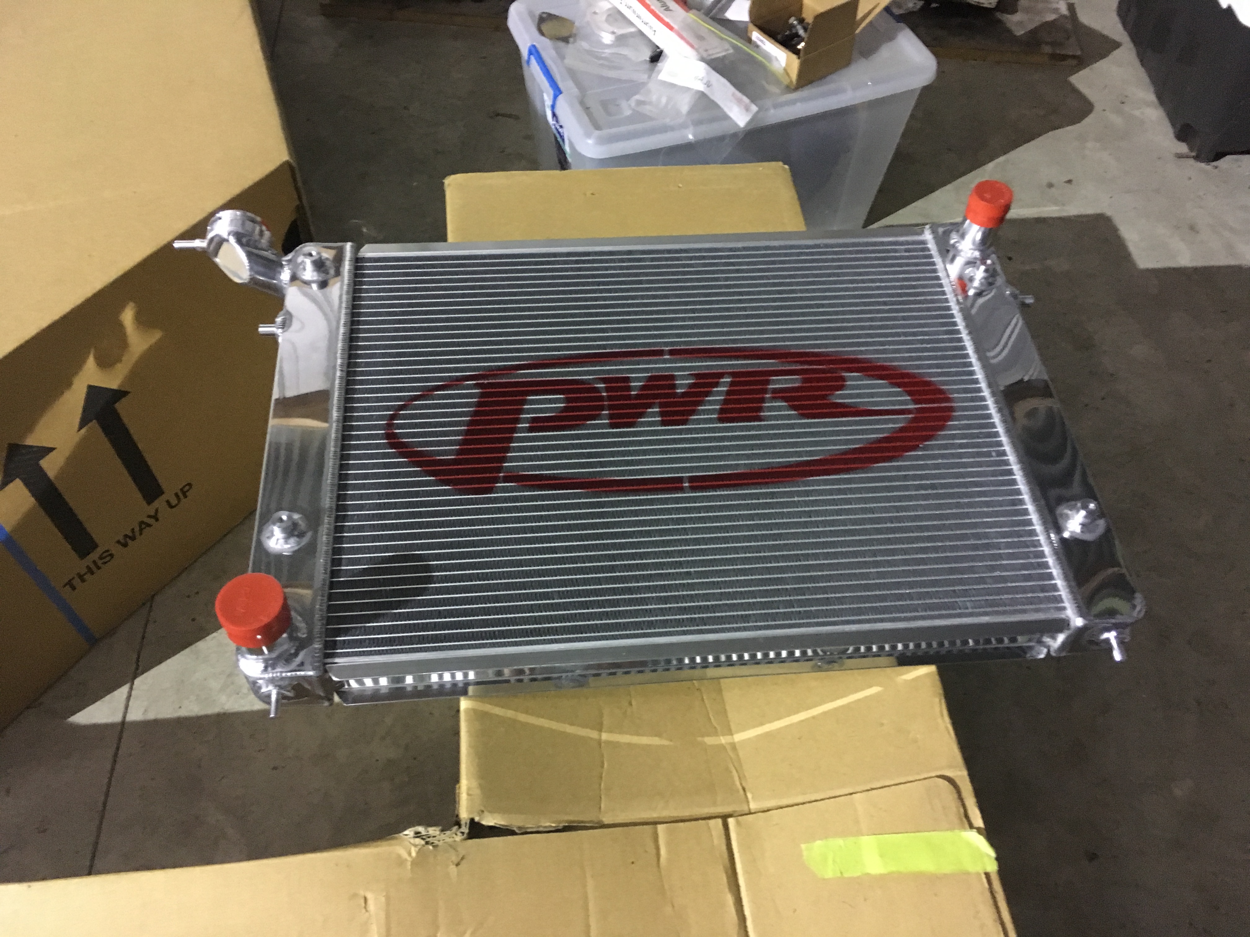

Radiator arrived as well as the seat belts.

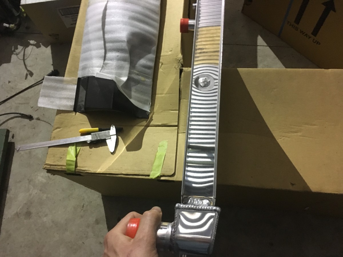

This revised design is damn good!
I underestimated how thick 42mm core would look. Wow certainly a lot thicker than the china OEM style radiators on offer. Can't get any thicker than about 25mm these days with 16-20 being the norm now. :shock: cutting it close to the limits considering 32mm was the original specs.

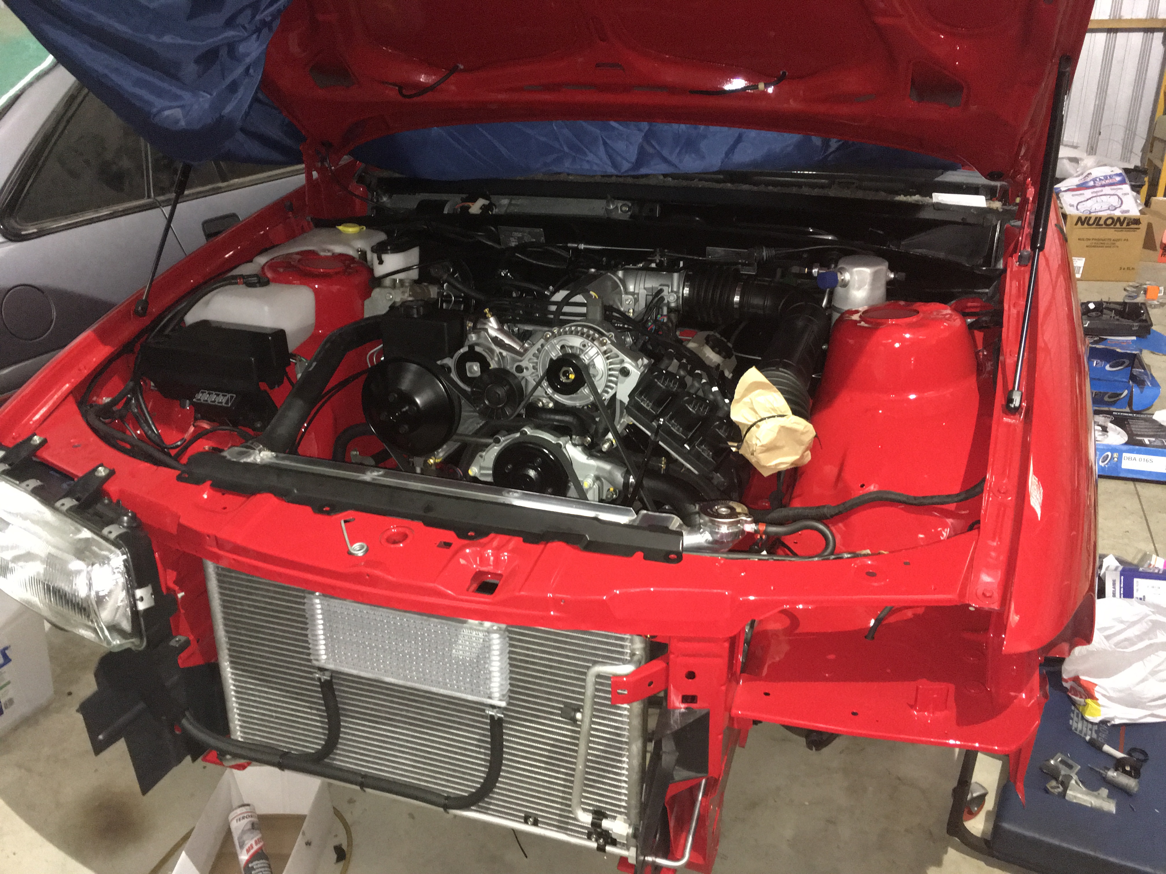

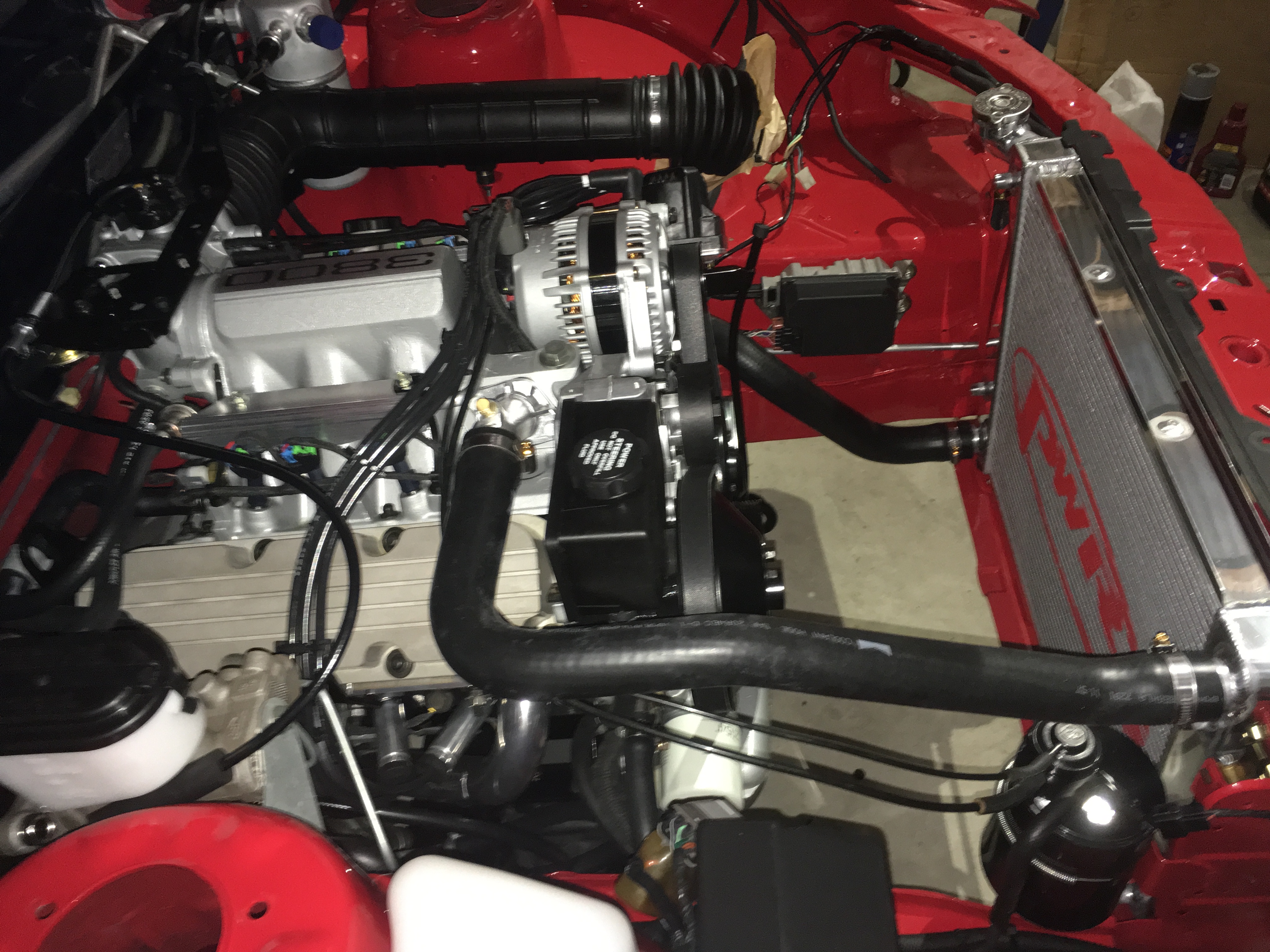

Shroud fits nice!
Installed and system filled with coolant. Also filled the engine with 5L of run in oil. Which happens to be about 10mm above full. It should end up on exactly the full mark once the engine is run and all the oiling system primes as its bone dry at the moment.
So the service fill should be the late VT and VX spec of 4.8L. Pretty awesome considering the dipstick was added in from a VR model to the sump. Win win! Marks end up lining up with existing dipstick and later model ecotec service volume :thumbup:
Still need to get a fan. Might just buy a new OEM aftermarket one, both my used fans aren't the best. Holmart has them for under $200.

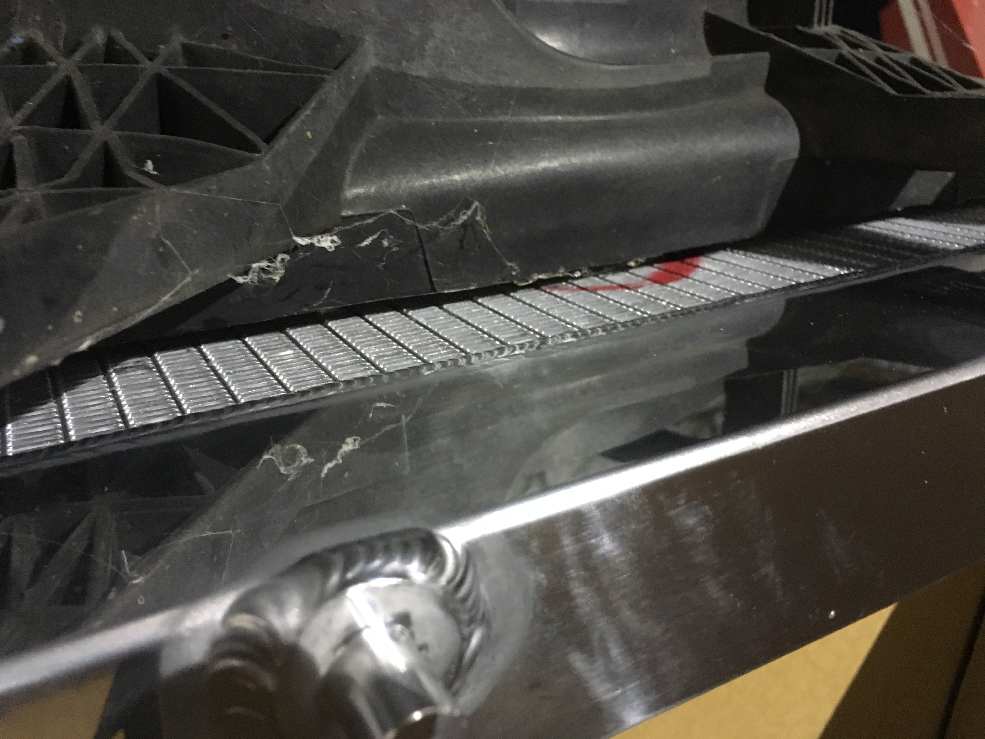

I'm not sure if you're aware or not but that fan shroud has a cob web on it, WTF?
yeah, hence why I am buying a new one. There is also a family of 10,000 spiders in the frame of the shroud.
Serious though, these are just scrap fans for mock up purposes.
