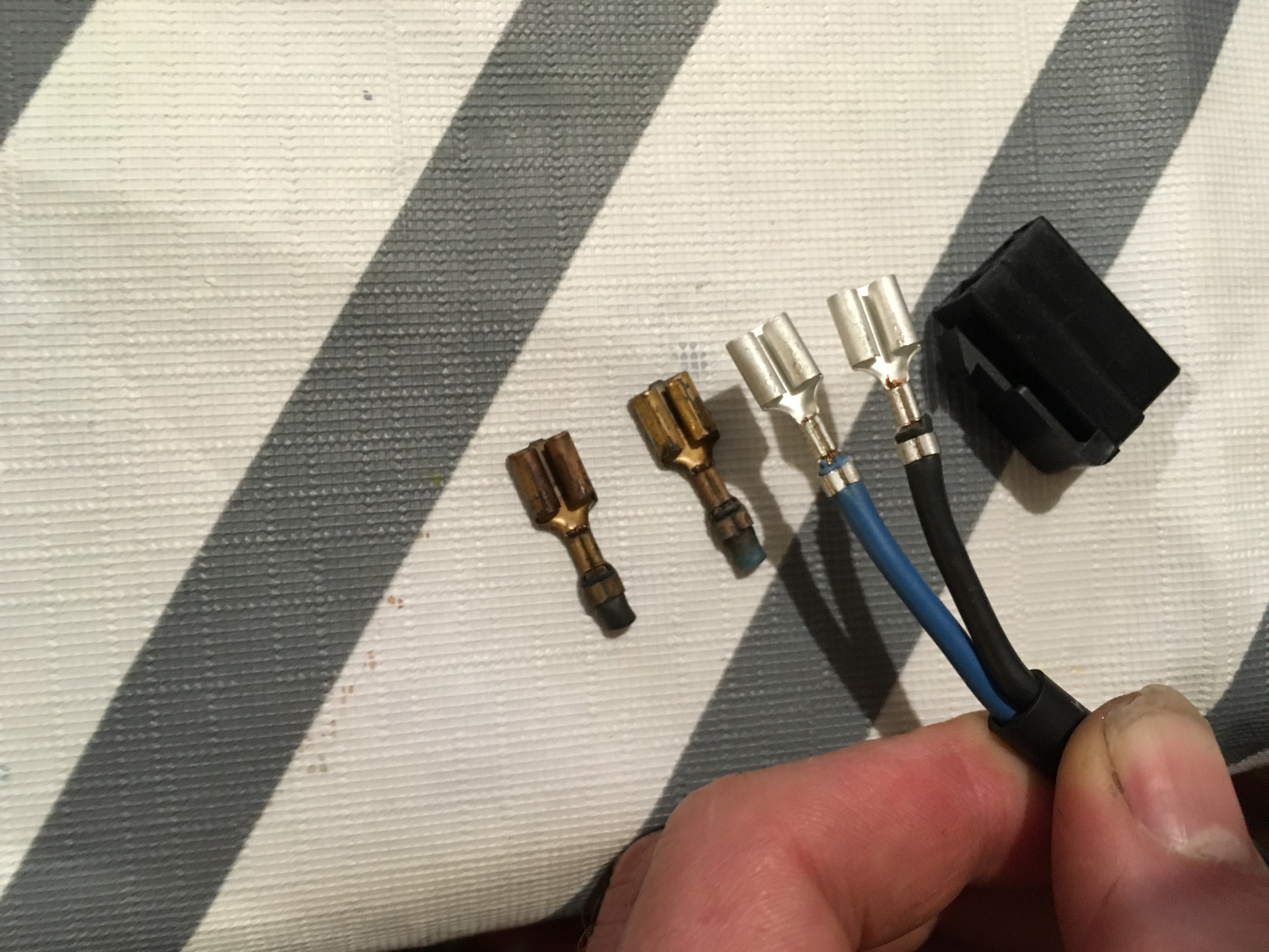

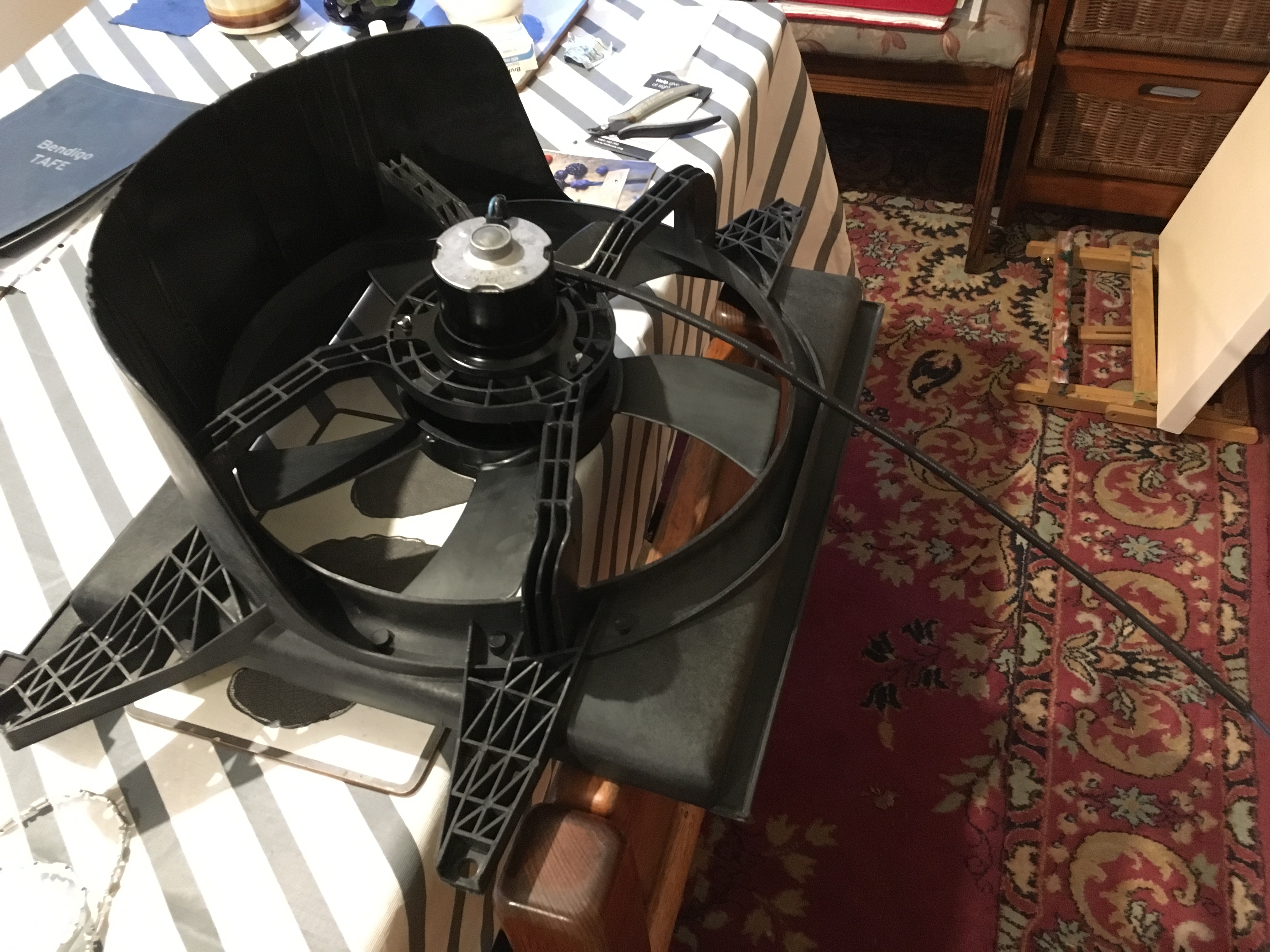

Couldn't get any new fans. Bunch of sellers listed them in stock and with heaps available. All bs, NLA
So I tidied one up from 2 shit ones. Luck I had the terminals too as there were very sad!
I also replaced the PVC sleeving with heat shrink as it all fell apart.

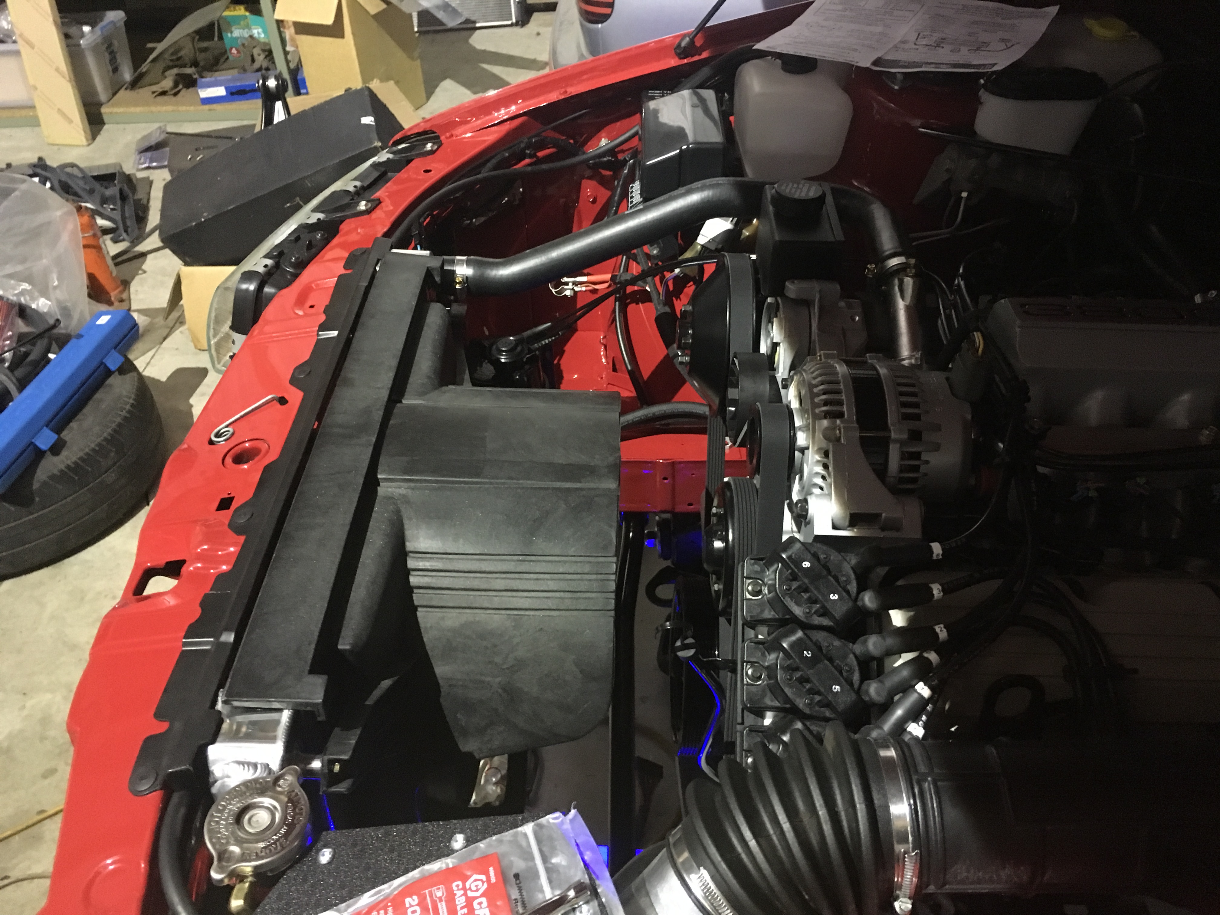

Engine bay is now practically done. Only battery to install and some cable ties to trim. Oh and need some pinch welt to suit the CAI box for the intake pipe to make it tighter and not rattle on the plastic.

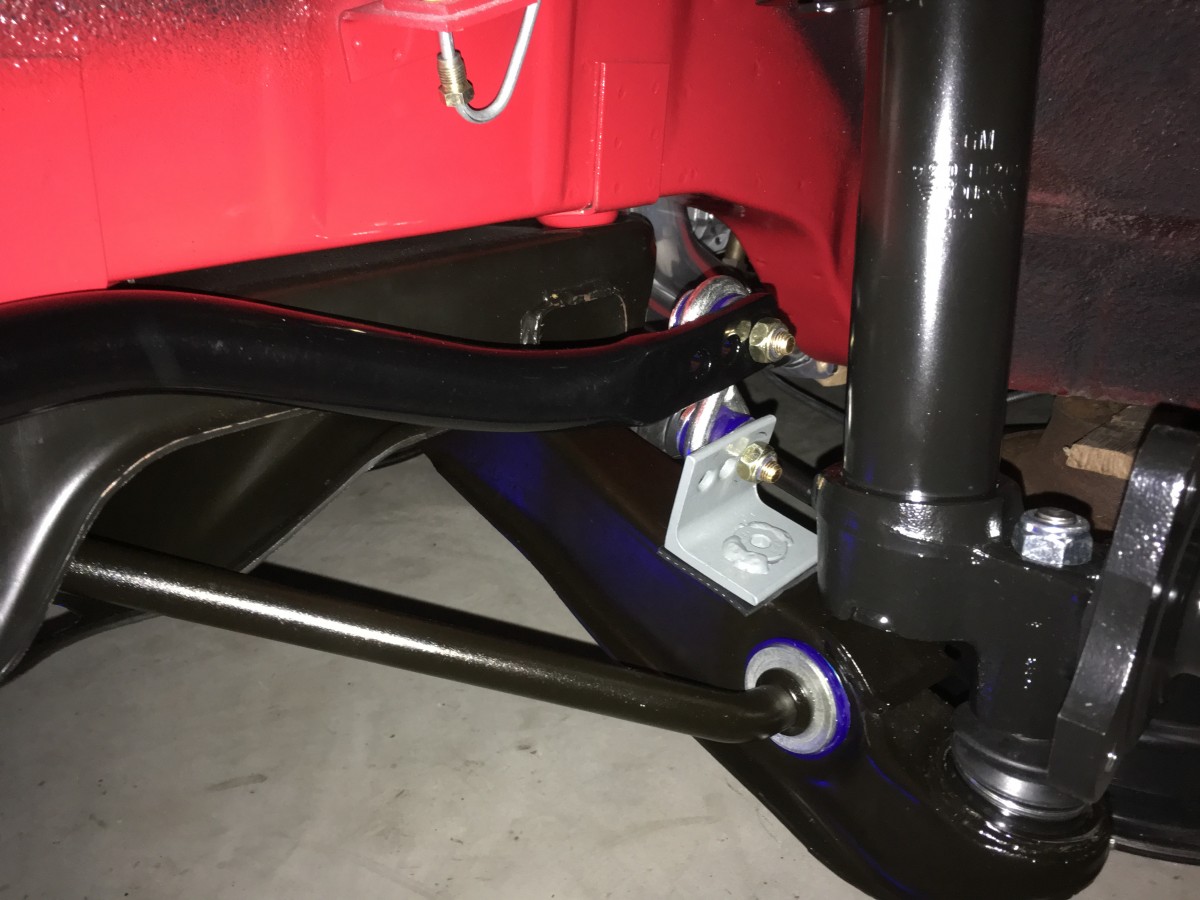

So that's how this goes. I had to get new fasteners as the included ones in the kit was all wrong, only the nylocs were correct.
All sorted now, also can see the rubber pad I made to make the bracket conform a lot better to the arm.

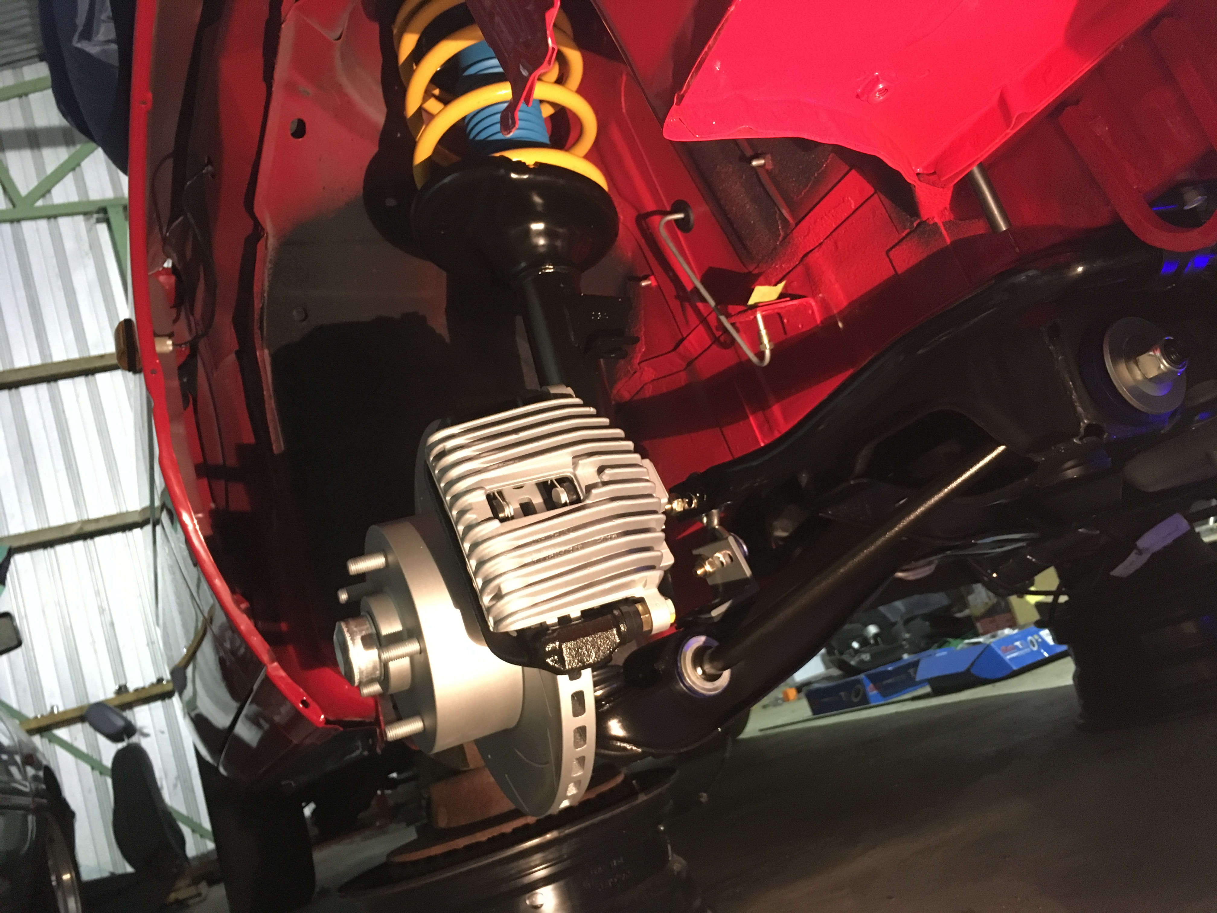

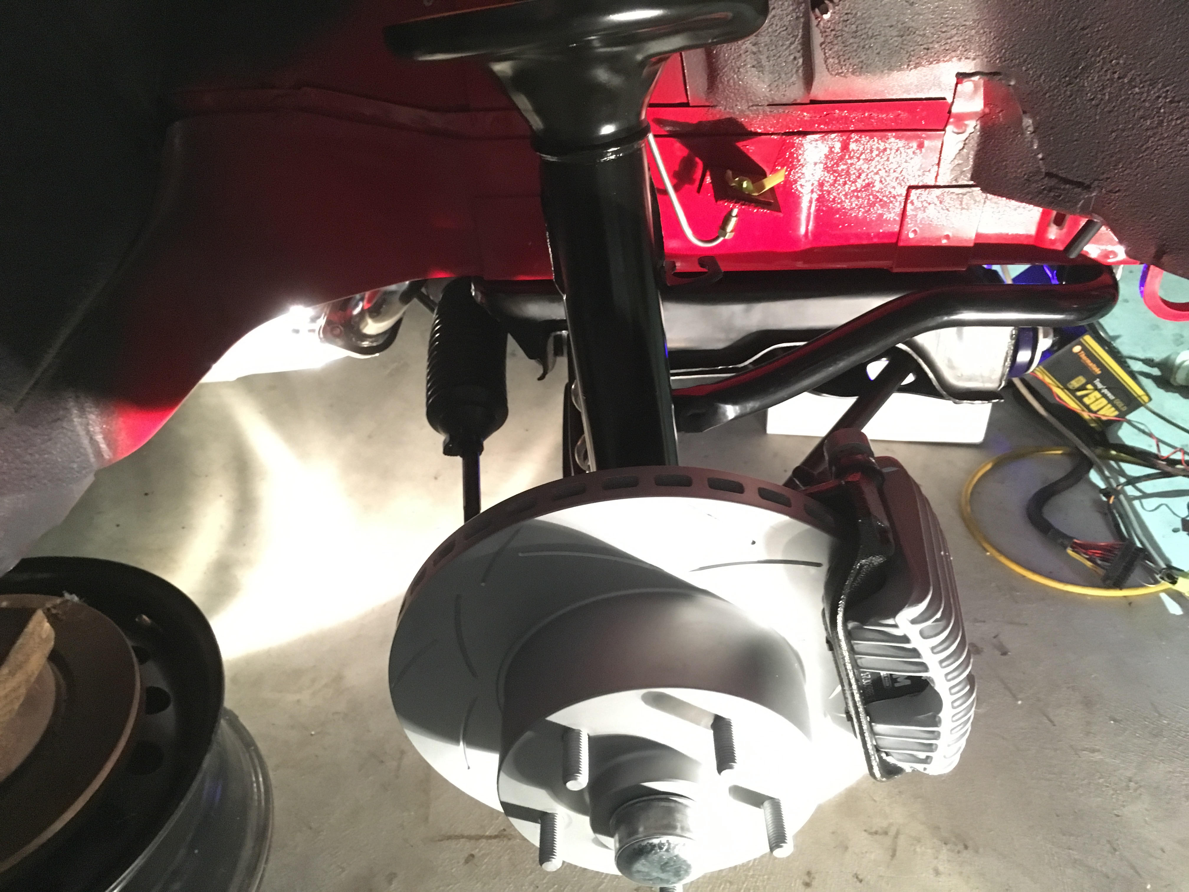

Got the rotors and calipers sorted. Still need to fit the hoses though.
I really like this shot.
I also measured the camber angles properly since I have a surface to measure from, just a fraction over +1º. I used the phone app to zero out on the chassis and took the rotor face measurement, both exactly a tad over 1º, so I know for sure I have plenty to work with when the car sits on some wheels and goes into a negative value.

Lookin good, radiator is a nice bit of kit
- Posts: 8124
yeah it is nice, a side bonus of a necessity since aftermarket ones are smaller than the original. If you need custom, you might as well go all out in capability and quality.
