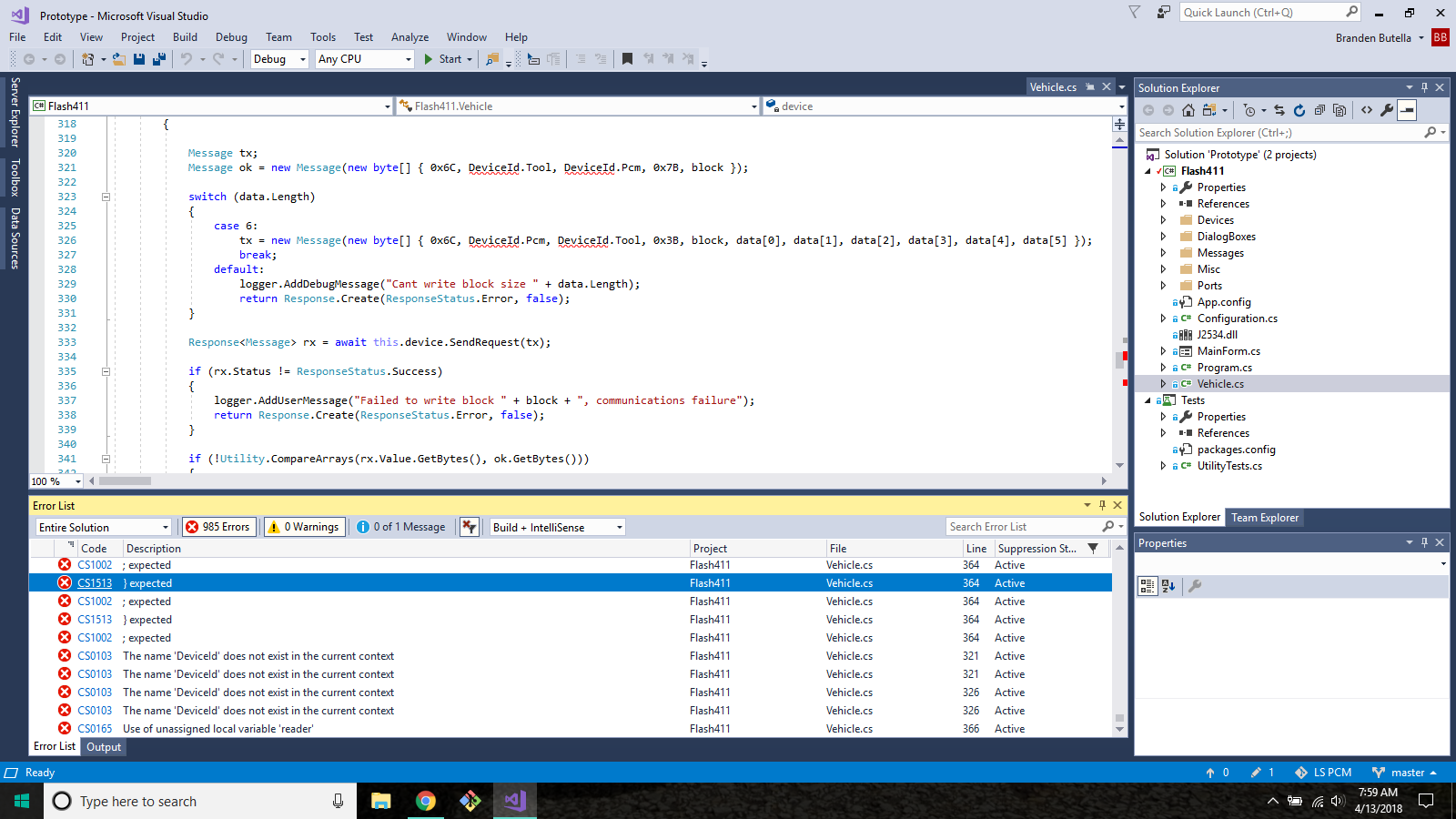

Sorry, but I'm a newb at programming.
I'm still getting 985 Errors when trying to build. All from the vehicle.cs file.

Re: Open source GM OBD2 flash tool using a ELM327 device
Where is the first one? It looks clean to me too. C# 4.7.02556, as part of visual studio enterprise, 0 errors, 1 warning, 4 messages. Current master, commit 5a9b87b7344153c39c7ec415db46f75b9a208f1f
It sounds to me like your copy is not complete. git pull then git checkout master
Ok, I got it working. Never used git on a windows laptop and I was trying to do it via the GUI instead of the using the terminal.
