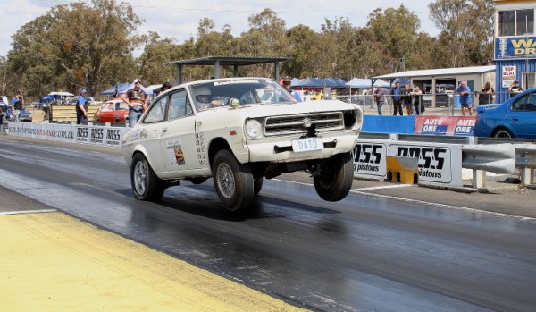

v6bucket
Posts: 765
Re: Sc14 to buick and e85
Post by v6bucket »
No under bonnet pics yet, but here's one of it in action at the 6 Banger Nats in 2012.
6Bngr2012-2__173 (600 x 349).jpg (75.03 KiB) Viewed 3509 times

What sort of horsepower is the datto making?
