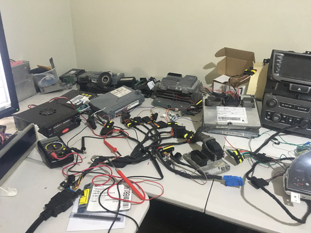

80gus wrote:Yeah it will do e38 ls1 t42 and ford ECUs now I have another for other ECUs
Did you make it yourself?

Re: Ford MPC565 Tuning
Post by 80gus »
Yeah mate

I wish I could say mine was that neat... I tend to have whole cars hooked up :lol:
