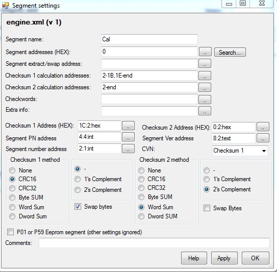

kostia111 wrote:Good afternoon !
I want to check the checksums
file which consists of one segment
file = segment
for example this
I already broke my head
trying to write xml
there is no way to indicate
that segment address is the beginning - the end of the file
Good morning.
Beginning of file - end of file:
0-0@
joukoy
Posts: 398
Joined: Tue Dec 17, 2019 3:27 am
cars: --
Re: Segment Swap utility
Post by joukoy »
I think this is how you need to setup it?
Btw. did you try to click small buttons right side of all address fields?
Edit: checksum store address is skipped automatically when calculating.
