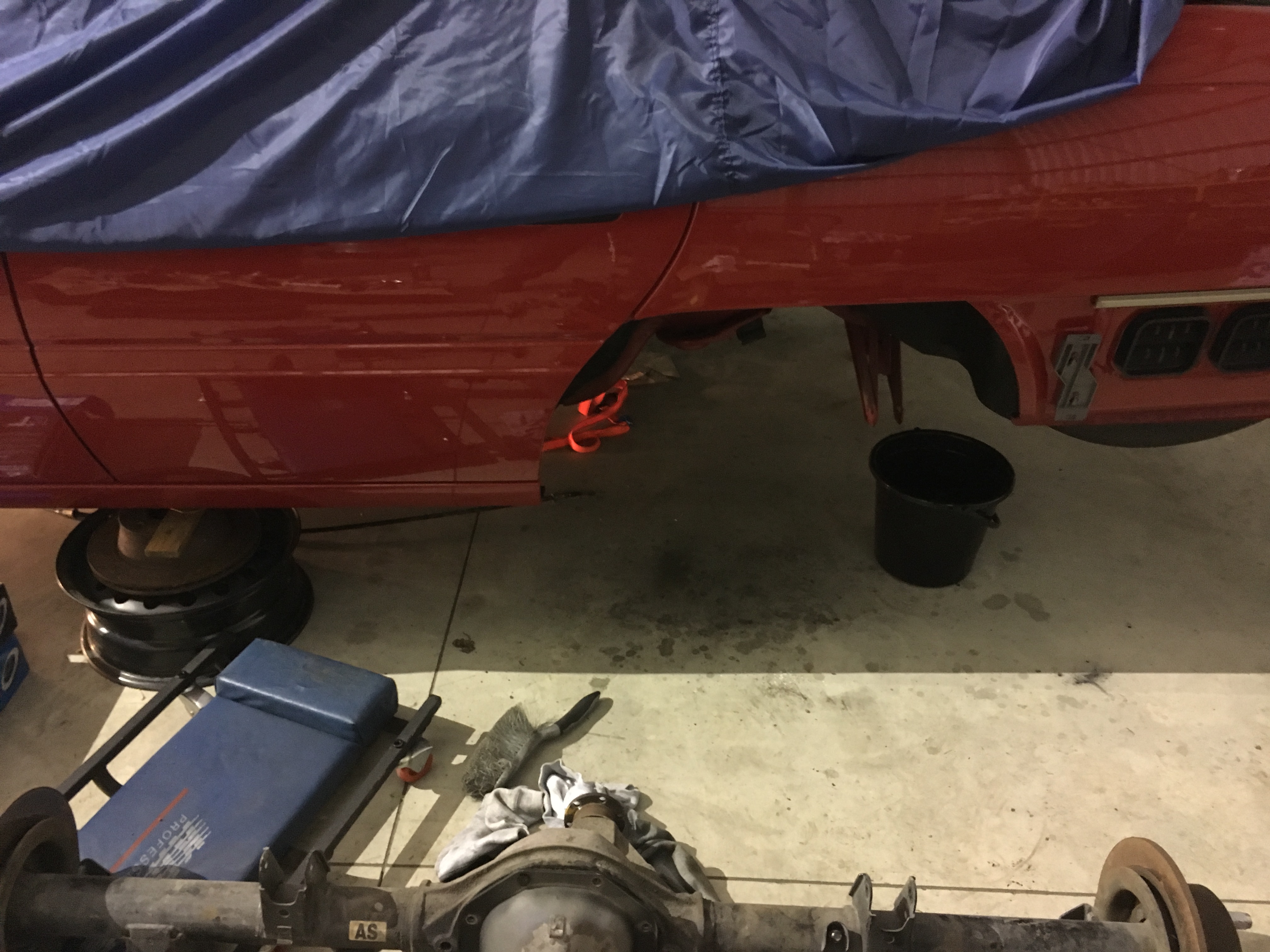

Out with the old diff and suspension bits.

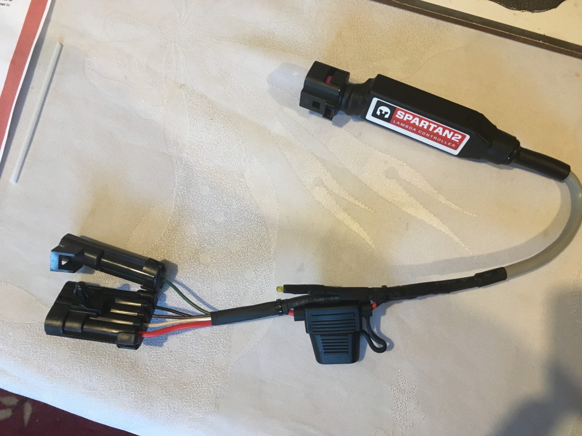

Spartan 2 controller all done.

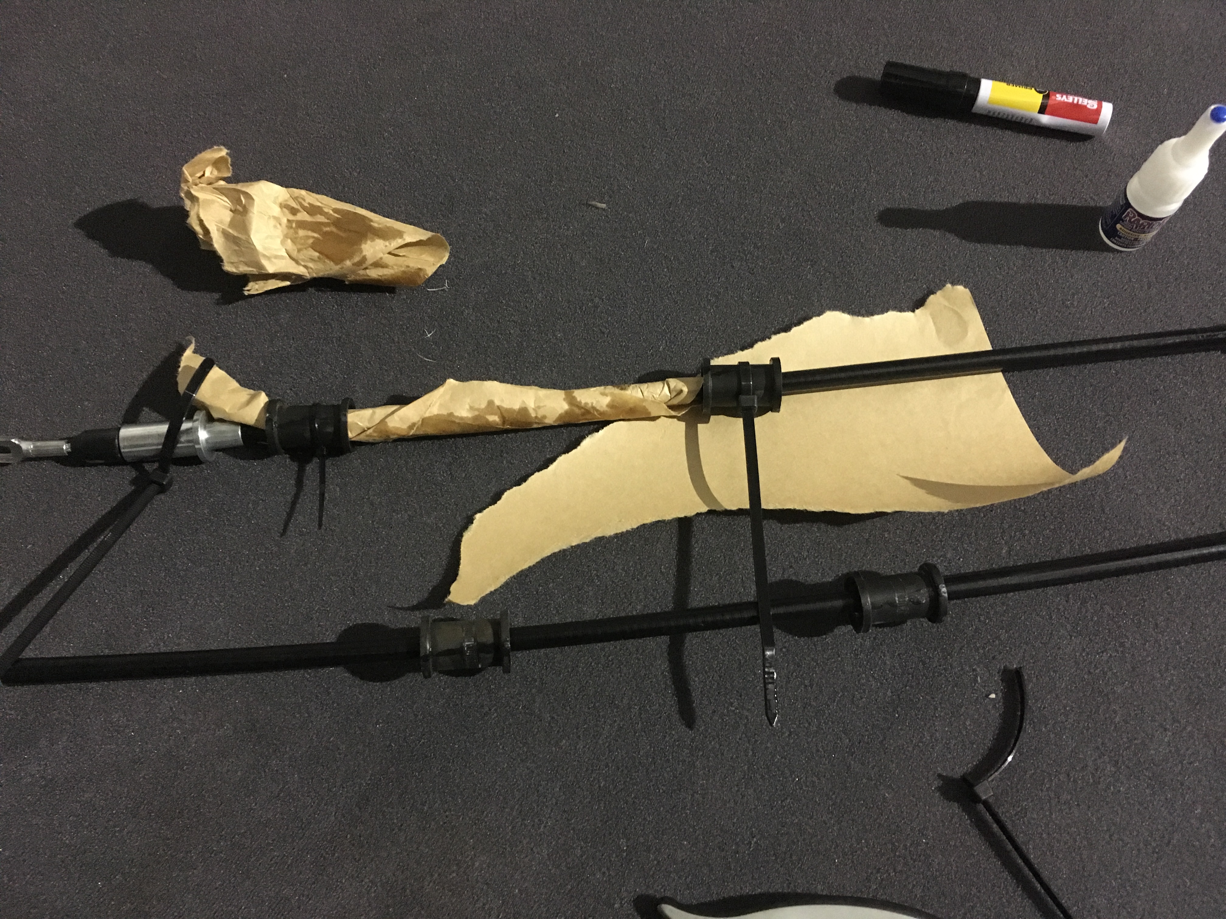

I had to transfer the plastic cotton reel holders from the old handbrake cable, only way was to slice them down the middle, put them over the new cable and glue them where I cut. Seemed to work well. Th reels clip into saddles under the floor pan.
The paper was to stop getting glue all over the cables.

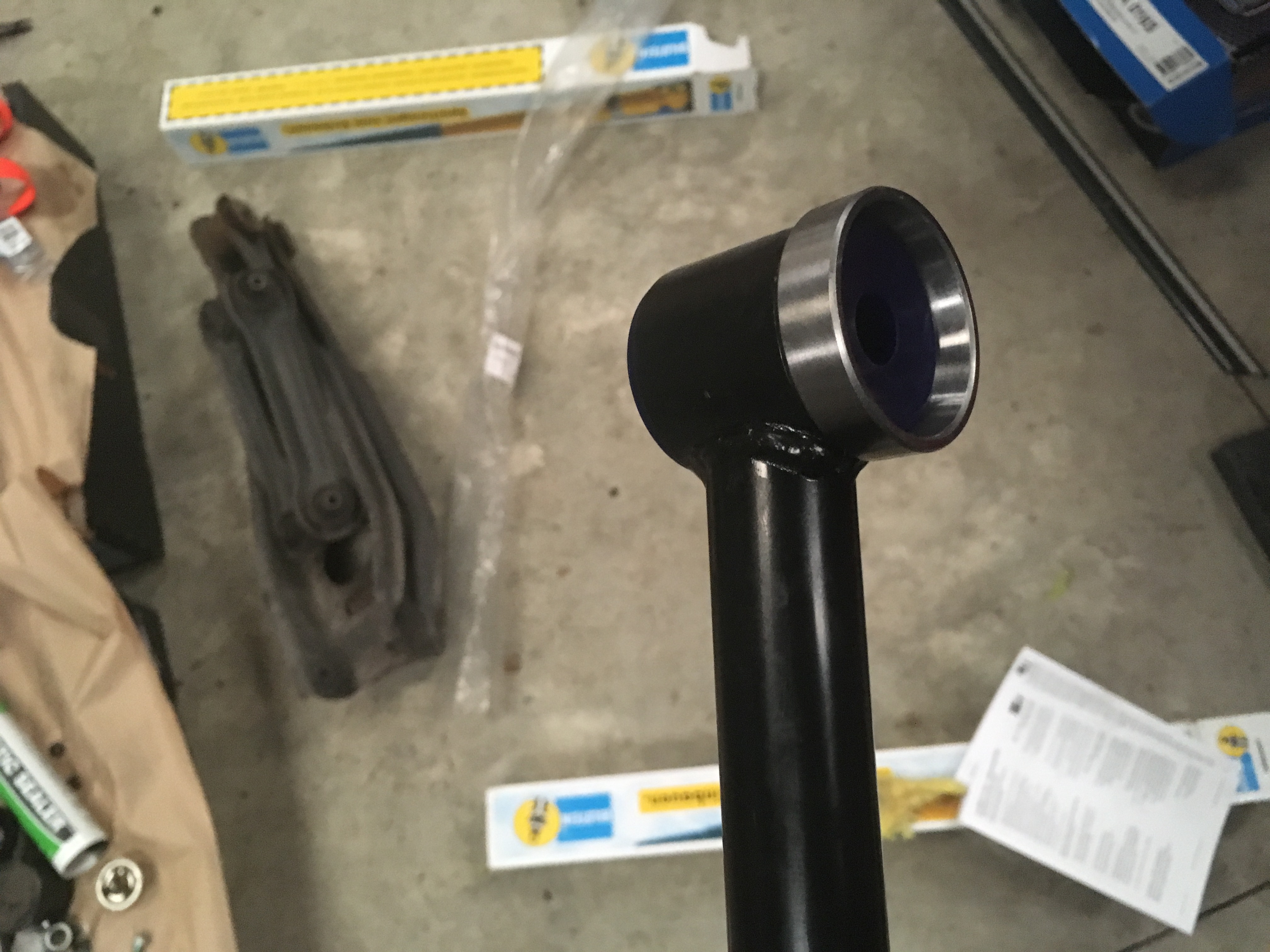

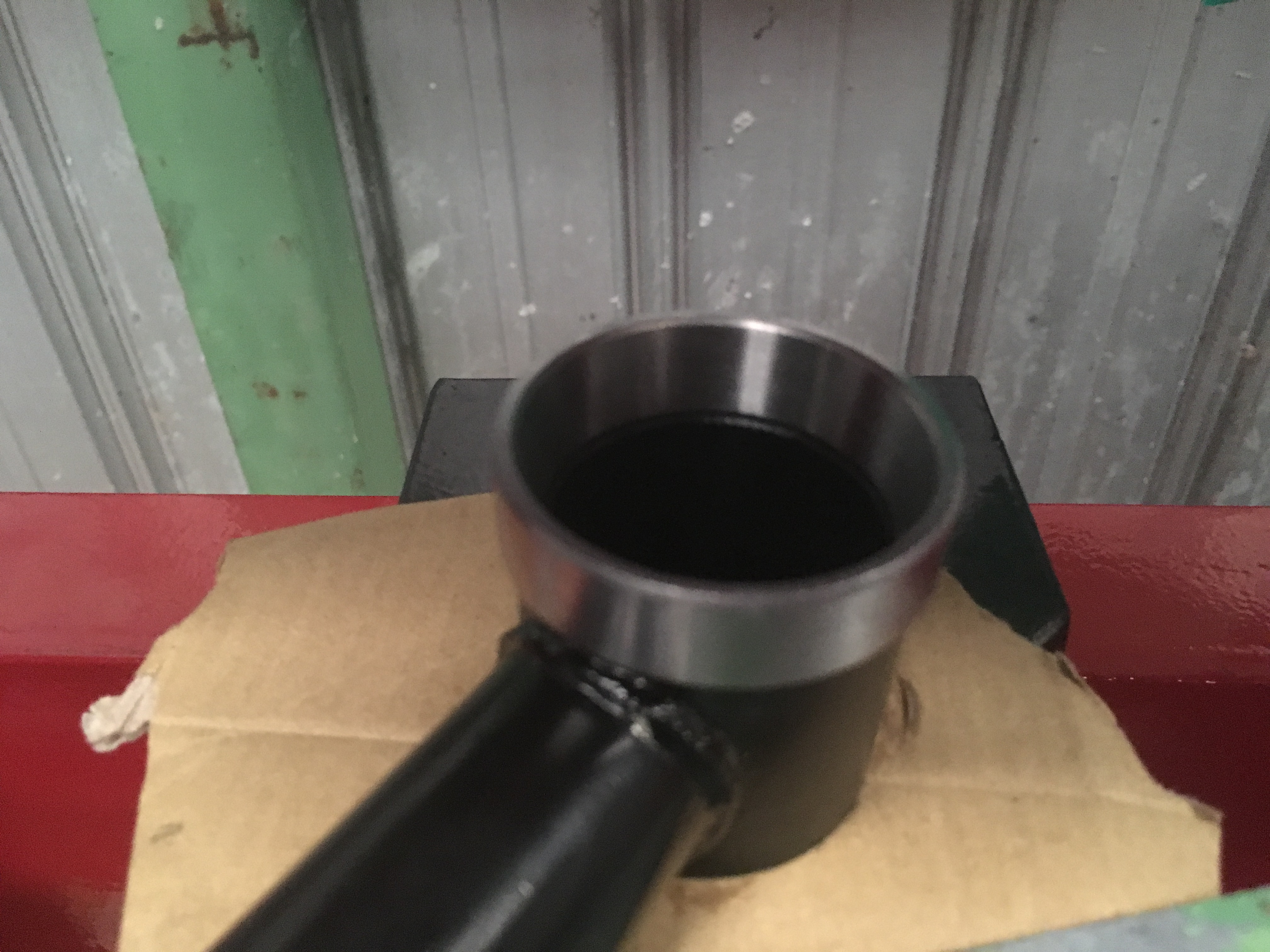

While installing the new diff and suspension stuff. I couldn't get the bushes in for the dogleg style adjustable panhard bar. So I came up with this idea to compress the outer lip small enough to push though the housing.
Not the best but it did help a lot when I pressed them in on the hydr press.
After it was in I could pull the cup off by hand with help of a rag to grip, was pretty slippery with the grease to aid pressing it in.

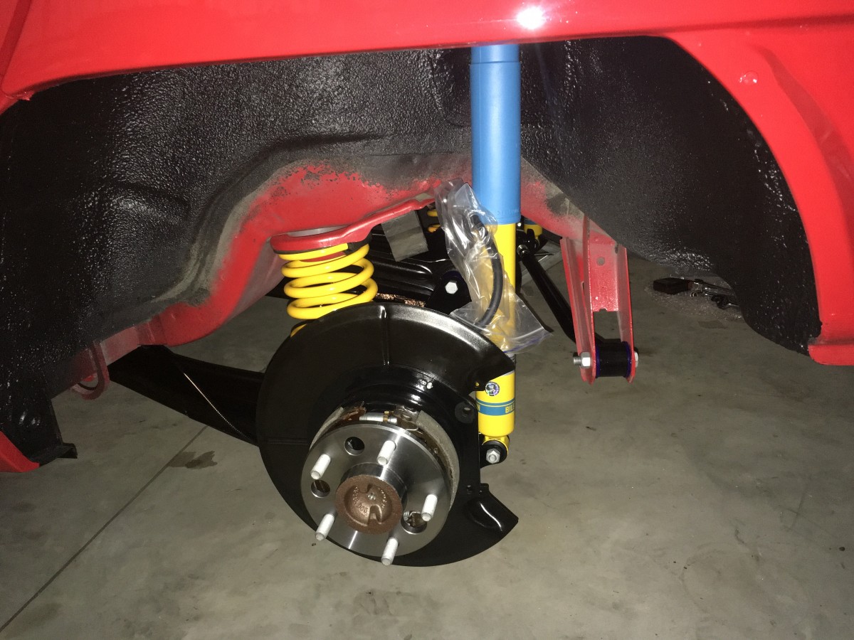

So all the main parts in, all bolts torqued to spec.

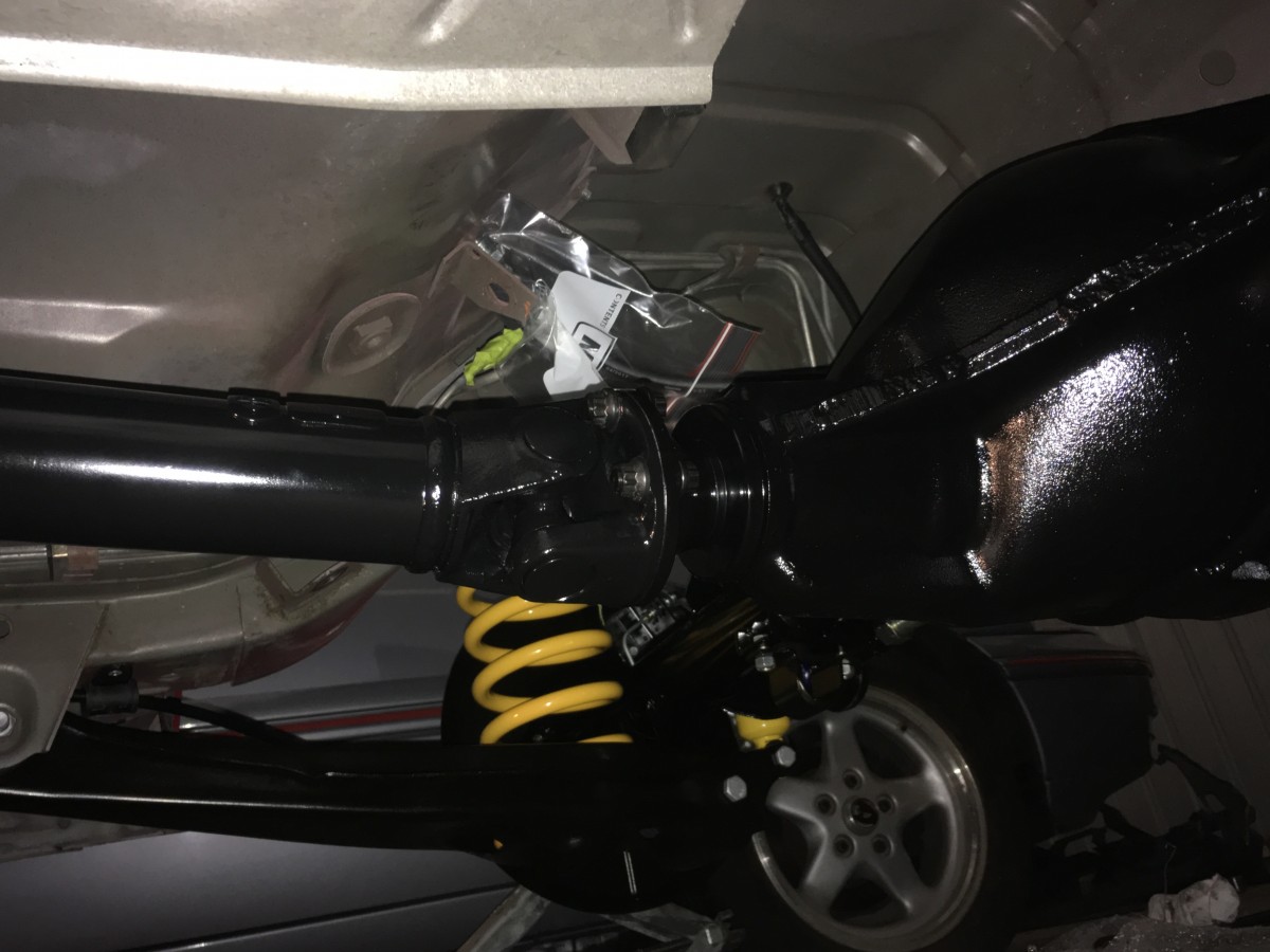

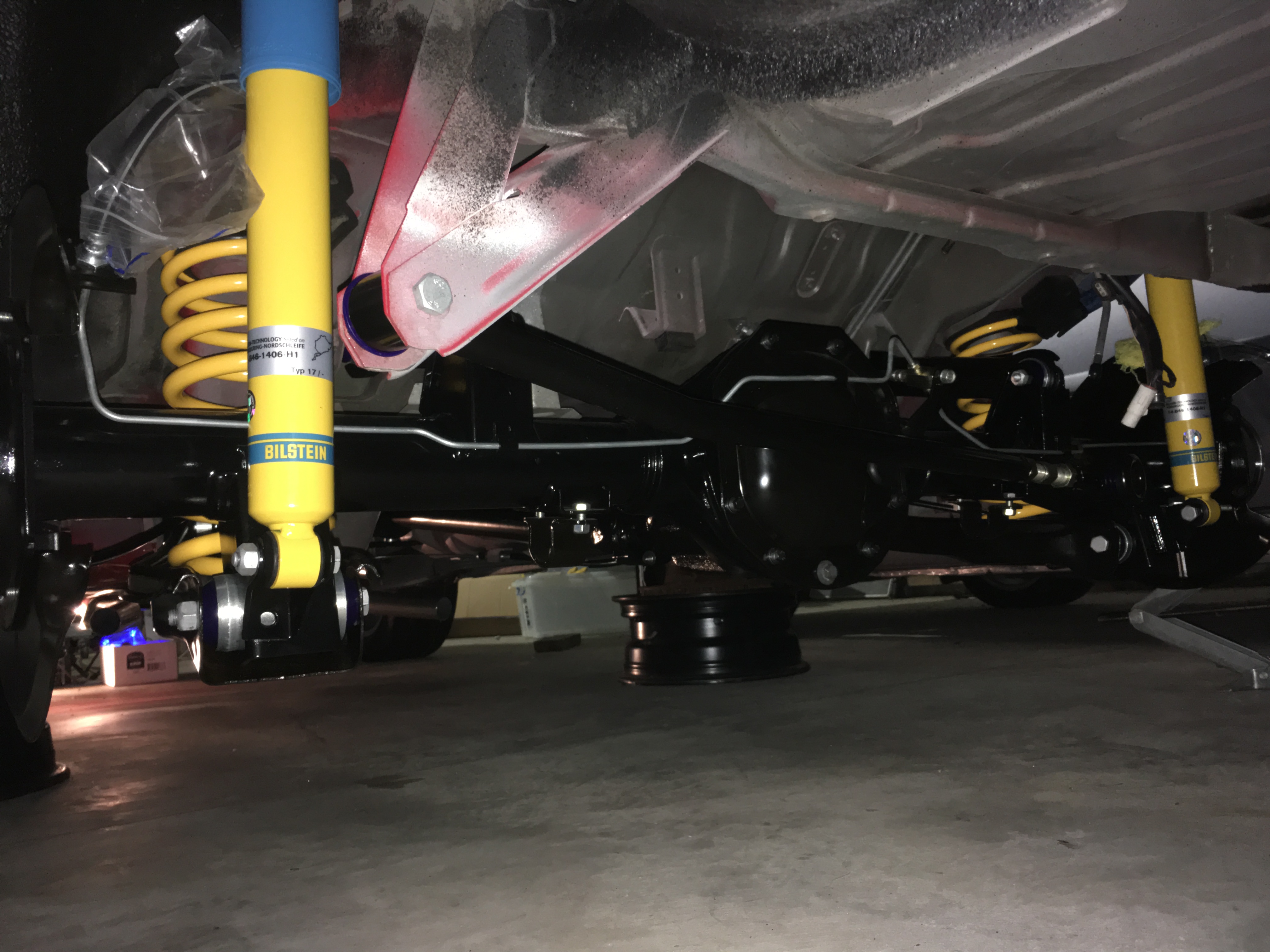

Remaining bits to do are the rear brakes including handbrake. Also the rear sway bar and the rear is done ready for wheels. Oh and to fill the diff with oil too. Can't forget that can we!
Did the tailshaft to diff connection. Those ARP bolt/nut choices worked out awesome. I put a little moly grease under the nut flange face and bit of red loctite on the threads. I don't know what torque I did them up to, but as fucking tight as I could.
No way you can come close to stretching or breaking them, they are that strong they only turn about 1/5th of a turn at full effort after full contact, with 2 spanners it won't turn them anymore lol
