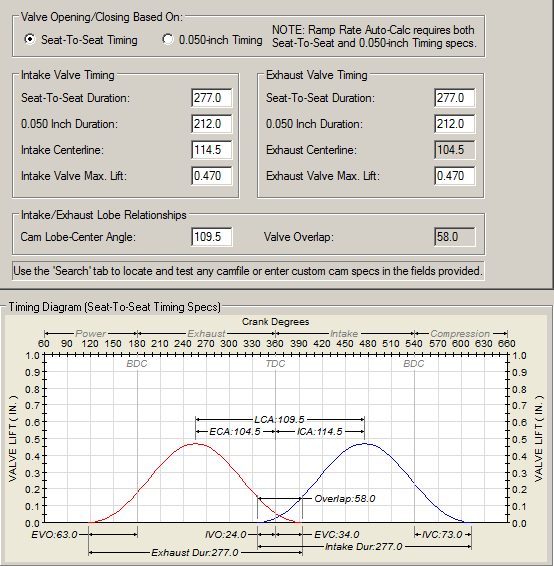

What cam and injectors I have a couple of 12p cam tunes

40 ish lb FoMoCo 6 hole injectors,fully calibrated in the tune and cam specs below.

from the screen in the video i'd say its too rich ? and narrow band at 990 seems to say that too....
even with a big cam you shouldn't need much more than 13.5 at idle ?

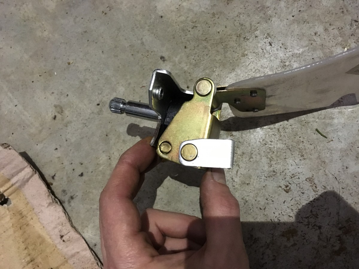

This is a super common issue with the VP seats. The lumbar adjusts break. Only ever seen one not broken and I have that seat up on my rack so going to build one from the 2 seats. I am going to get the covers redone with NOS cloth near Bendigo. I washed all the covers, only took 8 was cycles in the machine. They were disgusting
All the foam turned to this orange gooy crap and made an absolute mess of everything.
I am going to get the engineer/machine shop I use to made a solid steel support block with shaft to replace the pin that is held by the side tabs in the mechanism so that my good lumbar adjuster will be modded not to break. I suspect the one in the VP S should also be good being 70 odd k on the clock so I will have 3 made. One for the VR as well, that is totally broken, doesn't work at all. So will keep an eye out at the pick a part for a decent one to modify for the VR later on.

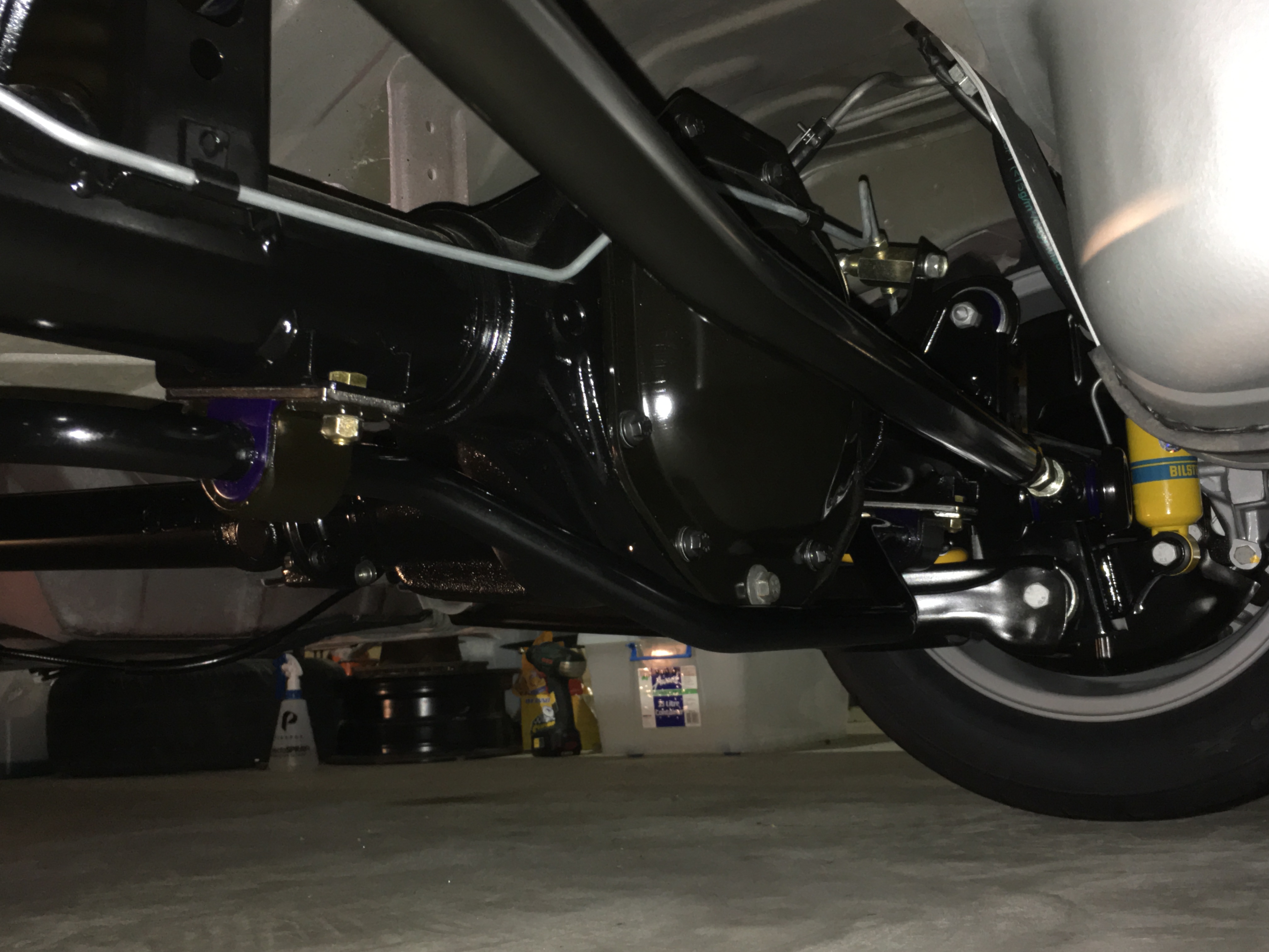

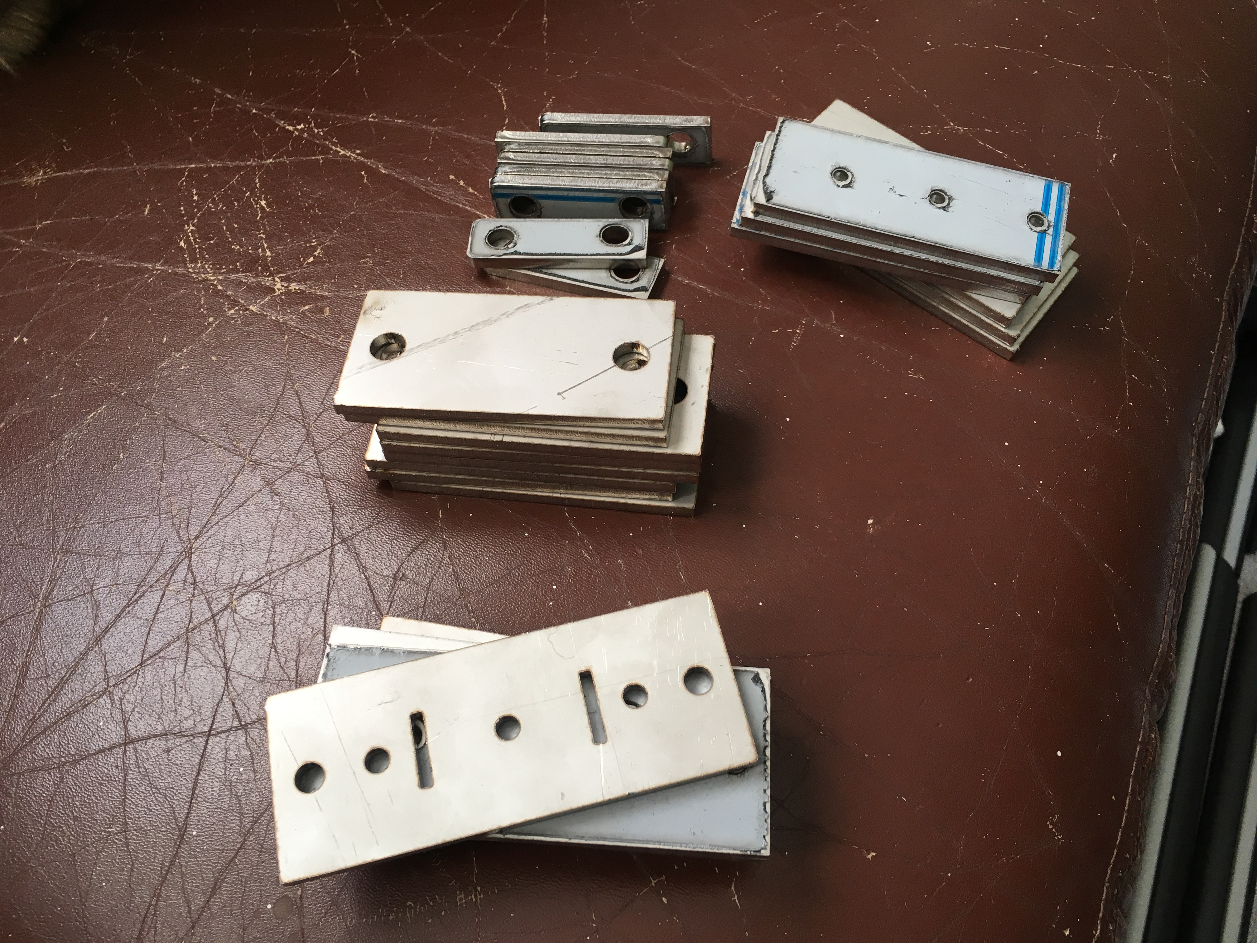

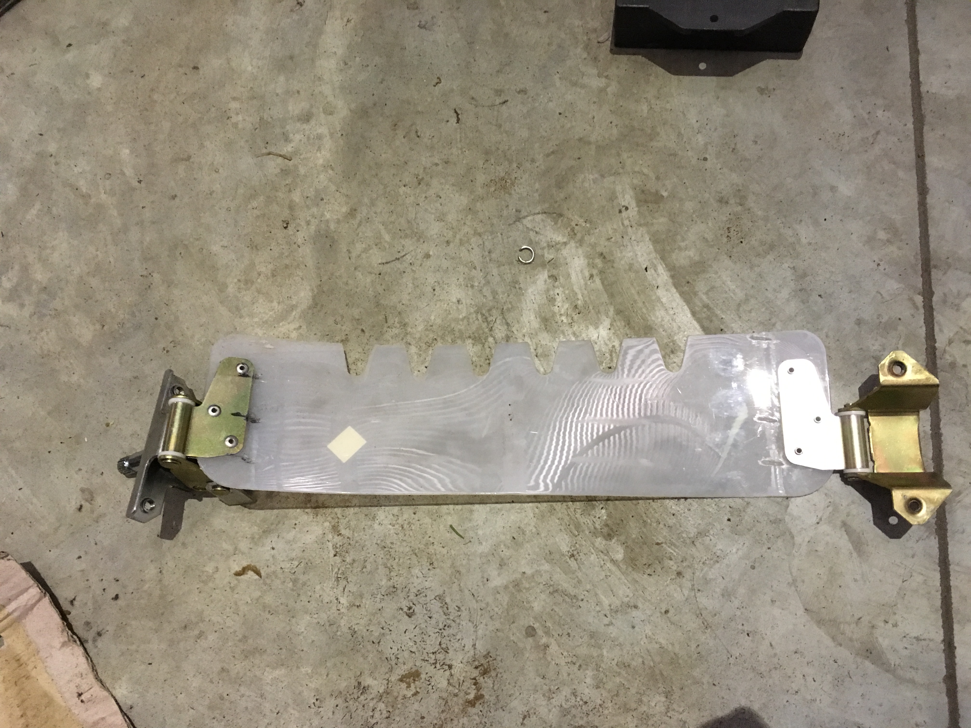

Also my laser cut stuff arrived. So I got the sway bar spacers fitted, one layer of 4mm was enough...just. Clears by about 2-3 mm now.

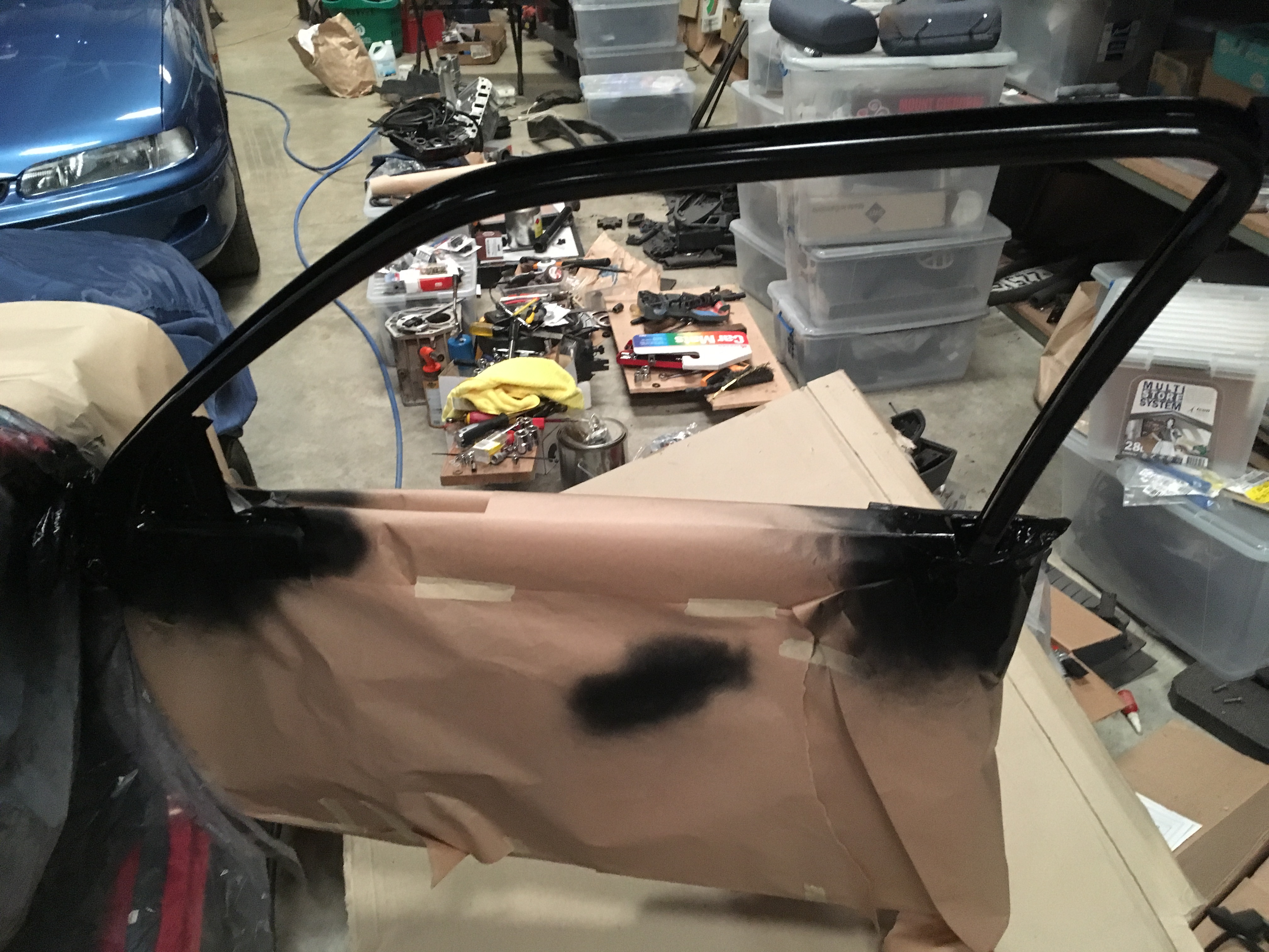

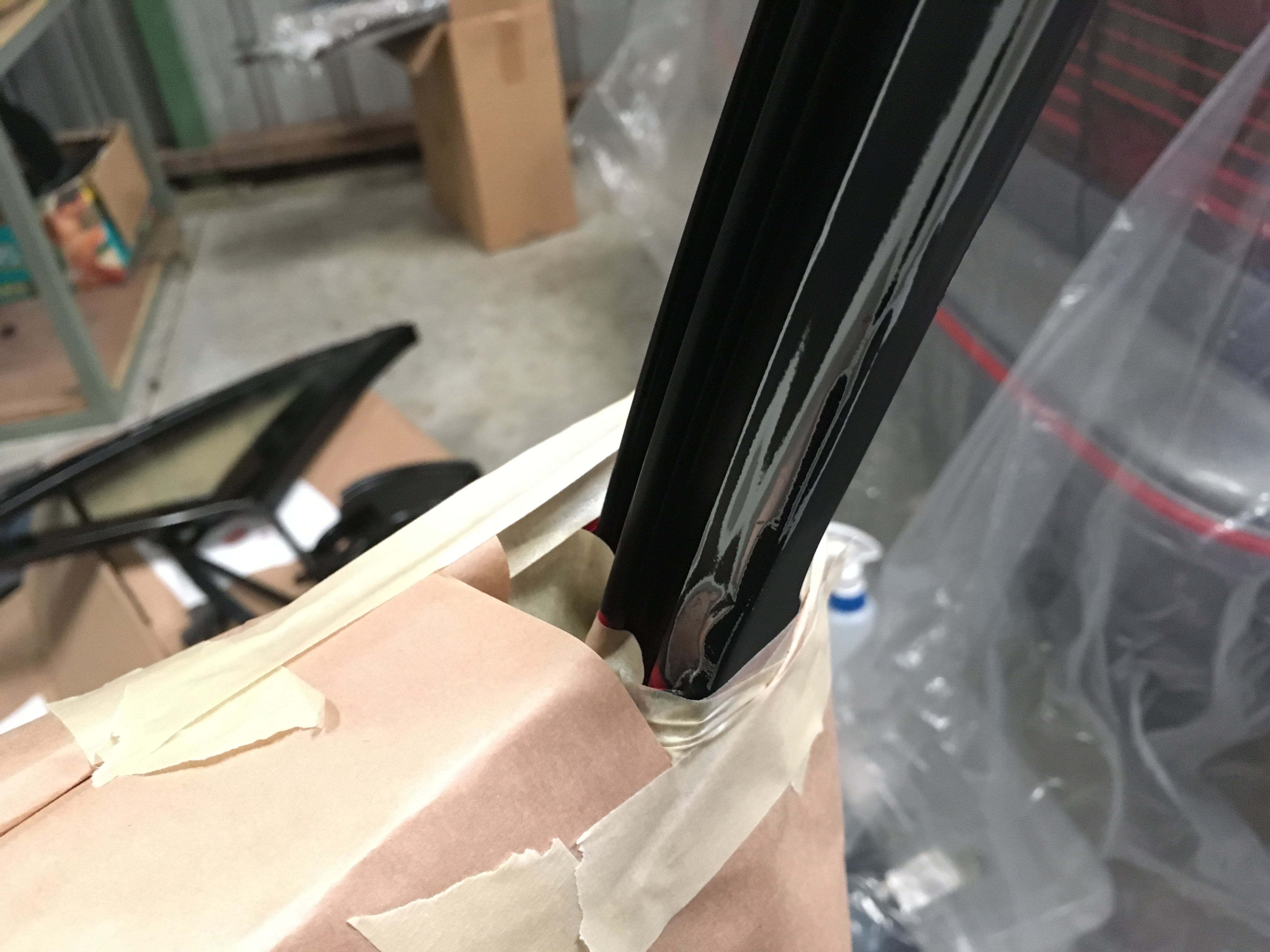

I have been putting this one off since about April when it became too cold to do any painting or gluing etc..
Last 2 days the sun came out, something I have not seen for several weeks and the temp was warm in the shed with humidity not too high. About 15-17c in the shed.
The frame on the driver door had several spots of heavy surface rust around the welds and paint chips and paint worn off where he first owner was getting in and out.
The 2 back doors had a tiny spot on the back corner which I ground down and touched it up with a dab of POR15. The Passenger front door was perfect so no need to do anything.
So I spent the last 2-3 days grinding with tiny dremel bits and little wire wheels in a drill to get in the spots and preped the rest yesterday.

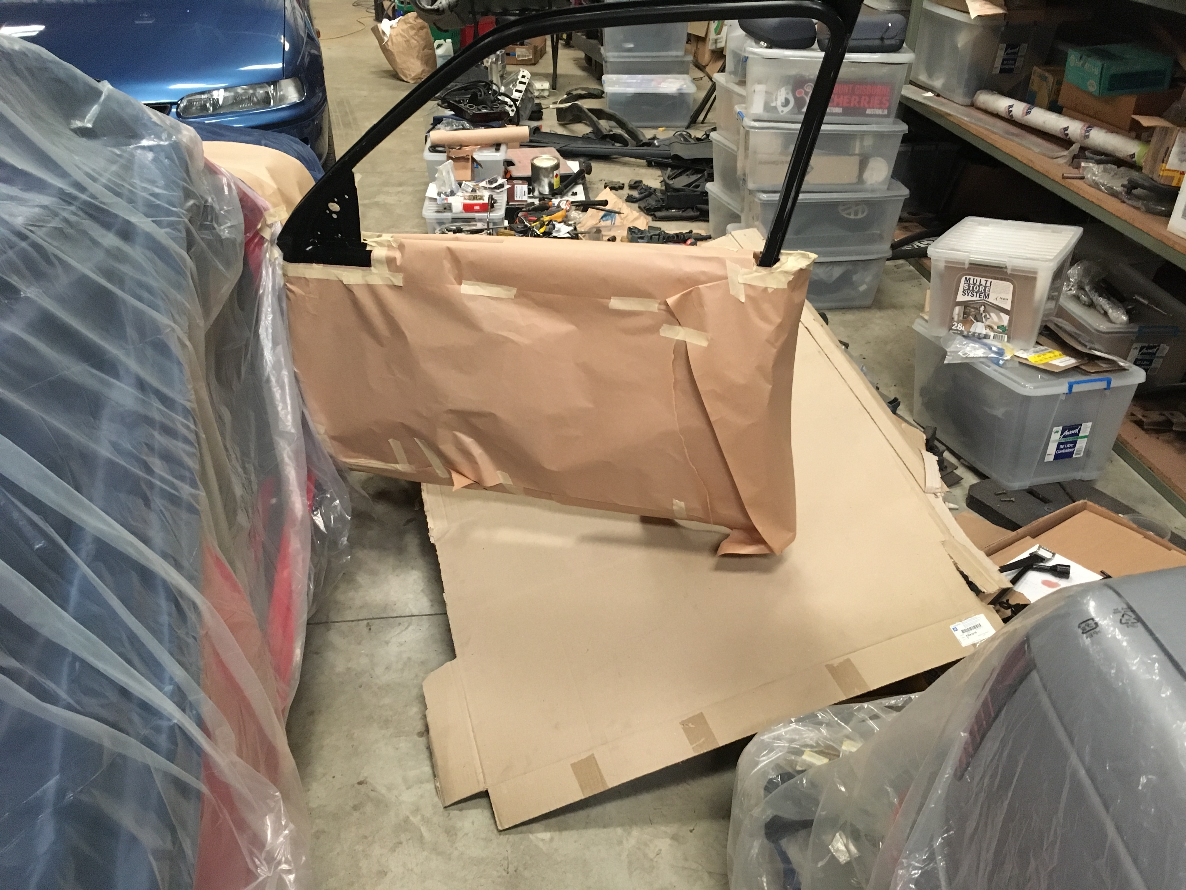

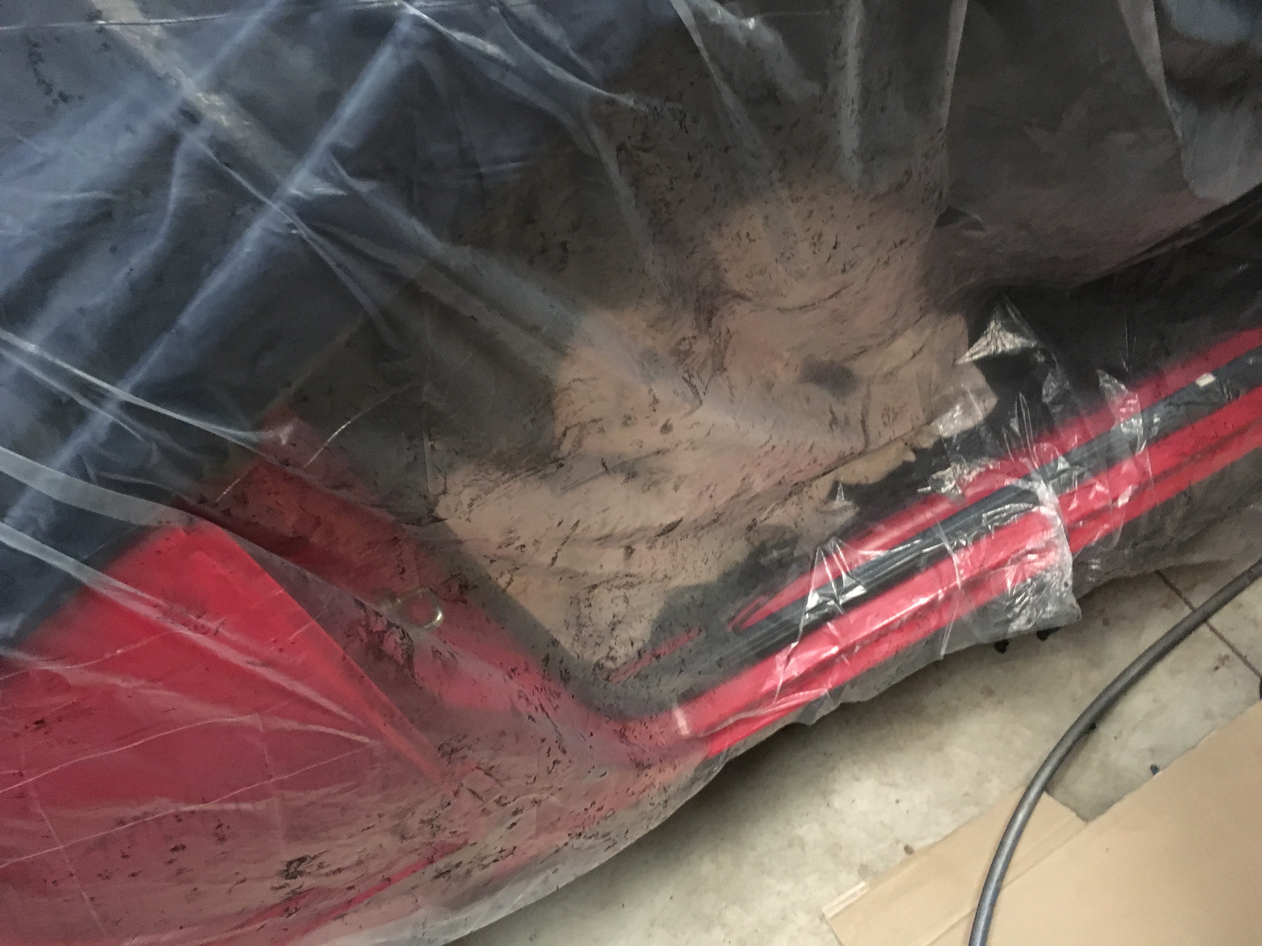

So I masked it today and everything else due to the large amount of over spray dust the Upol paint makes.

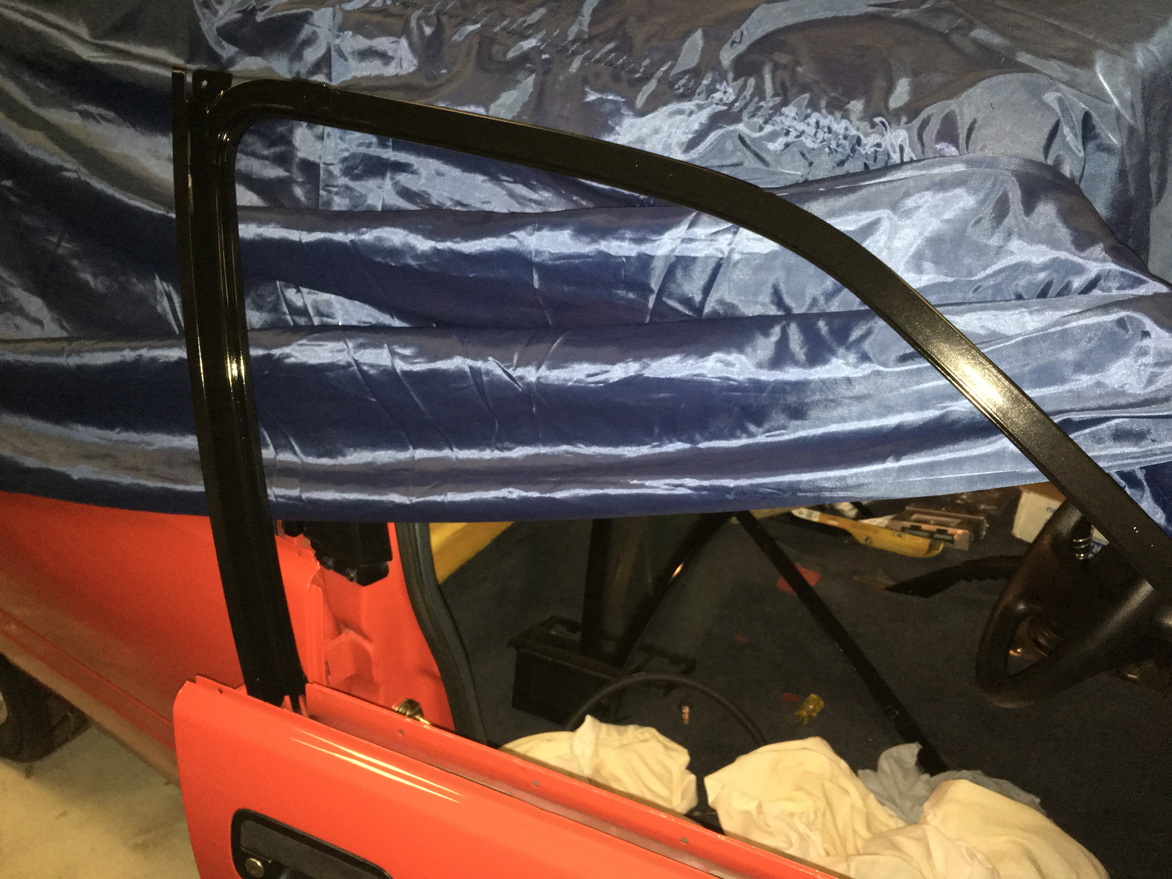

Before painting how the back part of the frame looked after smoothing and rust removal.
Masking.
Etch primer and paint.
Yep, this shit goes everywhere!
Looks just like factory new.
So I will be chasing the remainder of good used bits from Bendigo this week including a late model glass that hasn't had a factory space bubble so hopefully not scratched up like it was dragged though a quarry.
Masking.
