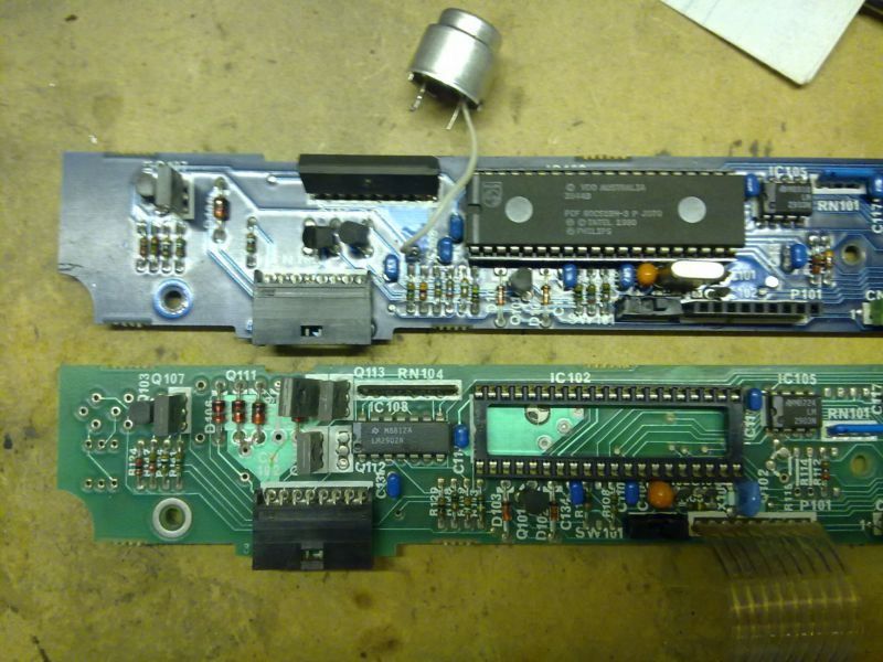

green pcb lcd unit
compared raw bins and it's different code
hrm, upon further investigation of the cluster i think this is actually early vn it's got a vr front on it but everything else looks early pins in the speedo and tacho faces and the vdo sticker on the lcd unit is date stamped 14589 which had fallen of and was inside the cluster.
so still searching for newer clusters to dismantle......
green pcb lcd unit

I've got most of the interesting functions worked out from the first bin, so recognised a few of them in this one straight away.
There's a bunch of new routines here, and I think it handles the external interrupts a bit differently - how different are the PCBs?
There's an extra routine writing to the nvram - does the VR have any additional cluster functions compared to the VP?

No different functions.
Quite alot of difference in the board designs where the warning lamp/buzzer connection are to the left of the mcu, couple of extra diodes, transistors different.
nec upa chip has gone and a lm2902 has possibly taken it's place but can't tell by looking will need to research the chips and draw up a schematic.
thought there was a difference in the clock crystal but it's changed what it looks like, the big blue component on the green board near pin 20 is marked X10? just had to bend it out of the way to read, thought it was a cap.
has an X2444PI chip instead of the CAT24C44
Put the Green mcu in the blue board and it functions
fails diag even with the right nvram code.
and the buzzer i have put on the vn board let out a loud high pitched noise when ign power was applied and i think i'm now half deaf.....
the diag mode fail is quite interesting with the green mcu in the blue board when changing modes, the lcd screen test is totally different, instead of selecting all segments it's doing it in a pattern and order selecting different segments, will try and get a video of this.
blue mcu and nvram into the green board works perfectly, diag mode works with no fail message.
nvram

the numbers in your chart, are they the numbers on the screen print of the pcb?
I have a blue pcb 40737 which is late vn, the original owner changed the cluster with one from a wrecker that was marked VN, VDO date sticker is F120391

VR/VS Green PCB 43365 vdo sticker E17196
Board looks identical to the blue and red pcbs
Tested mcu and nvram in a blue pcb, works 100% bench test, 91 (blue/red) nvram matches the 96 code in the important bytes so is compatible.
Festy is the built in uart initialized in the code? (i did have a quick look but didn't see the port speed) if so then it shouldn't be to hard to rewrite vp trip comps to run in vr/vs and vise versa without removing the mcu.
i think this completes the collection and 3 revisions of code
Now a bit off topic, it wouldn't be hard to add 3 x 7 segment led/lcd displays with driver ic's to the existing board but how hard would it be to rewrite the code and have a permanent digital speedo in the cluster? (or as there are quite a few unused output pins on the current lcd driver chips is this feature already coded and just not connected?)
and some pinouts i have seen a tacho input on the trip comp inputs, how can we unlock and display that?
nvram dump
