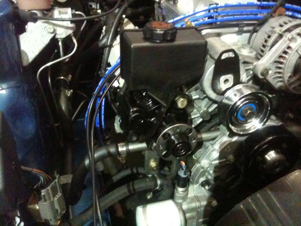

gotta be happy its finally in!!
looks very factory clean too heheh :)
Posts: 8600
yep! love the factory new look. I always aim to make engines look like they just meant to be.
Posts: 10436
well im pretty sure factory never had chrome plated tensioner pulleys ?? :P
Posts: 8600
thats actually period correct aftermarket billet pulley with replaceable bearing. They were very common on the VP and VR at the time when the factory ones packed up.
I have 2 of them and seen others on grandpa spec vn, vp, vr
Posts: 10436
yeah i know they period correct but not factory spec :P
mind you from what i've seen of the results of the factory one failing i'd opt for that one too!
Posts: 8600
I also found these billet ones being very heavy dampen the tensioner. with plastic pulley I see the tensioner bounce when the engine misfires every now and then at idle.
On my brother's Vp the tenstioner bounces and makes a "clank" every time a cylinder misses at idle.
I just un-clip the circlip on mine, knocked out the bearing and installed a high speed high load rated bearing. My one on the VP has lasted years with the same bearing.
this isn't factory spec engine anymore anyway, i just like them to look factory but improved on. :shh:

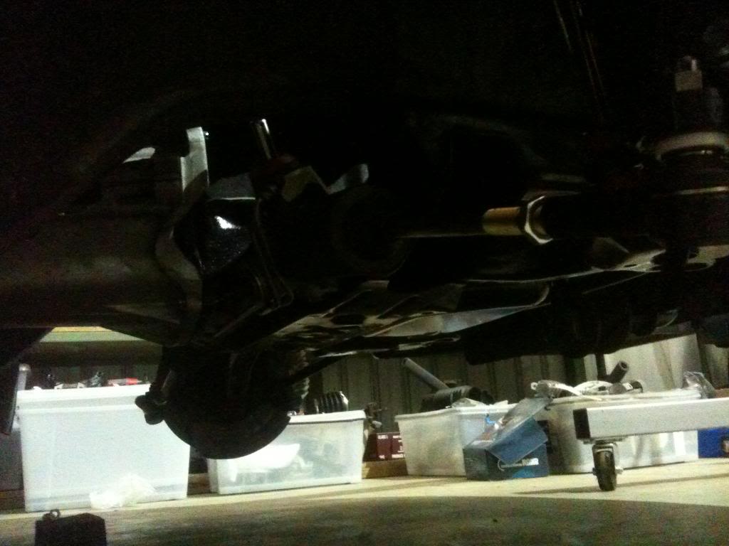

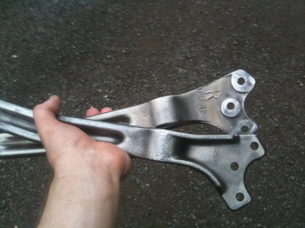

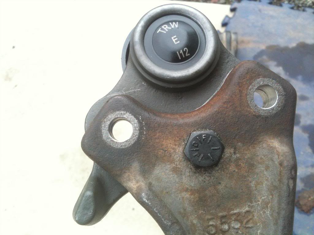

got my arms back from the machinist, heaps cheap that i made the jig.
Good job!

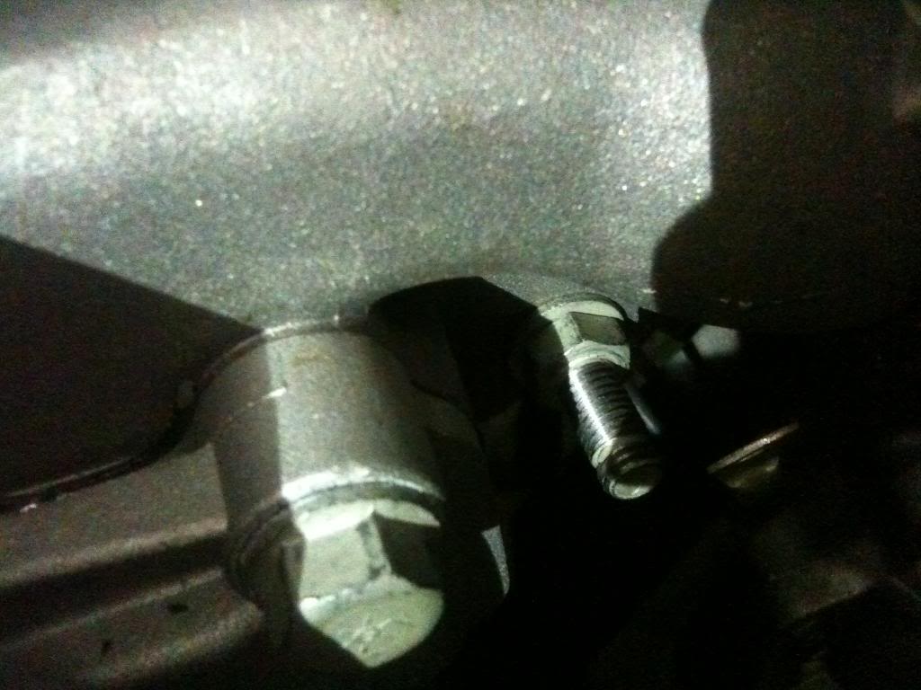

thread cut on this otherwise blank stud that is normally used on the CAS cover, but with the thread cut can now replace the rusted ones used for the ECU ground. I bought all these studs and bolts from GM in the states but this particular one doesn't exist on their engines so I made one :D

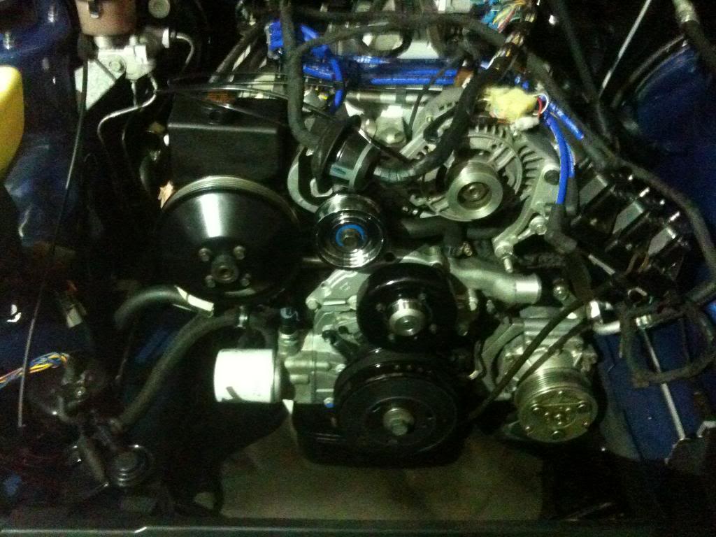

shit pic, but PS rack loosely fitted as it might be a shit fight when the exhaust needs to go it, which is next on the parts list.

bolted with grade 8 3/8" UNF, with conelock nuts and loctite to 65Nm (47ft-lb) :study:
Then hug for painting.

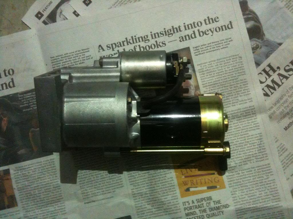

rebuilt another delco remy while I was at it.
arms, primed in epoxy etch and 2 coats of epoxy gloss :thumbup: done! just wait for it to harden for a day or 2 and fit the bushes and in to the car.
