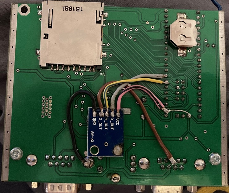

happy to help if i can regarding the g-force sensor, that was my feature suggestion.
i am not sure if he mounted them to loggers like mine is, he might have added it to the PCB design for later versions!

Thanks. First question is where did you buy the sensor in the pic? It looks easy enough to install.
Re: ALDL Logger V2
search ebay for "ADXL335" ... you need to make sure its an analog output one as per above with the gnd/vcc then the 3 x analog outputs (X,Y,Z).
but i am wondering yours is already showing data does it not have it in there ? i would have thought if it didnt have the accelerometer in it VL400 would have put a firmware on it without that in it .... but i could be wrong ... i guess go to that screen and move the logger around, if the dot moves its probably already installed.

I don't think its really showing data because you move it around and it just stays in the same spot. Looks like I'll have to look inside. I am sure mine was one of the early ones but I thought he only made one batch. Boy I didn't think it would be so cheap so figure if I do order one from China best buy a few knowing their reputation for quality.

ahh right, well if you put it in as i did you should be right then. i just tried to make it parrallel to the pcb, and used one of the big earth pads already there and just added solder to it to fill the gap to my accelerometer board. then just connect the wiring as above.
i cant remember which one it was , but the Z axis as you can see goes to one of the analog input pins on the serial plug, it just means you cant use that for an external device input.
