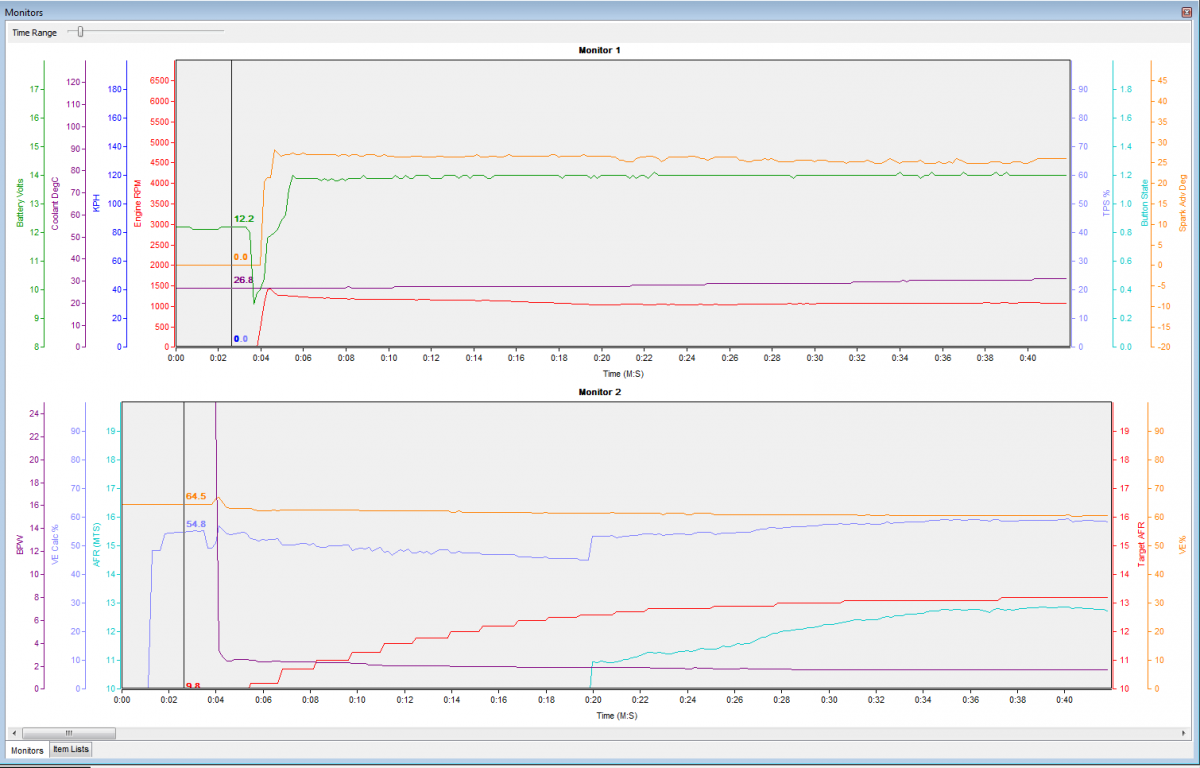

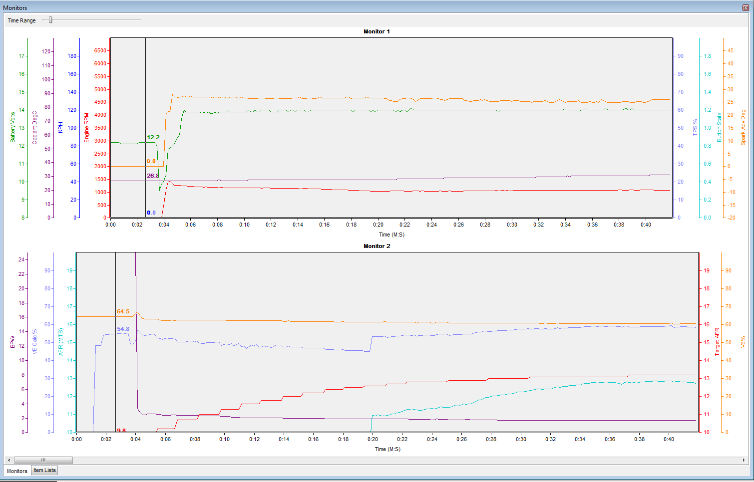

Not much of an update but getting some fuel tuning sorted, once thats closer to the mark will start on the spark - its a super safe tune thats not even close to using E85 to its potential. AE is getting better each day, E85 really messes with it.
First little squirt the other week on only 3psi to check the box shifts ok - 40% throttle, just filled up with 80L of fuel, timing roughly 14deg, lambda fat as at 0.75 and auto shifting at well under 4k RPM still turns the tyres in to second for a lazy 6.5 sec to 100kph - uphill
Should have some potential.

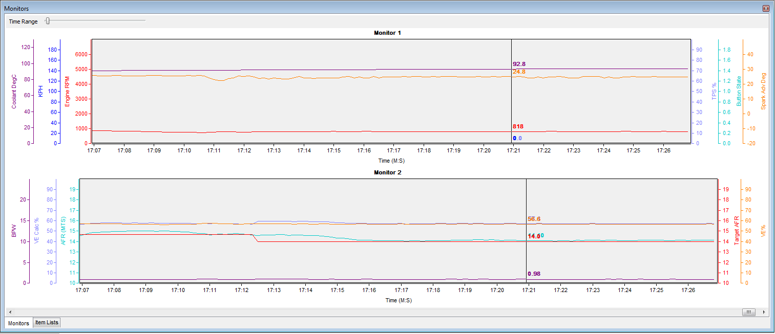

These new 850cc injectors from the1 are performing very nicely. Starts awesome hot and cold (not exactly winter here though), idles rock solid even on such low PWs.
Literally one revolution to start first thing in the morning and AFR gets close to target almost as quick as the wideband warms up ... Idle target AFR kicks in and it tracks nicely, delay is the wideband fairly far downstream...

VL you've almost got that thing at Euro5 spec with those AFRs that quick!

There is always improvements that can be made to AE, and being a rather different engine the close to factory holden V8 settings were never that great. Had only adjusted them enough to get it close. With E85 the cold AE was worse, a factory tuned stock engine might be fine and not notice it. Also compare the V6 and V8 cals to see how there are two very different AE methods. Lots of snappyness can be found playing with the manifold fuel items.
haha, these injectors certainly help with that! I am not lighting off the cat like they do now.psyolent wrote:VL you've almost got that thing at Euro5 spec with those AFRs that quick!

yeah I've found especially cold you need a lot more AE for E85 or methanol than petrol, the situation improves as engine temps come up....
