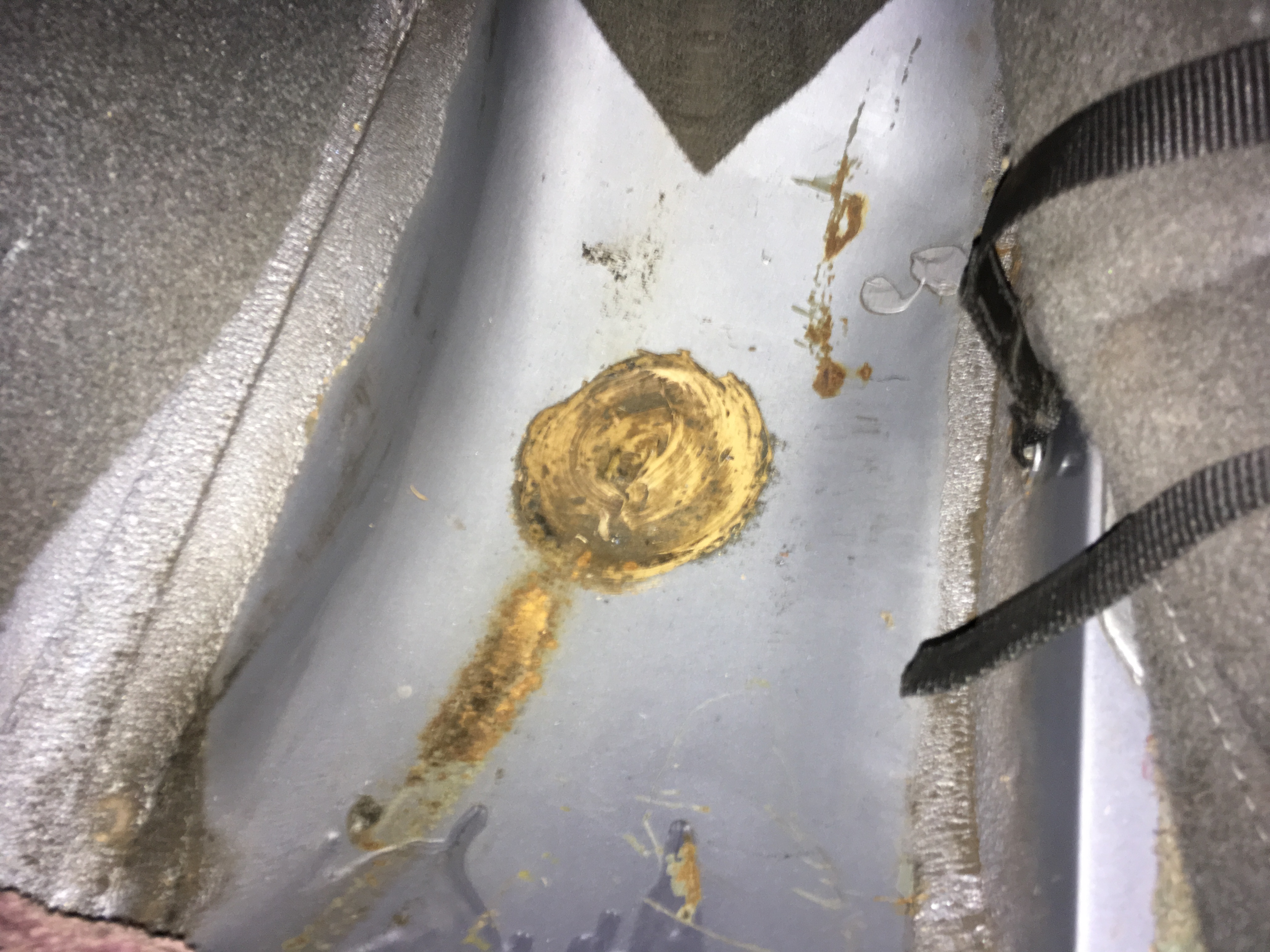

No they have sealer. It's a metal pate that is stamped in after coating and painting with it's bend over tabs as a permanent plug. They had the hole there for the draining of the EPD emulation after dipping in the factory. After all the painting is complete they press this plate in and cover it with unpainted seam sealer. The underneath is also sealed off by deadener.
If you have moisture or water in there, then your quarter windows are leaking. Most people drill a small hole in the plate to drain water, but as I said there is not meant to be water in there and the source is always leaking quarter window seals.
All my VN/VPs had sealer and they ones I have now never get water in there. My old vacationer leaked though. My nephew's VP is good, I resealed the quarter windows 3-4 year ago, dry as a bone and it lives out in the rain.

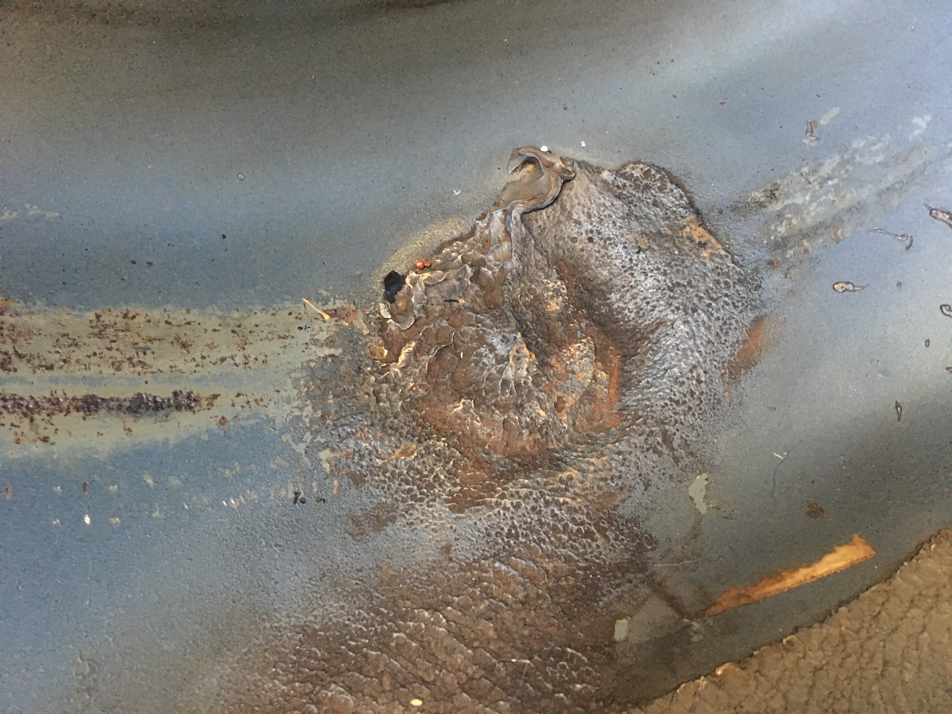

VR sprayed on before painting.
VP brushed on after painting.

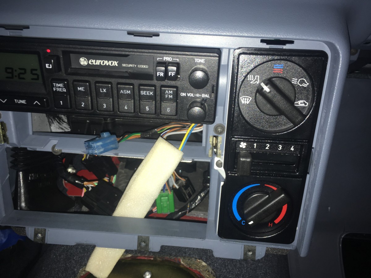

Built a heater/AC control unit from 3 others as all had one thing wrong or another.
Just trying to find a NOS fan switch knob as this one has seen better days, markings worn off and faded.

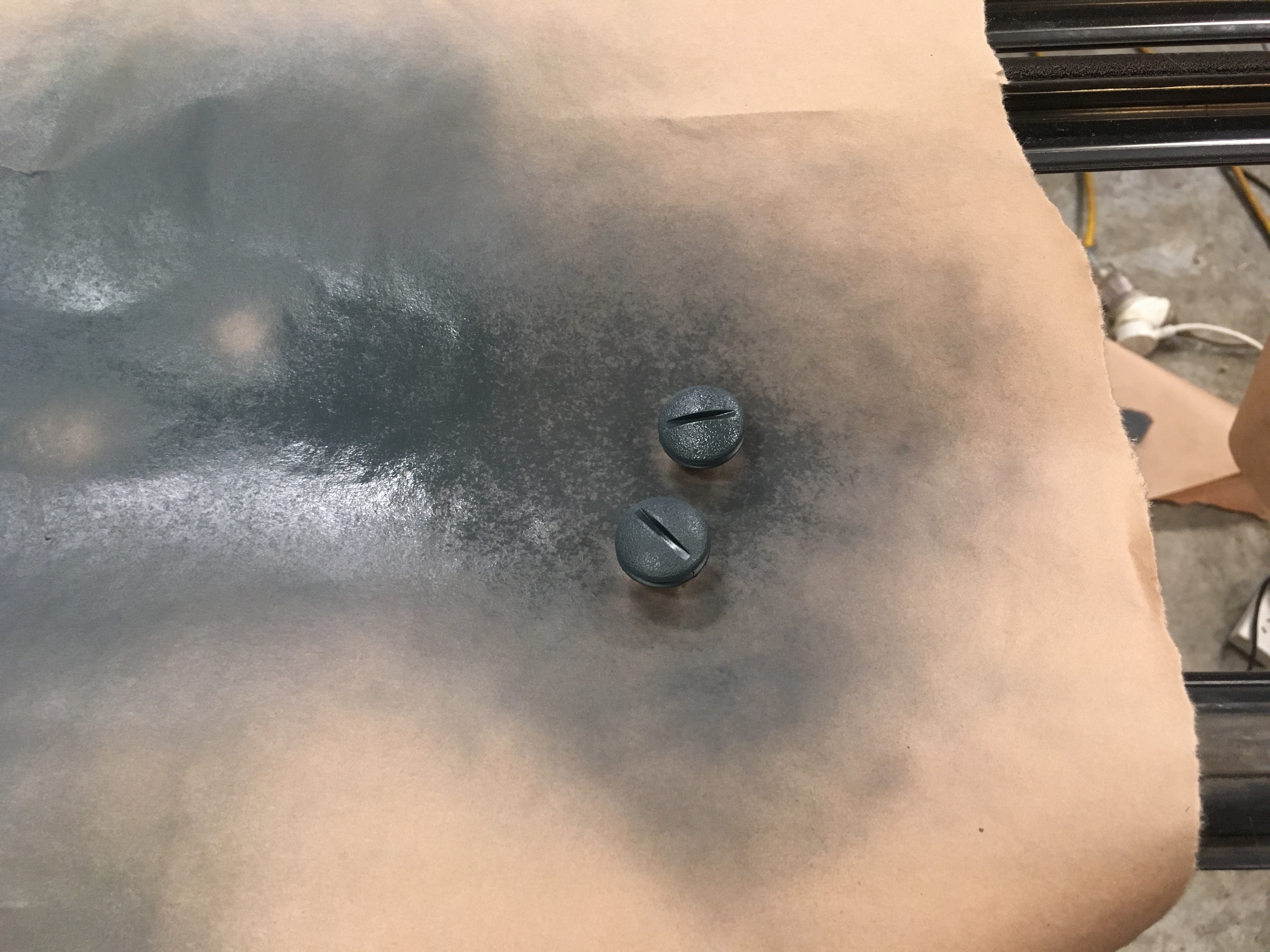

Painted these NOS fuse panel clips from black to blue/grey matched to the colour.

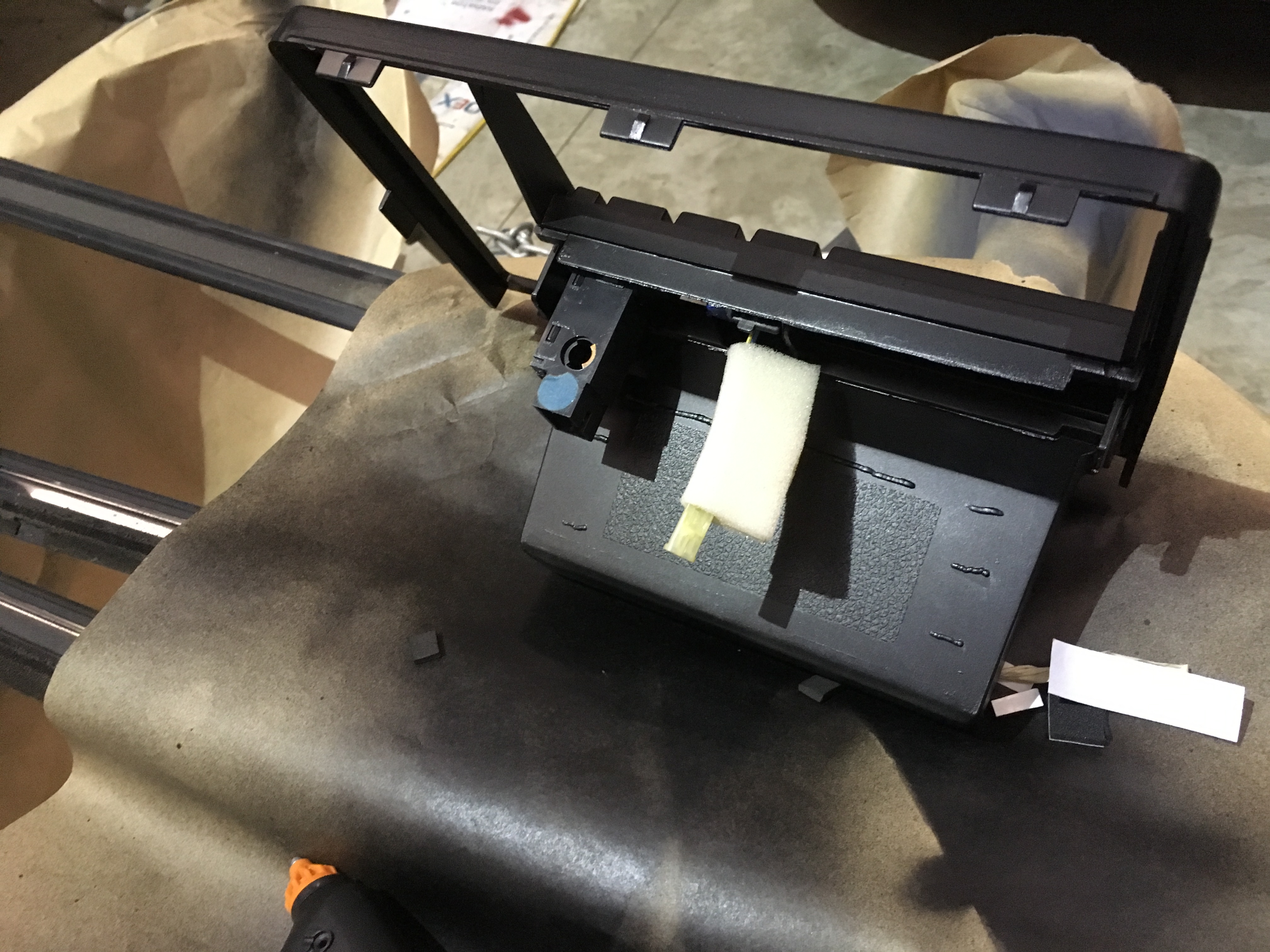

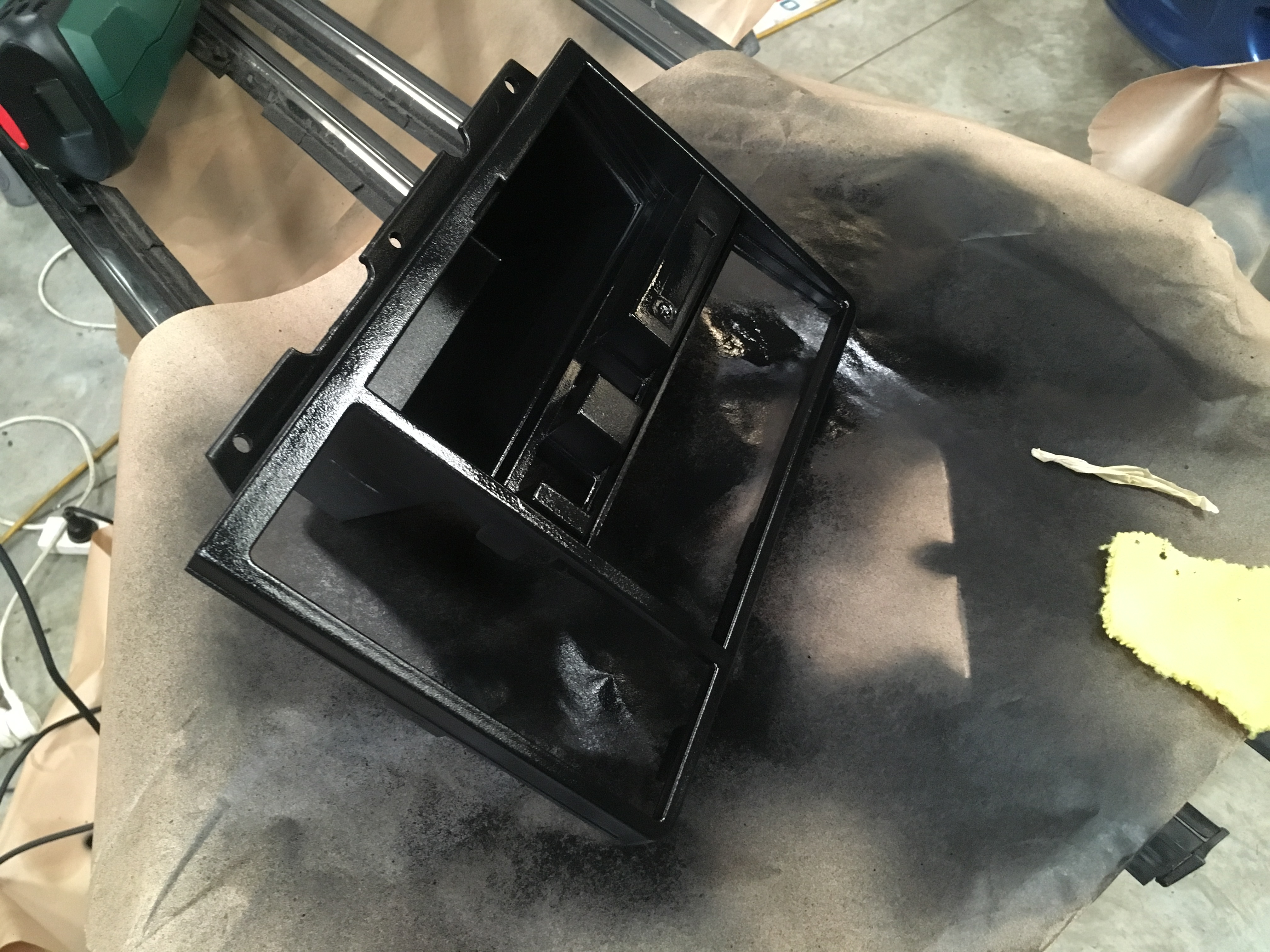

Also cut out the 2 blanks and painted the NOS radio surround to satin black, it was an awful flat cheap looking black that didn't match the original black. Now it does.

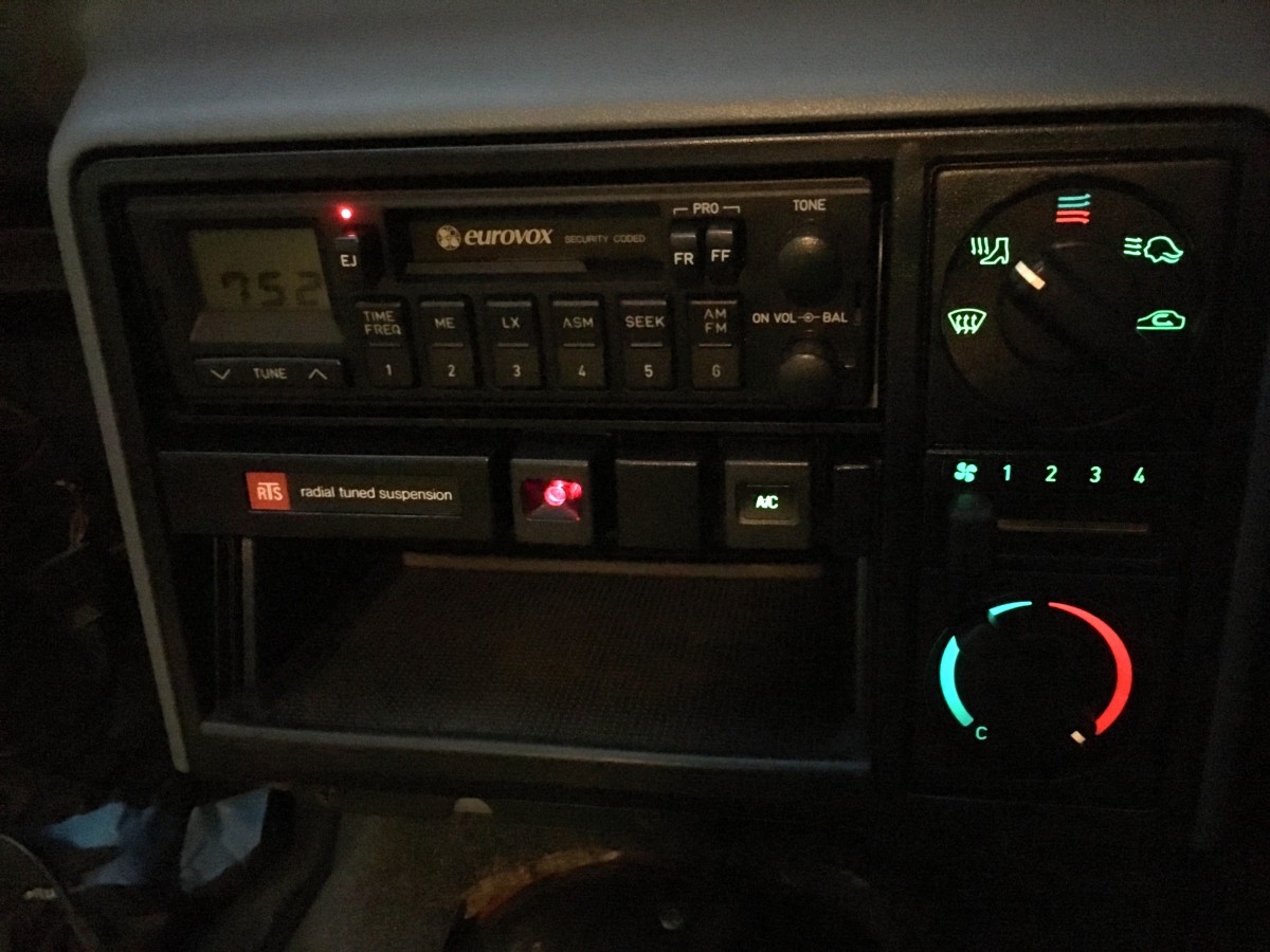

Rebuilt the A/C switch from 2 switches. Had the infamous ghost A/C. Finished the rest of the surround off.
