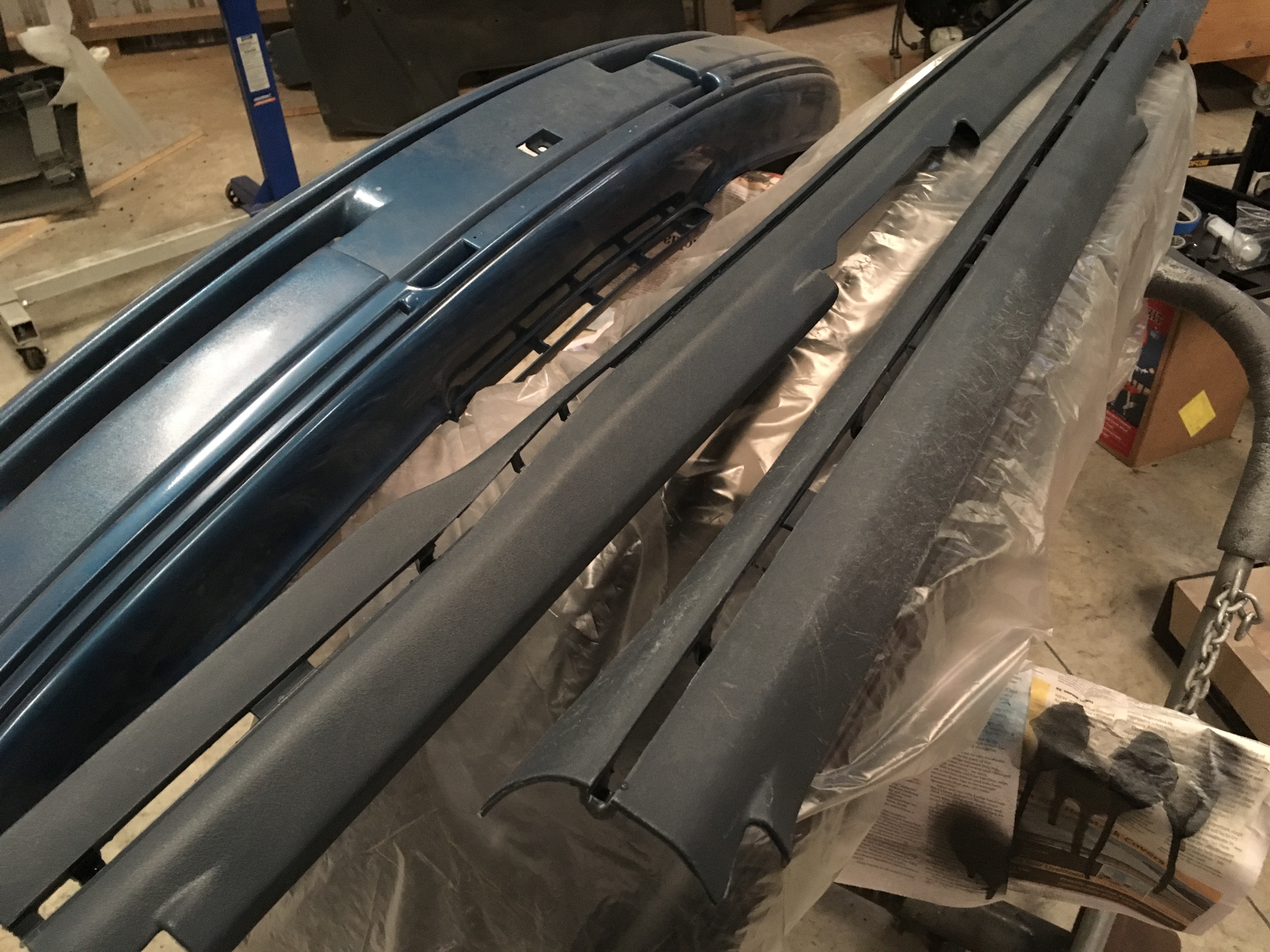

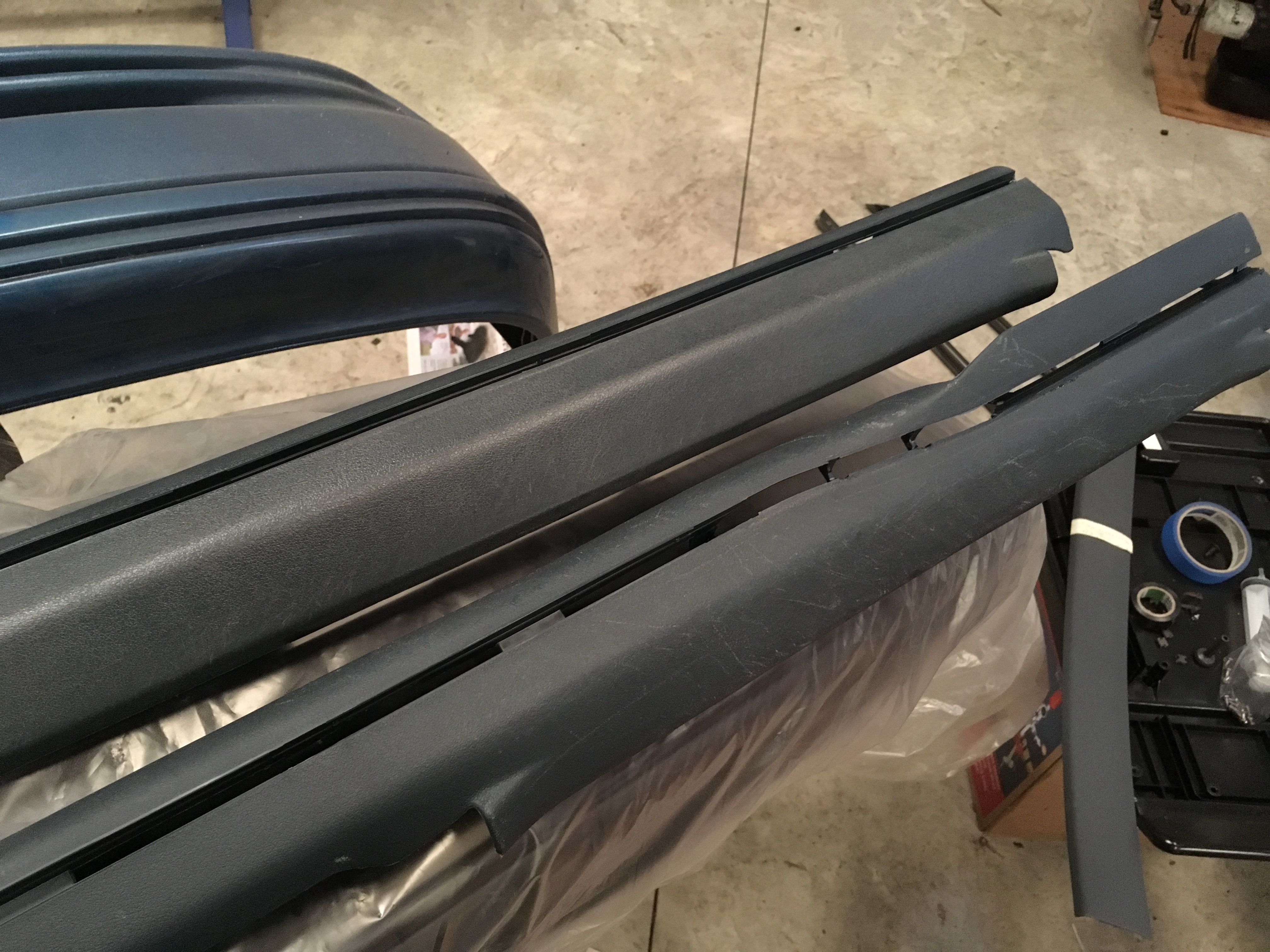

Not much to update. Though bumpers and plastic stuff is being prep'd for painting so I should have some bits back by next week or so.
Bonnet catch and lock, rubber seals etc...

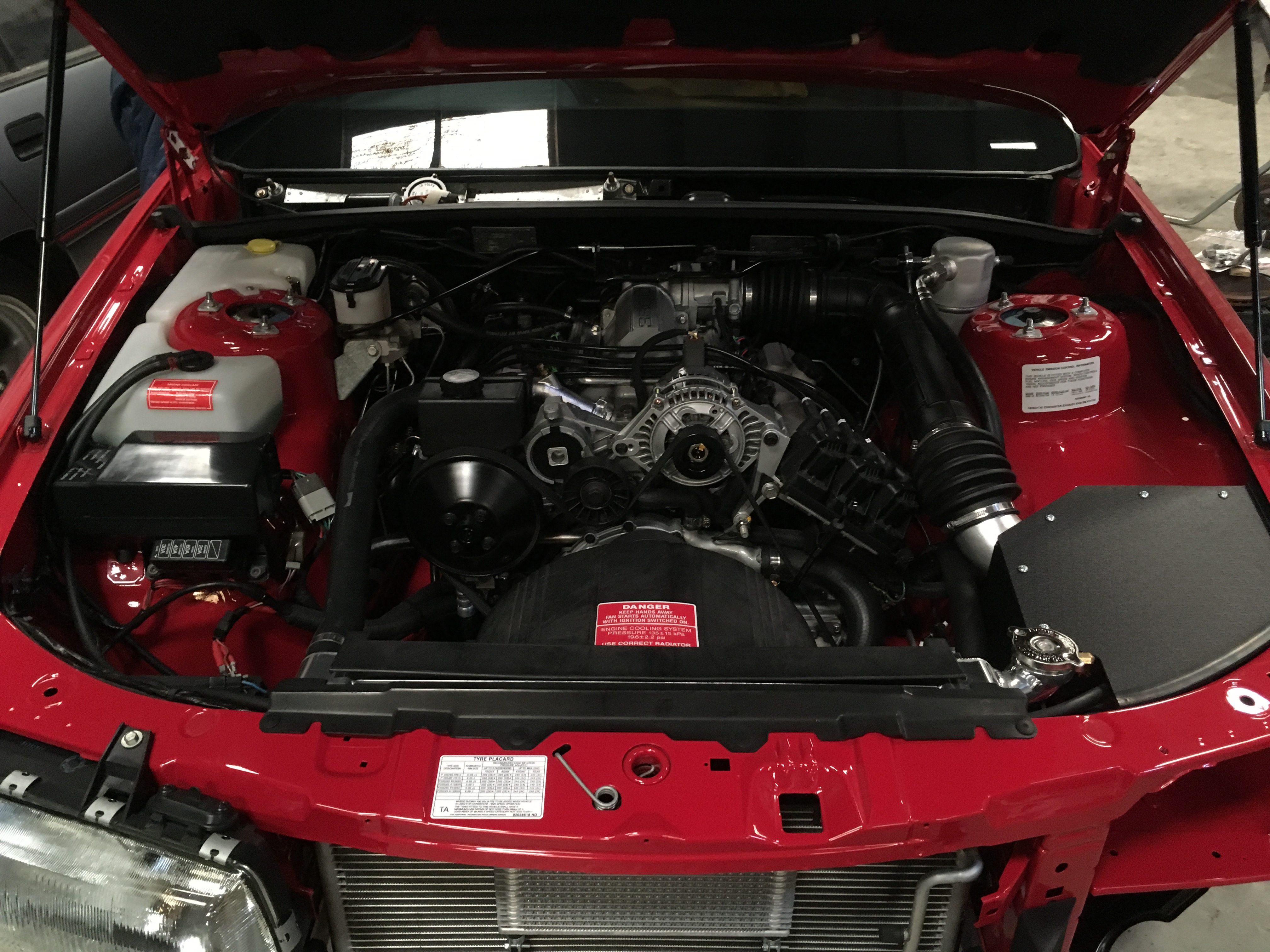

Decals for the engine bay done. Although I would like an R12 refrigerant decal for the dryer. Not available but stick this decals do have it planned as a product.
I have added clear protective decal circles to the rubber bumper contact points on the rad support so the paint isn't worn through vibration. Can't even tell they are there at a glance and they work great.
Lots of sanding and scrubbing with a stiff brush and toothpaste to get the powdered old plastic off.
Later a flame treatment to remove any left over powdery plastic.
Final result.

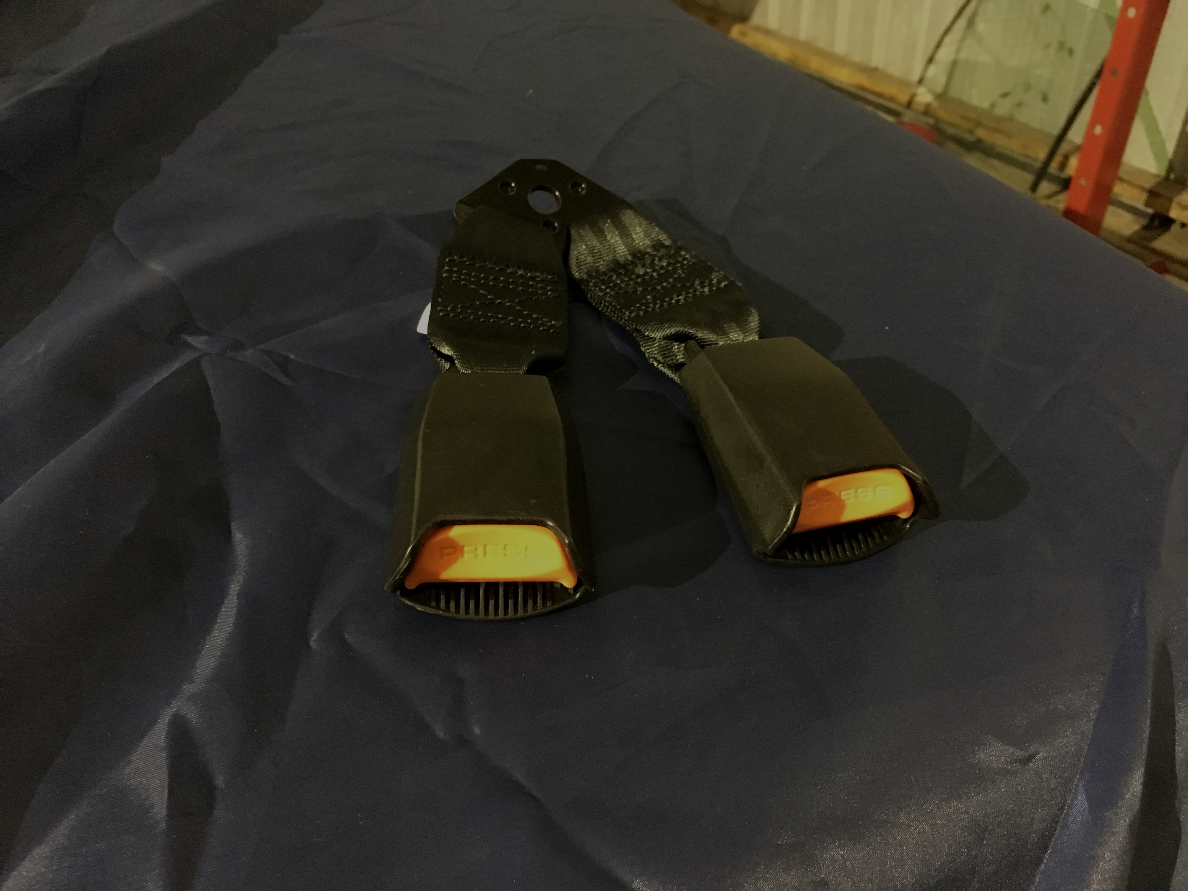

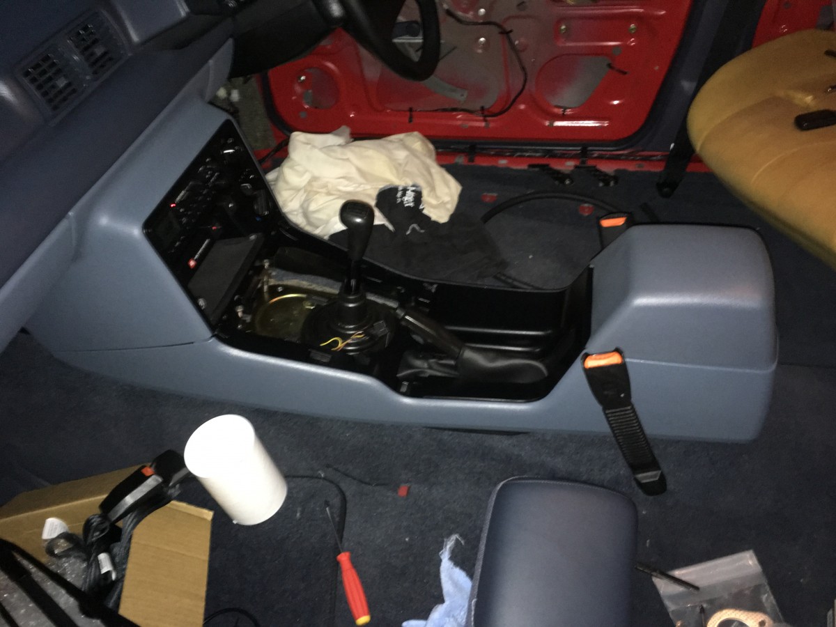

Finished the console. Installed most of the seat belts. That's all for now. Waiting game as always for the other stuff.

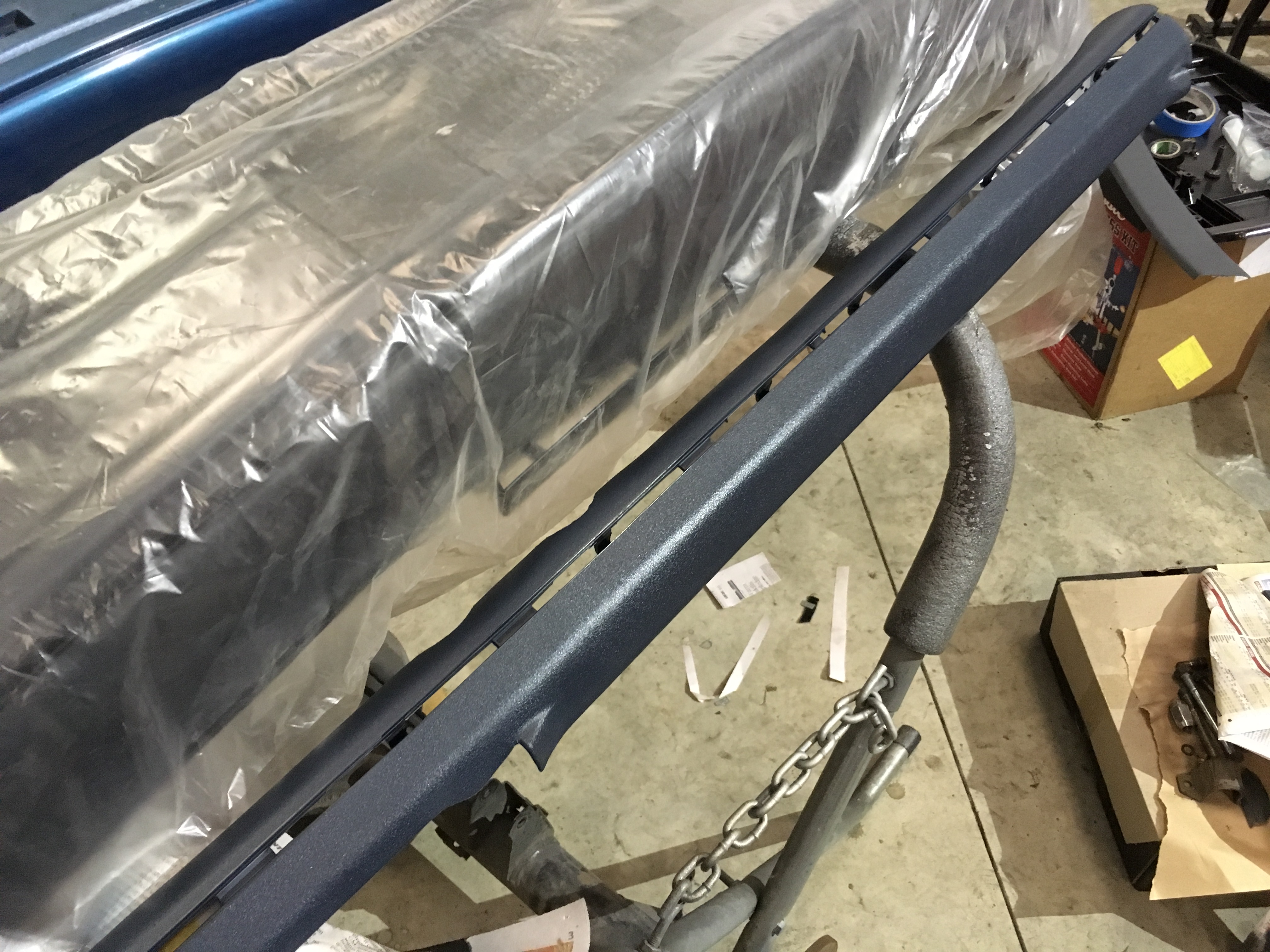

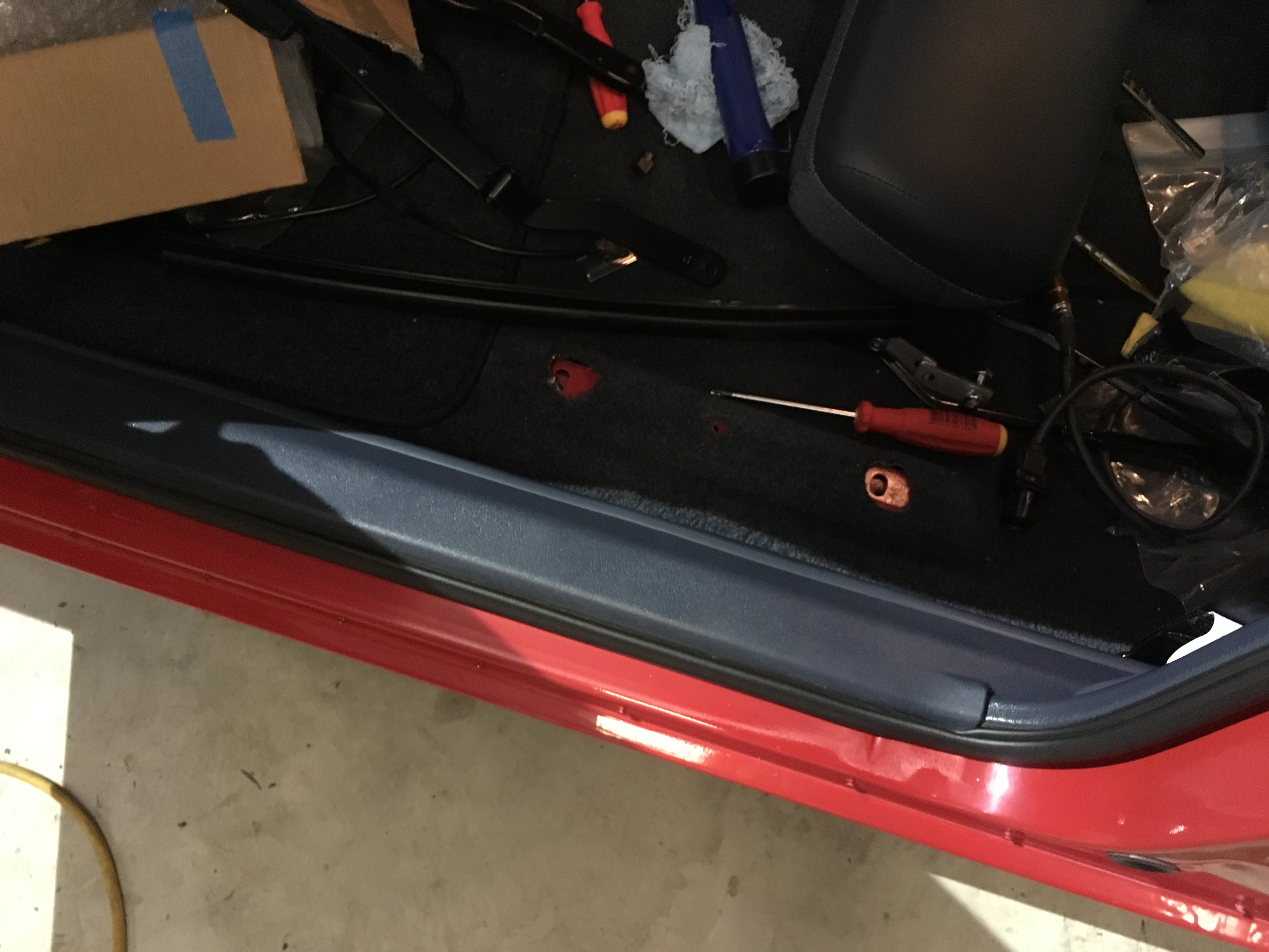

- Posts: 8123
Decided to do these today.
Cleaned them and then flame treated them to remove fuzz and scratches. Key is to heat with a propane torch until the surface shines up a little but not too much it ruins the leather texture.
Top is flame treated, bottom is only washed and dried.
Final treatment with some rem oil. You can use more appropriate products like armorall etc.. but I fine rem oil great for interior stuff not just on metals and guns where it's used normally. It doesn't feel oily but gives a clean satin shiny look which is why I use it.
Installed.
Installed.
So trying that got heaps of trims in mine that need a bit of attention but might grab a couple to test on first before flame thrower if my good trims
