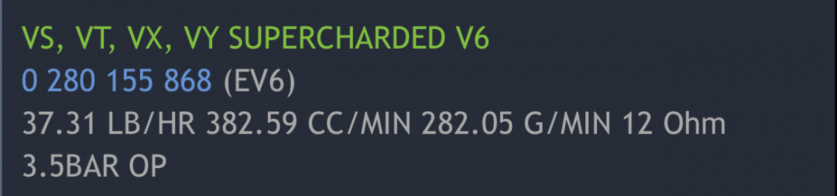

Re: Stock Holden Injectors and Ratings + Convertor
In regards to the 868 injectors is there a mistake there? The flow rating stated in this thread matches what Bosch stated they flow but according to Bosch they flow that at 3 bar where as the forum states 3.5, did the L67 perhaps only run 3 bar? I have 868 injectors in my VY V6 running e85 and had set my injector rate to 382.56 as that’s what was stated here in the forum however I believe they’ll likely be flowing higher now due to the N/A fuel pressure reg flowing at 3.5bar. Cheers
- Posts: 3823
- cars: VS,VT,VX,VE
L67 is definitely 3.5bar.
VK_3800
- Posts: 578
- Joined: Sun Jul 04, 2010 5:15 am
- cars: SS Torana
- Location: NZ
^ That is the normal operating pressure ("OP"). Flow ratings are generally given at 3 bar regardless for easier comparison, so yes they will likely flow a little more at normal OP.
I used Raceworks fuel pressure v flow rating calculator and found that at 3.5 bar they’ll be flowing 413cc, I’ll alter it in my tune and see how I go thanks fellas
